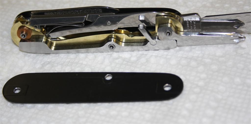

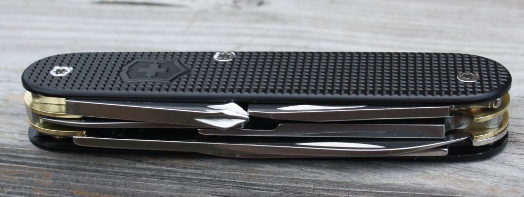

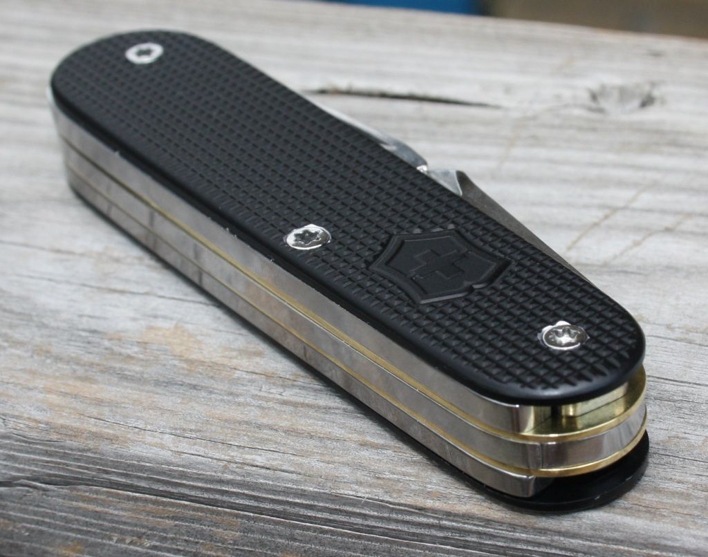

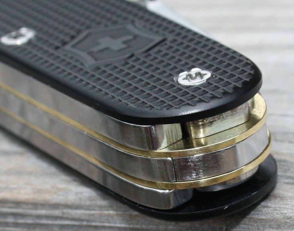

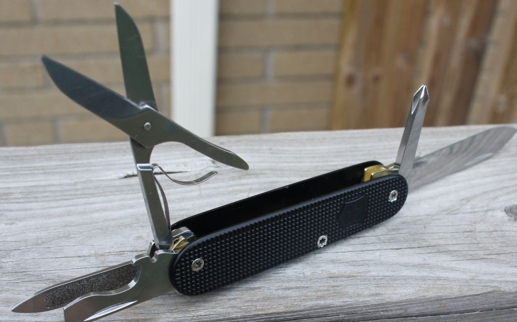

I think I could call this a mini super tinker pretty much. This is an alox cadet with hard anodized black scales and c260 cartridge brass liners.

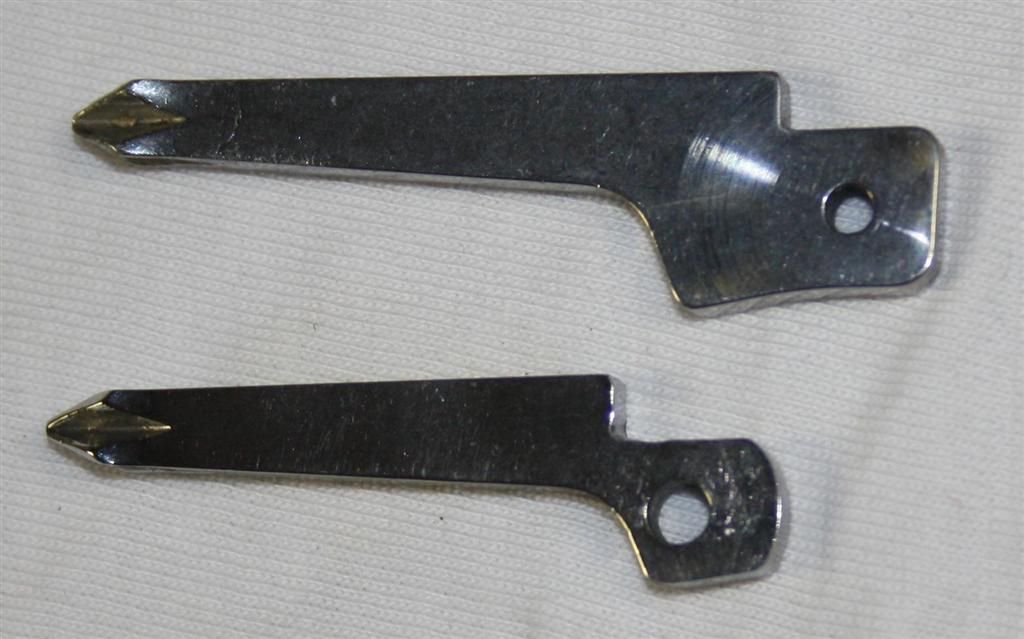

Getting the Philips on there was a royal pain. I had to add a custom rest for it, attached to the backspring itself. I made sort of a round dovetail joint and pressure fit it in. Lots of fiddly work but it works well at least.
I mostly only mod the bigger 93mm pioneer size, but this smaller size it growing on me, its a challenge to get the bigger tools on so you have to be creative. Next I want to see if I can get pliers on this small size frame.
Cheers
