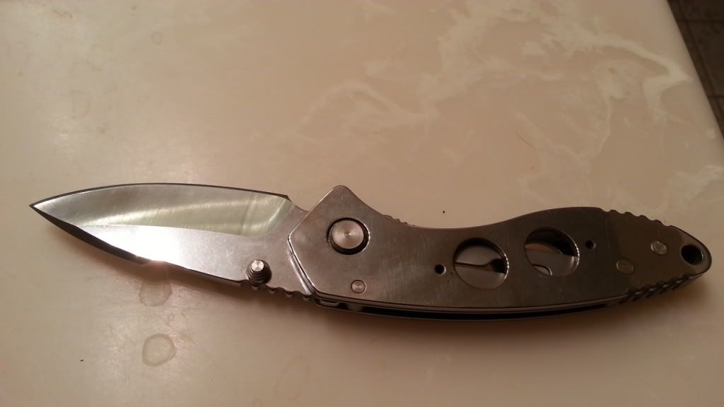

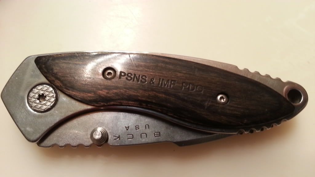

I got this 270 fishing on the bay, for a decent price :)
In the seller's photos it looked pretty good.
When it arrived it had gunk in the pivot, on the blade, in the handle etc...
Blade was less than smooth opening.
Also found some corrosion on the handle under the scales :(
Scales were pretty dull and a bit scratched.
The blade was pretty dull, but was also unsharpened....
Perfect candidate to send to Buck for the spa treatment, but I chose another route....
I figured I would clean her up myself and use the heck out of her :)
Doused her with oil and started cleaning off the gunk.
Took her scales off and blade out.
Polished up the pivot parts with steel wool.
Cleaned the heck out of the inside of the handle and liner lock.
Polished the outside of the handle with the buffing wheel. (removed the corrosion :) )
Polished the scales with the buffing wheel.
Put her back together.
Cleaned the blade with the buffing wheel (got rid of all the super stuck on gunk and some scratches)
And last of all, sharpened her up to hair shaving status.
Now she looks good enough to maybe make some nicer scales for her (which was my original intention when I bid on it)

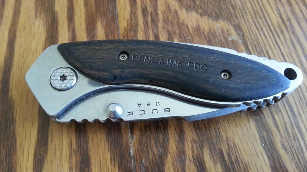

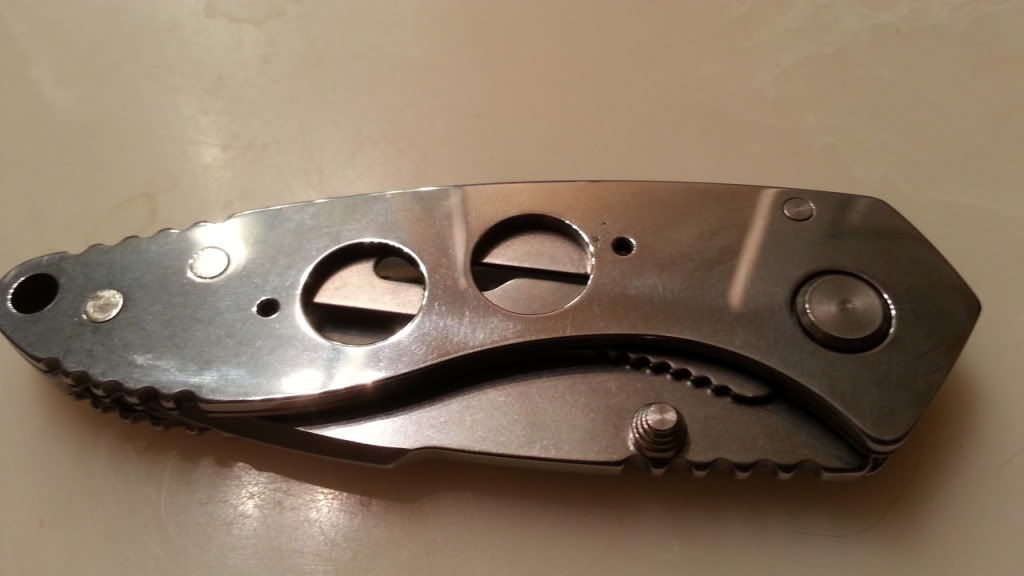

Before serious cleaning effort, but after I had done some light initial cleaning.

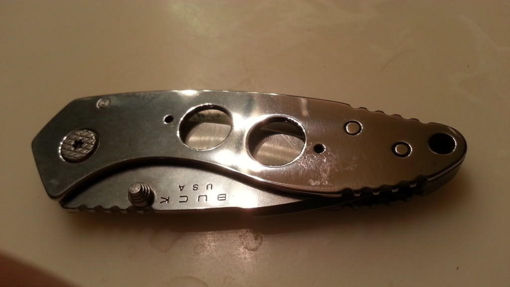

After Buffing wheel etc...
Corrosion gone but close up shows where it was, under the scales...

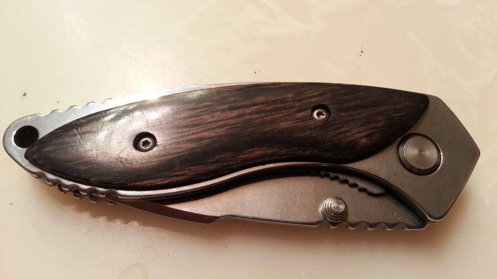

All Done and prettied back up :)
Next will be new scales, when i figure out what material to use.

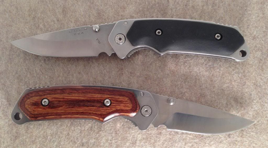

I have a 2013 S30V with rosewood one too, and I quite like it :)
Also just won another one fishing on the bay... that one has 154CM and rosewood. I look forward to it's arrival.
I find myself carrying this model and the Alpha Folder quite a bit.
Darn good designs.
I think they would be even better with micarta, buffalo horn, or stag ;)

The sisal buff with grey compound is the work-horse and removes scratches. The 'sewn' cotton wheel with green compound is for polishing. Then a loose, cotton, layered wheel with pink compound is for a final mirror polish. Your welcome. The Buck Collectors Club offered a limited edition 270 Durado with Buffalo horn and a polished blade of 154-cm steel. I believe that was in 2006. A very handsome package. DM
