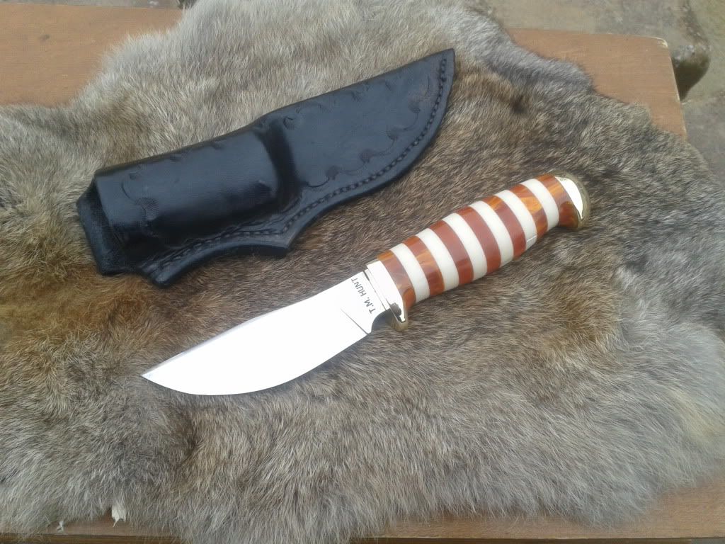

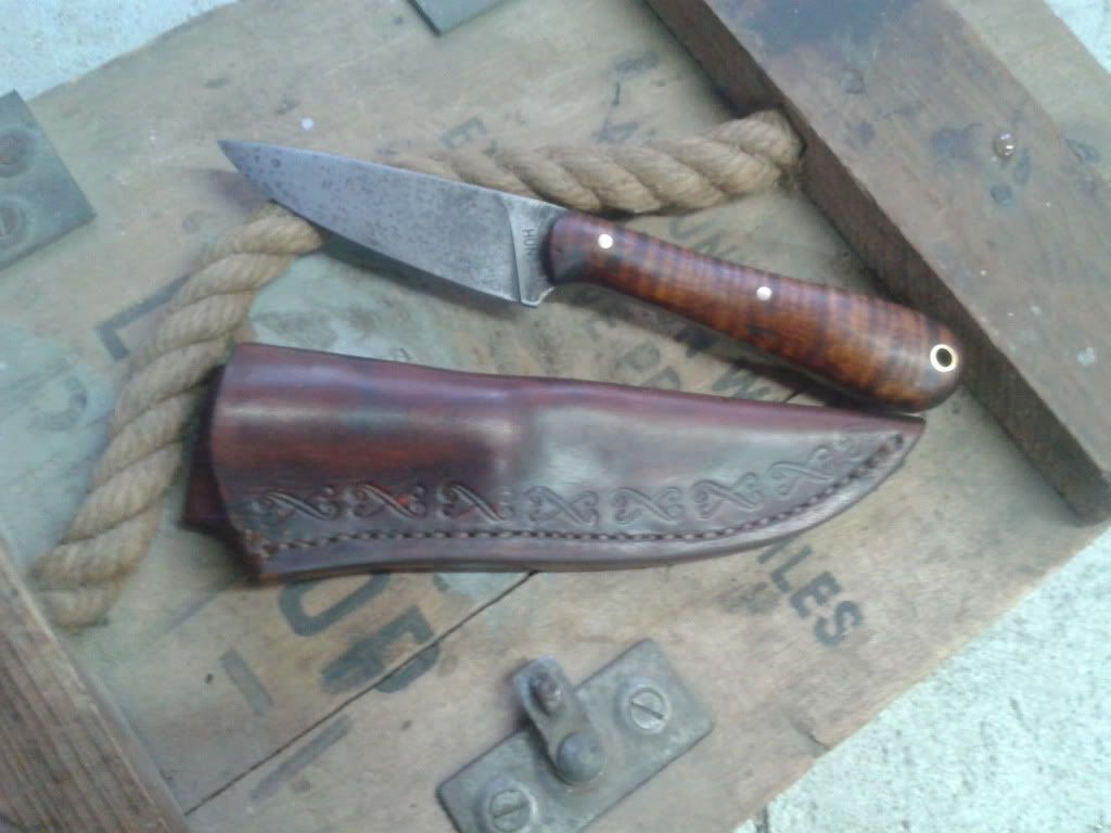

Some more of TMHunt's work
Thank you all for your helpfull info. I didn't know a lot of that. And sleepy badger for the pics. Yes those are my knives and sheaths and as I mentioned in my earlier post I have made some good ones and those are some of them. What you don't see are the ones at my shop that would so disgrace the good people of blade forums that they would probably revoke my membership! However, at the risk of sabotaging my knife career I will try to post them tomarrow or Sunday as I am away from the shop tonight. And one more quesion while I'm at it. What is a good supplier of leather and leather tools?
