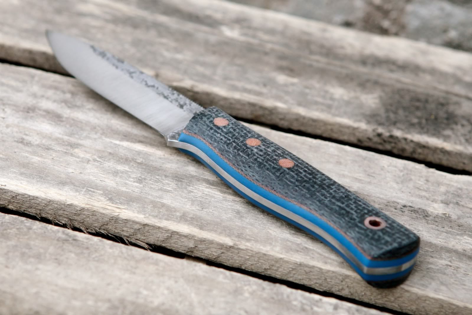

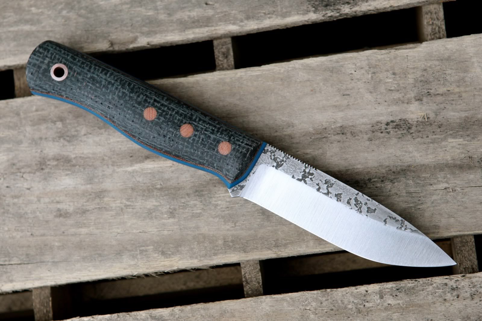

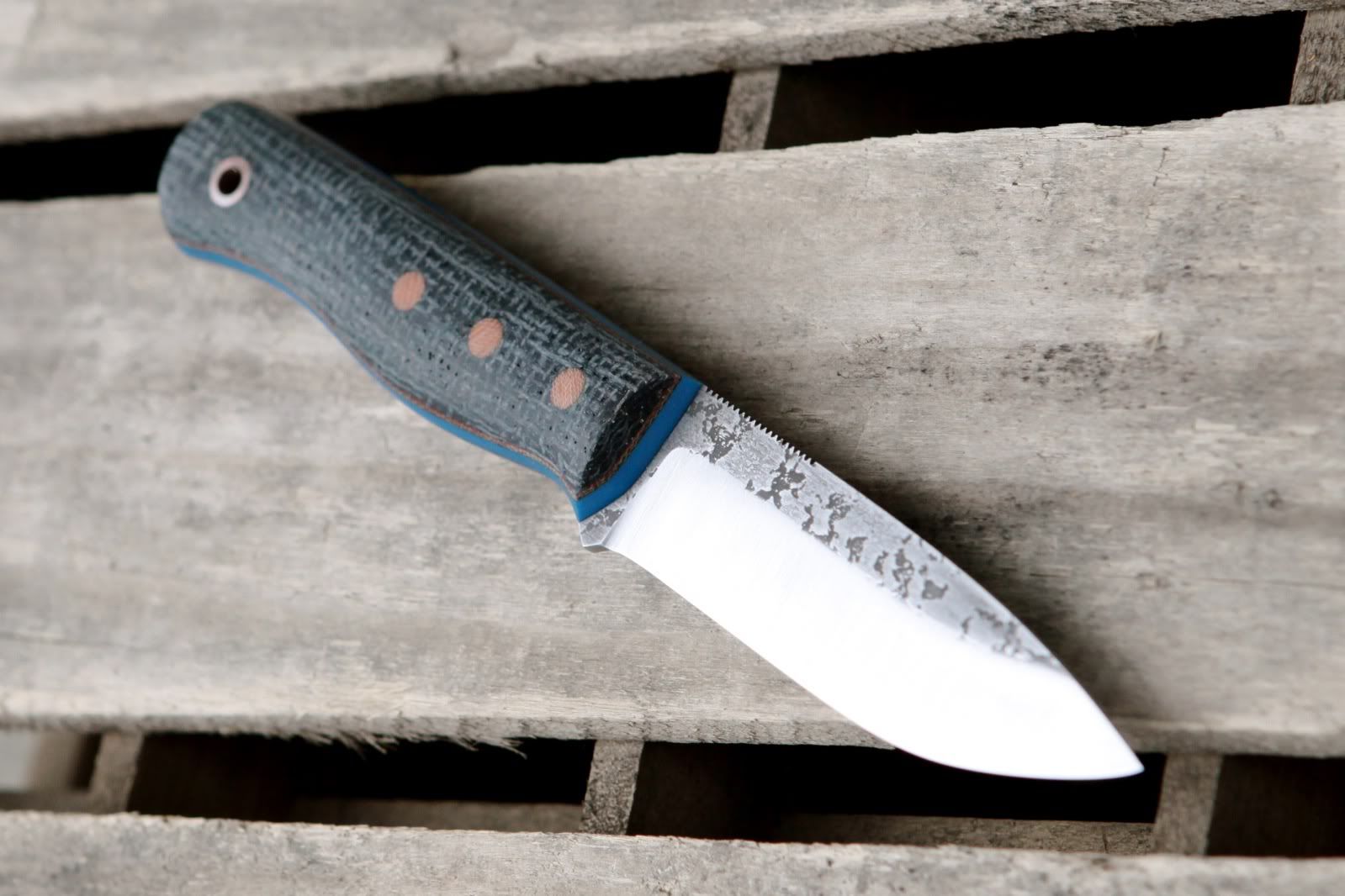

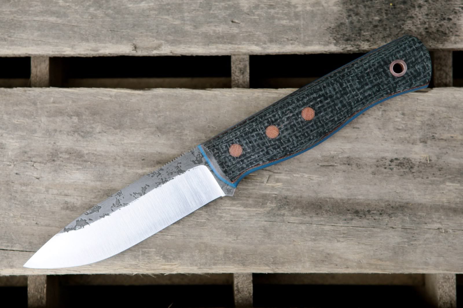

Here is a new model I finished up. It is a straight handled bushcraft knife with a narrower blade. Here are the specs on this particular knife.
Handles - Shadetree Black Burlap over Natural Canvas and Blue G-10 with Natural Pins and Copper Lanyard Tube.
OAL - 8.5"
Blade Length - 4"
Blade Thickness - .122"
Blade Steel - O1 @ 58-59 RC
Any comments or suggestions are welcome. Thanks!
Can't wait to get it. I love the copper hardware and especially love the sheath.
liking the blade , looks very nice combo , i didnt know you could get those thick spacers ,,looks great
I've even used 1/8" material for spacers, those seem to be at .093 or thereabouts...
Jared do you find the black shadetree burlap a little harder to work with or is it just me?? for me its hard to bring out the look for some reason, I don't know...
but as far as suggestions your knives always look great so I think any suggestion is a matter of preference and for me I would've used black thread to tie it together, but the contrast still looks good as is..
Loving your stuff bro! I hope you make some more models with copper pins, I'll have to pick one up!
Thanks everyone!

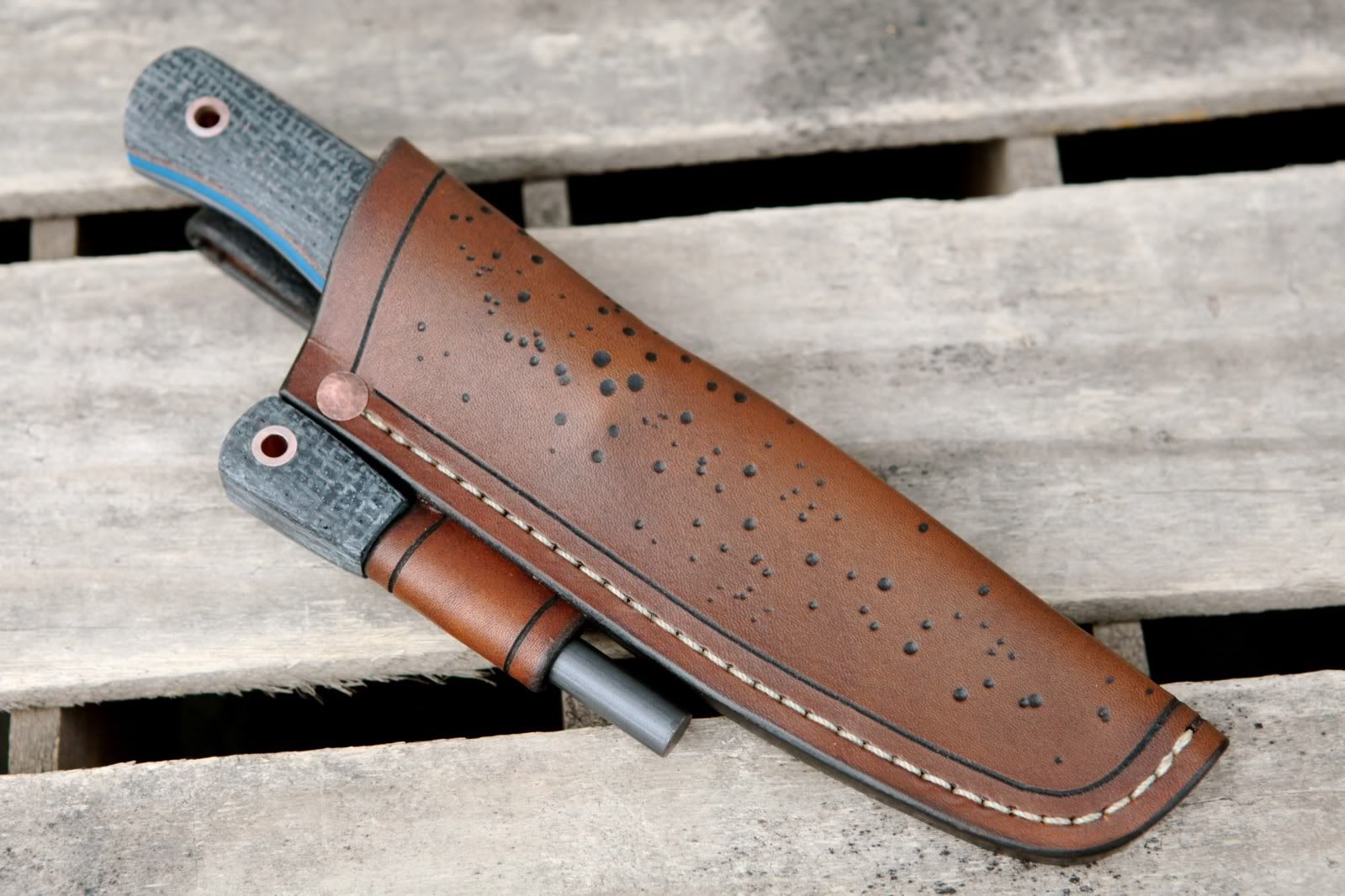

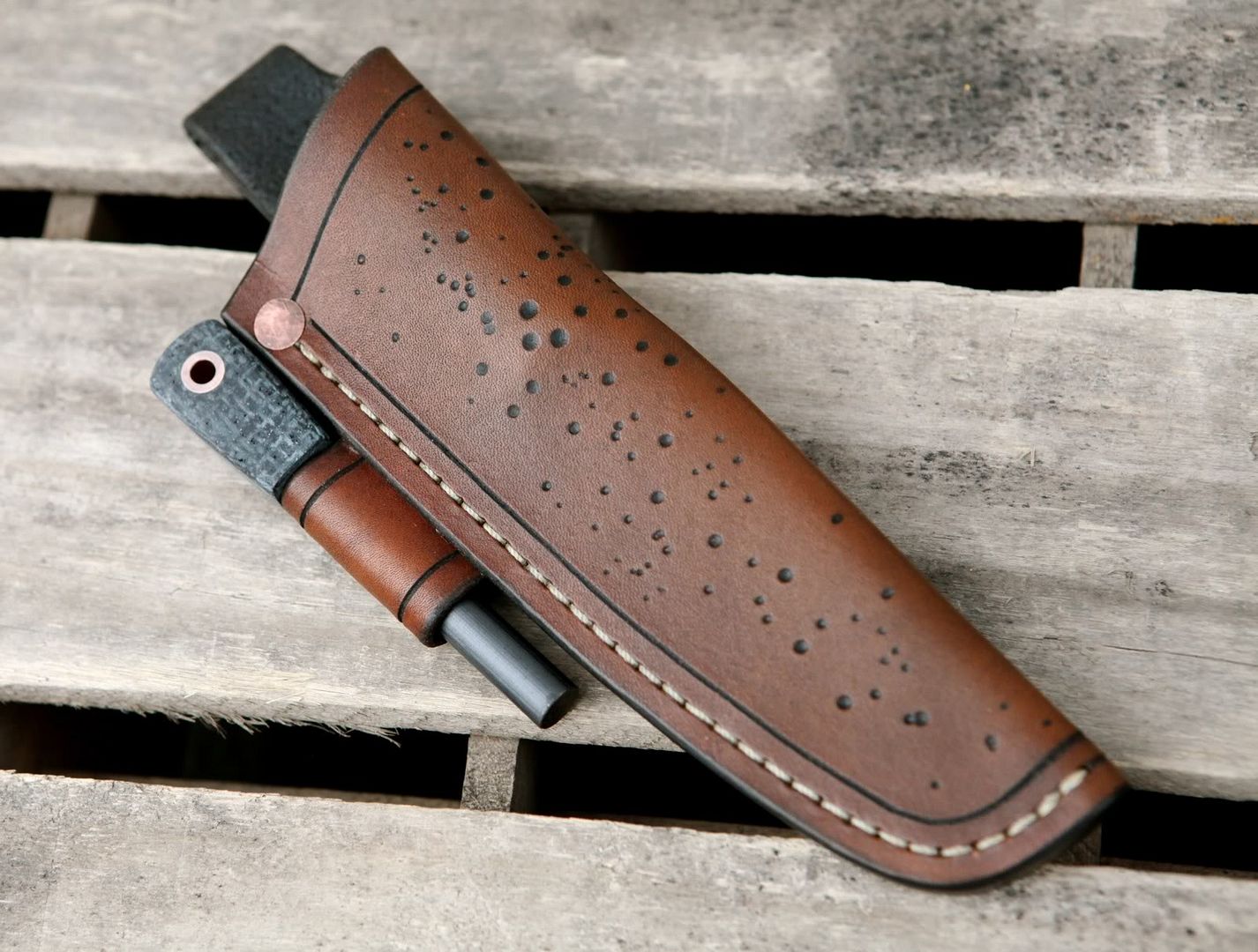

Rob, the black burlap has been fine to work with. One thing I did on this to help was sand it down and polish it with scotchbrite pads. Then I let it soak in mineral oil for a while and polished it with a white scotchbrite. Then I took it to the sink and washed it with some dawn. That helped the burlap pop again. Also the blue liners are 1/8". And I almost used black thread on the sheath. I'm still not sure how black would have looked. Maybe on the next one.:)
