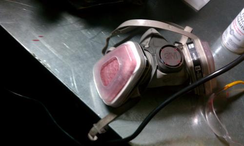

I've just ordered my stuff, and included some toxic green G10 liners. I couldn't really resist. :rolleyes: Now though, I'm stuck with the question of how do I shape the G10 safely. If I'm just sawing the G10, is it still harmful? And if I sand underwater, or wet sand, is the glass still released into the air? Or would a respirator be a better idea? And if I do get a respirator, what do I need? I'm just going to be working with sandpaper and a saw, and I don't think I'll release any fumes, but I really have no idea. Oh, and is Micarta in the same boat as G10?
ANY sanding dust is in the same boat IMO... at minimum wear a dust mask and work outside.. keeping it wet will minimize any fibers being released into the air... respirators aren't cheap, but is relative to how much value you place on your lungs, so they're mandatory working inside..
You have 2 contaminants to deal with, particulate and gaseous. If it's warm out use the best respirator filtration for dusts you can find and ventilate thoroughly. If you are in an enclosed area combine this with activated carbon filters.... at work we use P100 but it leaves us vulnerable to the exhaust from the diesels and two strokes, but it's hard to find anything that protects from everything!
Even if you work wet, the stuff eventually dries and will fly up when agitated like when you move or clean. Make sure your vac exhausts away from your work area.
Micarta has less dangerous fiber particulate but as dangerous fumes... but if you are hand working it's the fibers you need to worry more about.
Like BCK said avoid inhaling all dusts but glass is persistent. I find CF to be worse as it floats around forever...
Just remember, the dust from G10 is quite harmful. A dust mask will stop the larger less harmful stuff. A good respirator with a P100 filter will stop the more dangerous ultra fine dust that you can't even see.
Be aware that it is also on your clothes and in your hair, so you'll want to launder your cloths before playing with the kids and wash your hair before going to bed etc...
AND.... the mask stays on until you leave the shop..... don't sweep/dry wipe your equipment off either. A shop-vac and damp cloth are the way to go. Don't mess with your lungs!

For someone starting out, what half-face respirator would you recommend?
Would this 3m p95 work? $28.00
P100 filters are better
The difference between p95 and p100 is the particle size - P100 catches the finer ones.
That mask you show is medium
There are 3 sizes
It is best to go to a safety supplier and have them fit you.

The minimum I would consider are the 3M 7500 and North 7700 silicone half masks with a P100 Filter.
Use a VOC & P100 combo cartridge for protection against acetone and solvents.
There are also prefilters that snap over the main filter for longer life.
For beards, pick one of these
