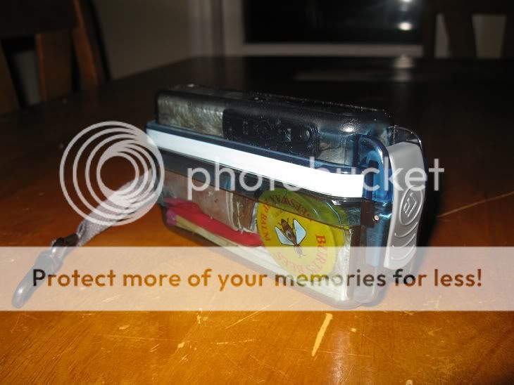

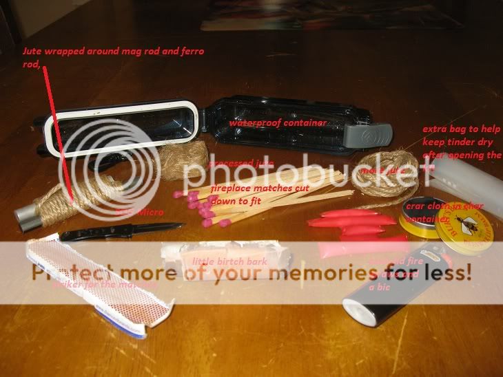

Here is a fairly recent pic of my altoids-sized fire kit... though I gave up on the candles and usually also pocket a small blade and lighter. the waterproofish match box rides in another part of my kit, but is with me. The magnesium/tiny firesteel combo comes in handy in the damp, but I prefer the larger one for general purpose firestarting.
just some food for thought. hope it's helpful
edit:
I know a lot of folks that swear by fire straws. Haven't got around to trying them myself, but I hear nothing but good things.
