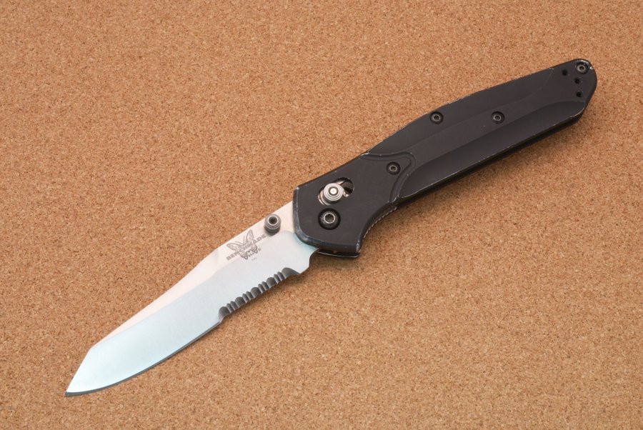

Done correctly, I like it. Here is an old aluminum handled Benchmade 940 that I carried quite often for around 8 years or so:
The finish did wear off in a few places and I did get some dings but overall I still really like it. It is light, strong, and can take a nice shape. I recently had a new plain edge blade put in this guy and still carry it all the time.
