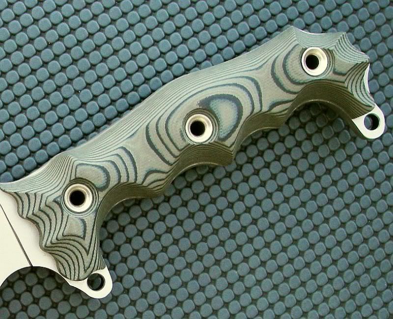

As long as you don't make physical contact between your Busse blade and the abrasive belt you should be fine. . . .
If you do make contact. . . .this can happen!!!!!! :eek: :eek: :eek:
Of course, there was a lot of alcohol mixed in with this nightmare. . . but you get the idea. . . .
Don't Drink and Grind!!!! :eek:

That thing looks like it could hurt someone. :eek:
Is it a glimpse of what will be available in Easton????:foot:

that is but ugly.a great testament against GWI.
The nuclear seahorse is the only knife i've ever seen that was uglier than the sus scrofa. :barf:
Scrota is still uglier than the Rex. Now the SAR5, that's a GOOD looking knife, right Jerry??? :D
