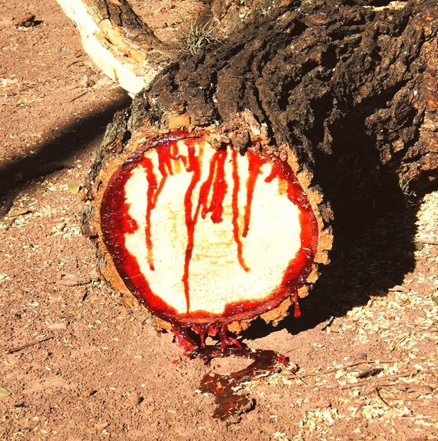

FYI - the African variety is commonly called bloodwood because of its dark red sap.
