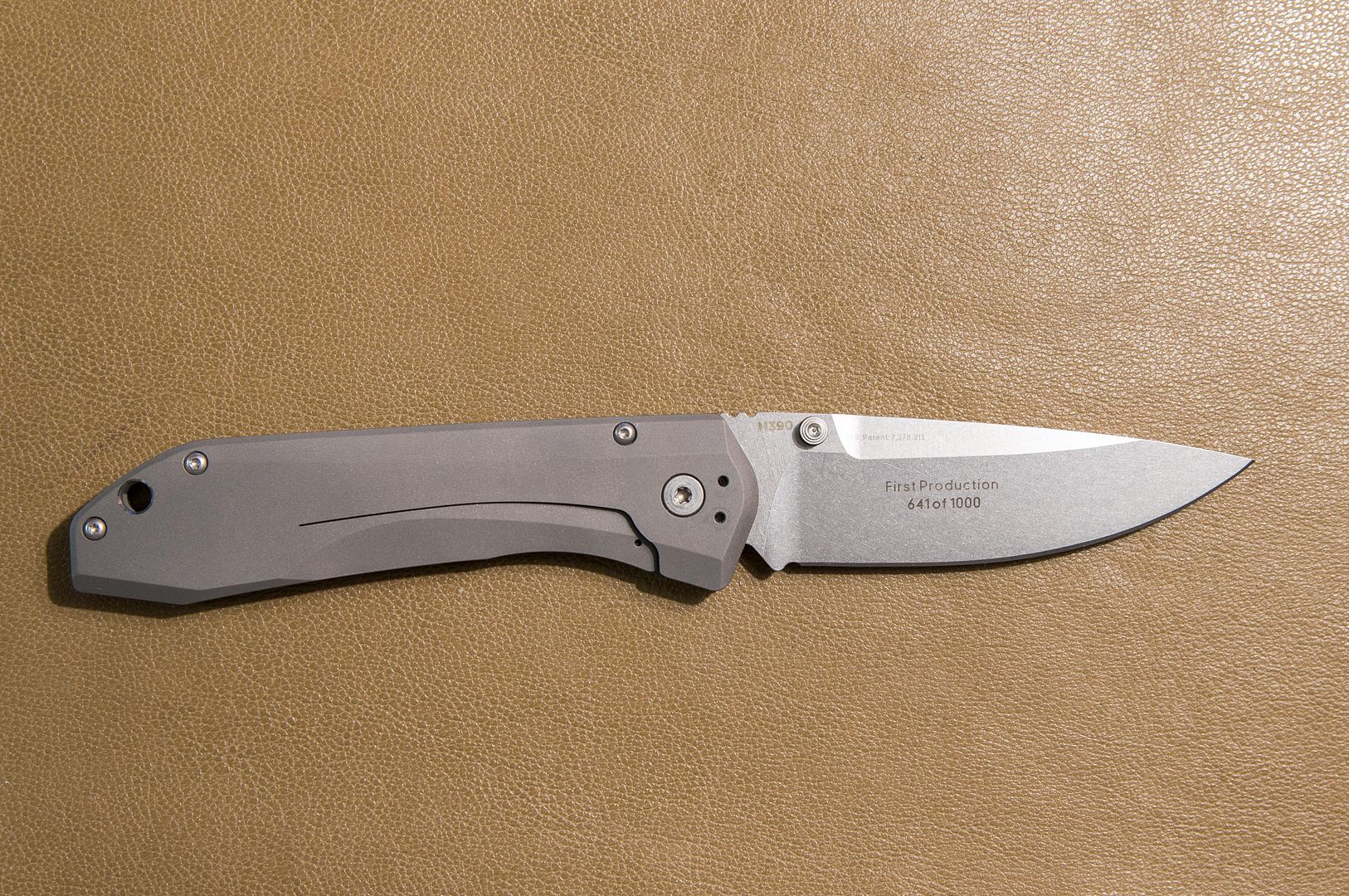

Some folks have expressed their disappointment in the new Benchmade 761 because is only has a RH thumb stud. I also wanted to have ambidextrous thumb studs, so I called Benchmade and they sent me ambidextrous thumb studs that fit perfectly on the 761.

I too did it with the subrosa.Glad you posted this, I was disappointed when I saw this model came out with single stud. wasn't sure if there was enough clearance for the stud on the lock side. if you re install the clip does it get in the way at all ?
If you're referring to my post, there's neither an issue with the clip or replacement stock studs. There's just enough room on the lock side.

I contacted BM and was told that they don't have one that spans the countersunk area where the RH only stud is attached by the screw.
nickites
Unfortunately there was no documentation that came with the studs.
The woman at Benchmade that I spoke to told me that she would ask the people who actually worked on the knives. She left the phone and when she came back she told me that they had something that would work.
My only suggestion is that you call again and tell them that other folks have gotten studs that work perfectly, and possibly describe the studs as depicted in my pictures at the start of the thread. Push back on them a little as the info you received is clearly incorrect.

One additional comment. The studs that I have on my 761 do not completely cover the countersink where the RH stud was attached by the screw. But it covers all but the last .003-.005 of the countersink. It is very difficult to see that the stud does not cover it completely. I doubt anyone would notice unless it was pointed out to them.
rummels
Thanks for all the help rummels.
Does the stud stay in place? BM said it would shift around because of the countersink.
The studs are rock solid.
The stud that is on the side with the cone-shaped countersink (the LH stud) centered itself in the countersink without any effort on my part.
There is about a .012 inch difference between the height the ends of the studs are from the surface of the blade because the LH stud sits slightly inside the countersink. But I can't image anyone noticing this with the naked eye.
rummels
Griptilian studs are what you want if anyone else is wondering about doing this. They fit perfectly and have better grip than the original single stud.
