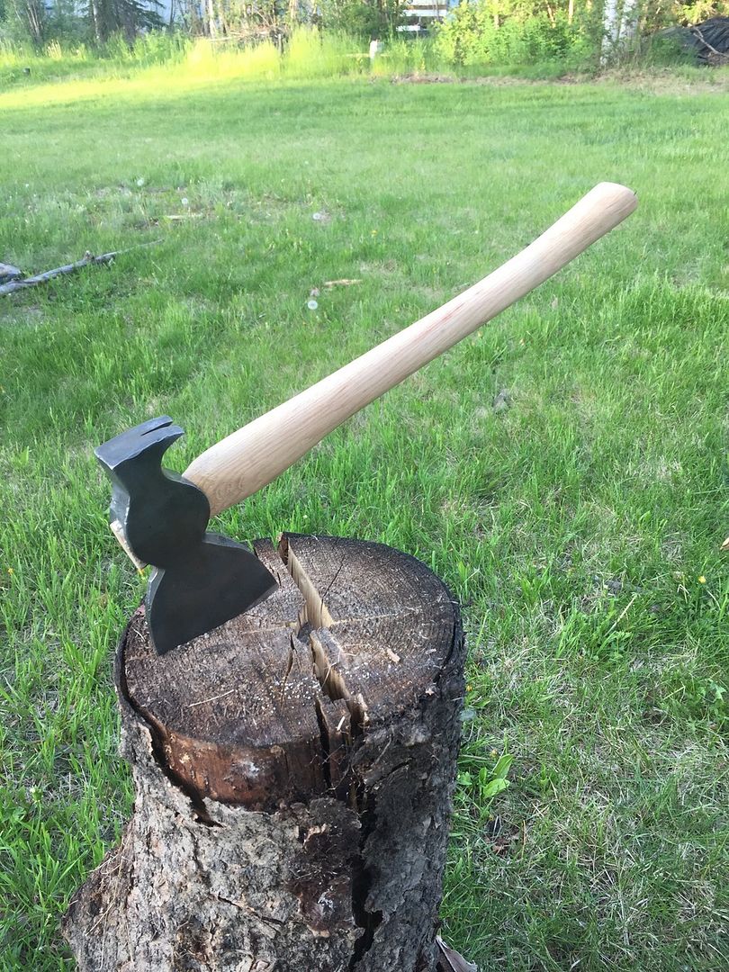

So i got this American Axe (roofing hatchet???) head the other day...
...and I got a hold of a handle for what i think was a normal hatchet.

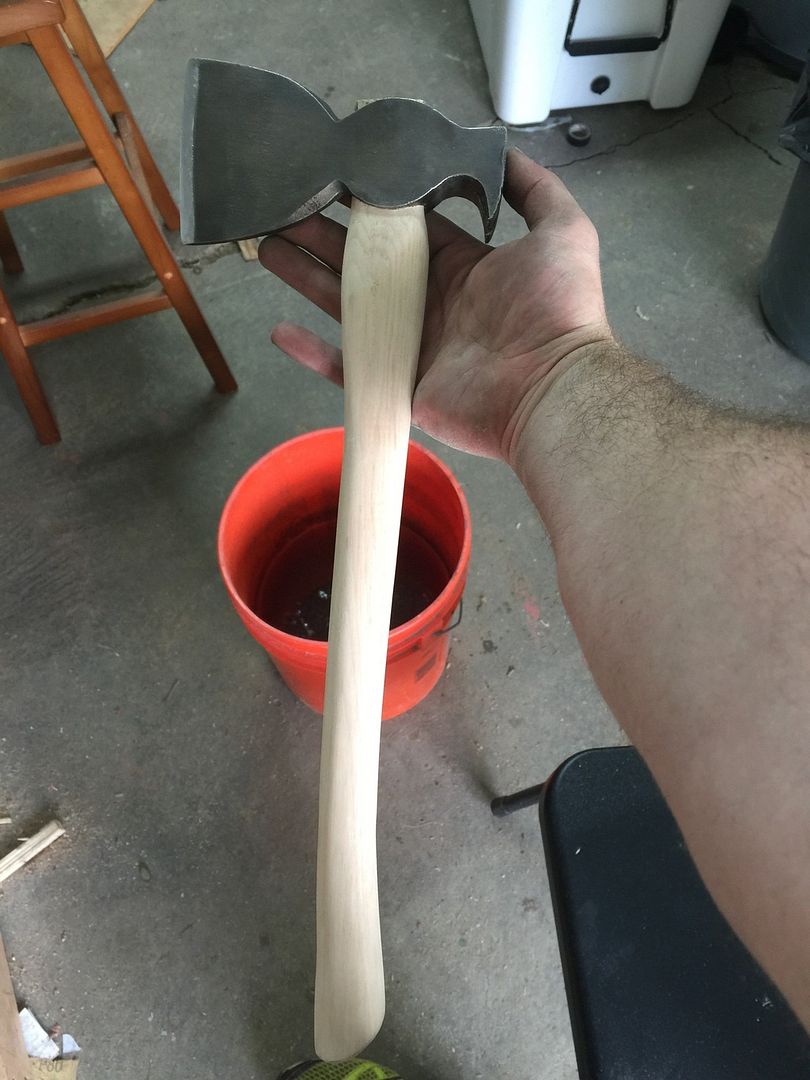

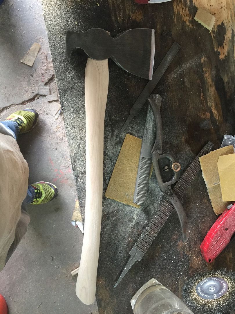

The handle had a piece missing off the belly of the curve so I was able to get it for free. When I got home i hit the sander...wasn't going to go that crazy with it, but when I tried to fit the head I realized my axe head should be on a straight handle and it was now curving the wrong way. Instead of trash the idea I went ahead and took it back to the sander and did my best to shape it into something a little more usable.
It's not perfect, but it was a free handle with straight grain....and it was allot of fun.
You make some nice lemonade.

Looks to me like it'll work just fine. Yours wouldn't be the first reward (edit: REARWARD) curving handle on Earth.
Looks to me like it'll work just fine. Yours wouldn't be the first reward curving handle on Earth.
True COTS. If you are going to pound something I guess it's facing forward.
Just noticed what you did to throat/belly. Your hand lays straight and you can use it choked up for cutting- maybe won't feel the rearward sweep?
It's in nice shape and you put a good edge on it. You made the right choice straightening that handle.
