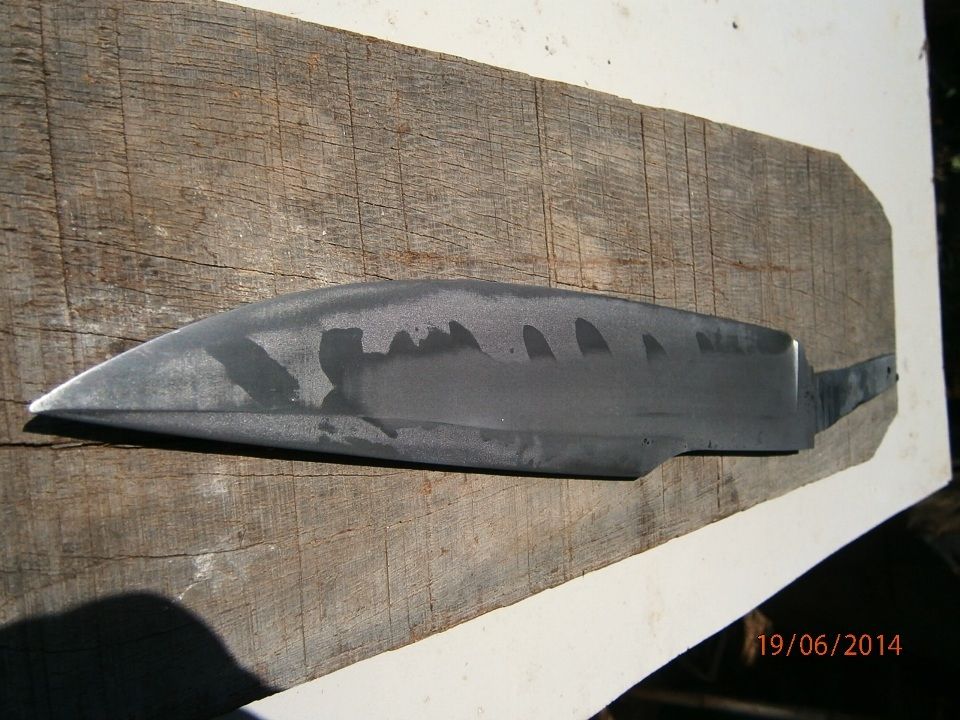

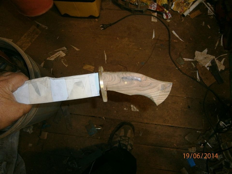

after finishing grinding and polishing i decide to try for differential hardening and hamon if possible, first i cover the tottal blade with a very thin clay layer
after drying i decide to improvise a bit
holly crap!!!!! i allmost forgot to take the pic with the last clay layer on it!!! as we say late is better to never!!!
right after heat treat, did you see the funy face on the clay?

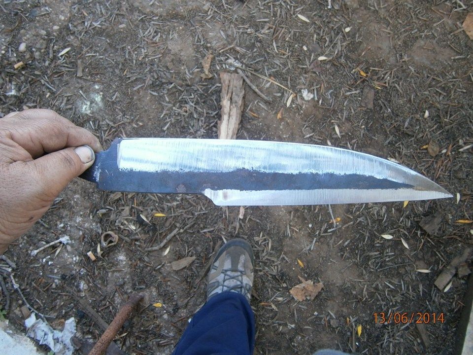

blade all cleaned up and polish ready for the acid etch, pheric chloride
and now let the fun begin!, look how she come out from the echant!!!!
and after some circles of etch and polish!!!! holy smoke!!!!

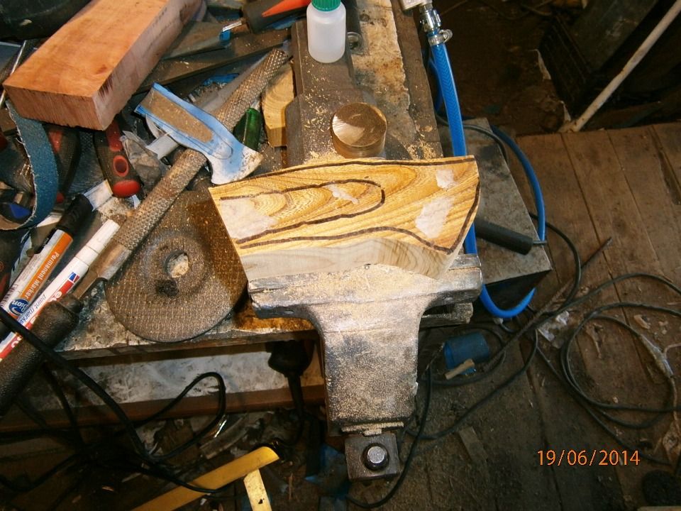

after thatis time for the handle making, the guard first,phosphor bronze
i'm going to use a block of judas tree, that i collected my own!
start shaping
handle ready, stunning beauty!!

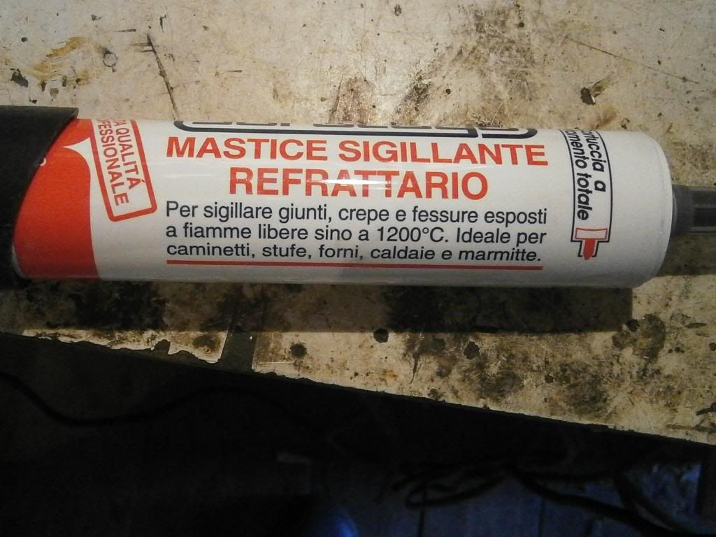

Knife build. What type of clay did you use and where do you buy it?. Very nice knife very very nice piece of wood
thanx pal, i'm happy you like it.
well for clays i use this, it's a resin for stove and forge repairs, i buy it here in greece from local store, but I must mention that not using it as it comes out of the cartridge because it is too thick, dilute with a little water until i get the density I want, in this specific BLADE I've used three different densities, from sparse to the first complete cover the blade, until thick enough to last layer

You'll find that if you are after a lot of activity in a hamon, you'll get the best results with a simple, shallow hardening steel. The jagged lines that can be seen on your blade are actually a result of super heavy etching... the actual transition (hamon) is the area above that. I'm trying to help, not pick on you. :)
You will also want to use MUCH LESS clay. :)
thanx for the comment mister wheeler, no way to misunderstood!!,just to tell, i now that the monosteels are most efficient to create hamons,to be honest this blade is pure product of experimentation, and I hope you understand that what is happens thereon BLADE is due to Clay and not in some sly trick, now to reach this result is true that I did several cycles of etching and polishing,if this is called super heavy etch then yes, this is it!, allso thanks for the advise for less Clay, i will certainly implement on some of the next blades. I left last the most important, and because I like to attach to Caesar what belong to Caesar's and what belong to God to the God, I must admit that your knives be my inspiration for this knife!! i'm watching your work and i'm a fan!! will not flatter you by saying this, but this is the truth! and thanx again for your time and the tip!!

Sorry, I didn't think, or mean to say that you were lying! :foot: I was just trying to help you better understand what you had going on in your steel. :)
I should have included this in my first post... I outlined where the structural transition is in your blade in this photo. You certainly did achieve differential hardening. :cool:
Hope that clears up what I meant to say harkilis :) Keep up the great work! :thumbup:
The red line is just inside of the transition. :)

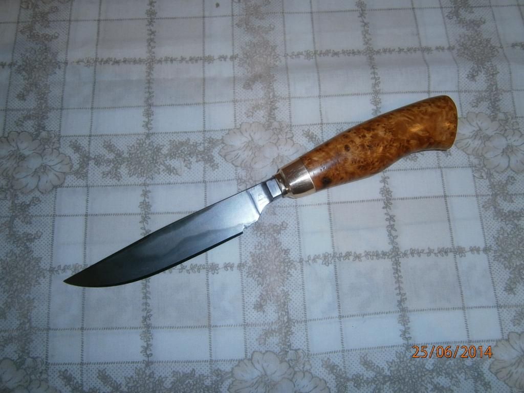

thanx tad, i have allready work with some 1095, have some nice hamons,but mostly plain lines like this.
or this, this is some earlier work
but what hapend with the fighter blade i saw first time on my blades!, after a lot of thought i'm going to believe that hapens begouse of the different densitys of the clays, but i can't be sure, instead i'm sure that plenty of bladesmiths in this forum as more experienced than me, known better!!!
