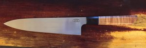

This isn't a kitchen knife, but it sure was a ragged oak scrap that turned out nice. This was an iffy piece of wood, but I filled the little gaps with superglue, and they sanded out smooth:

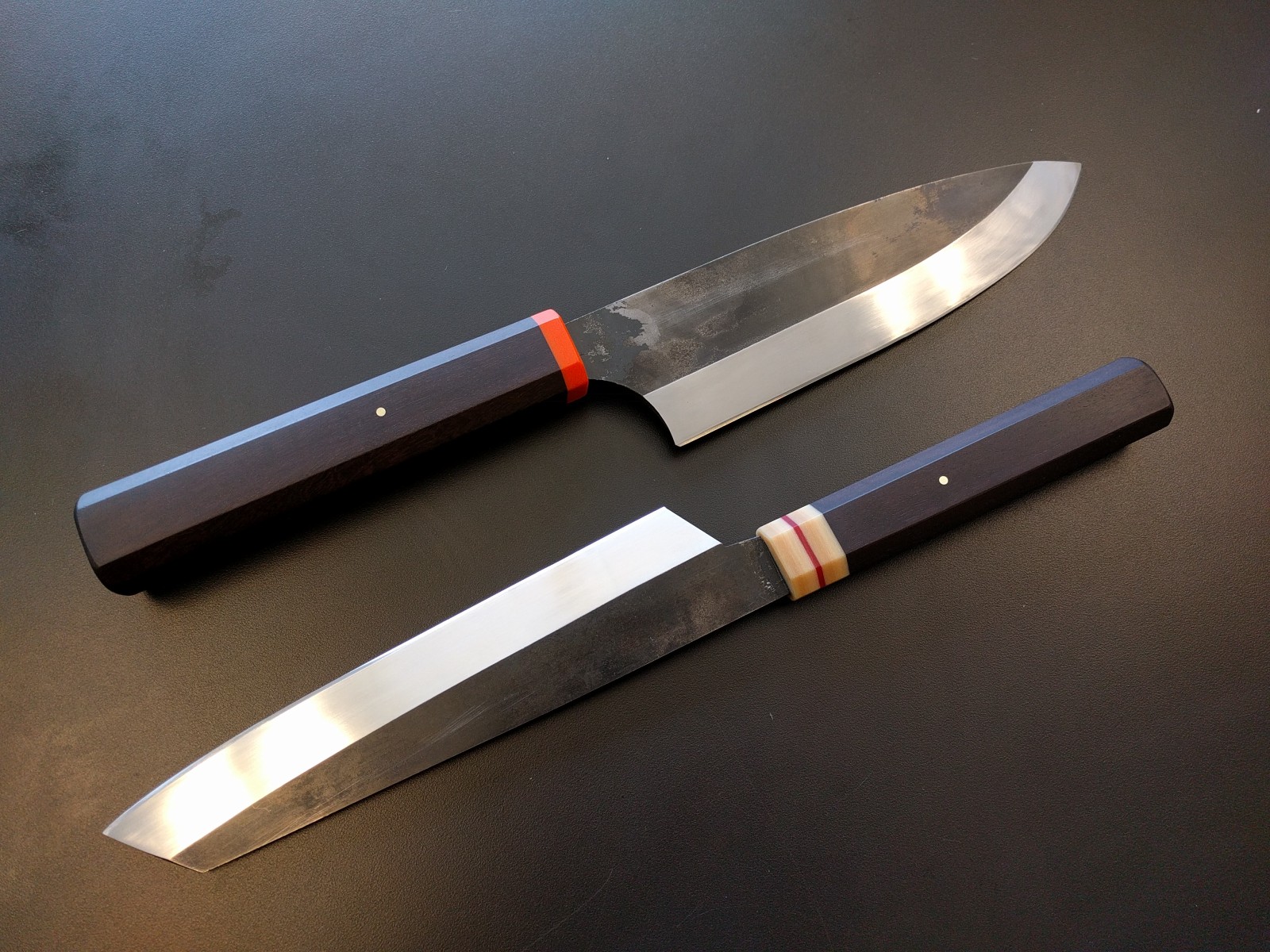

And a small deba:
And a pair in katalox:
