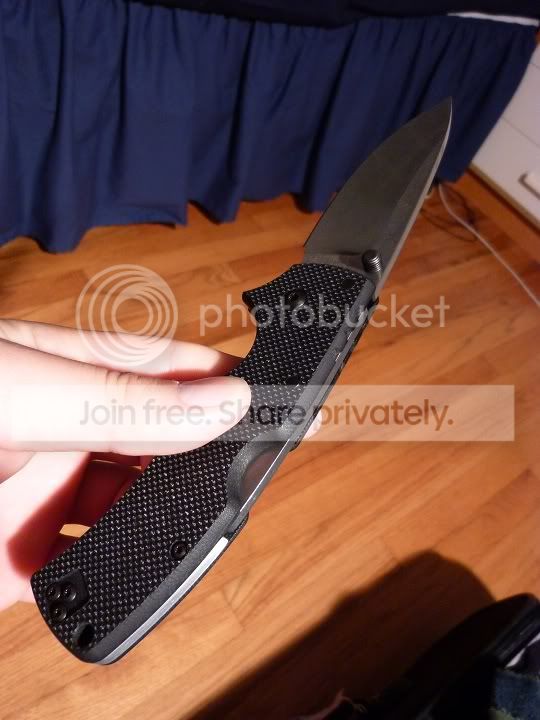

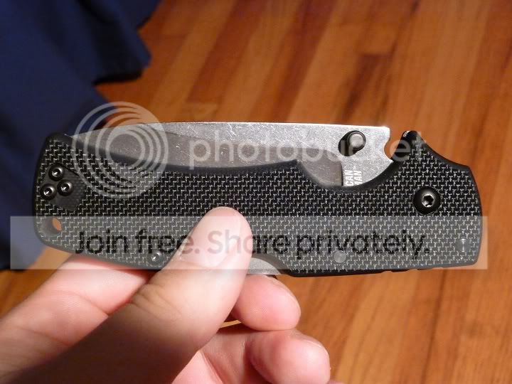

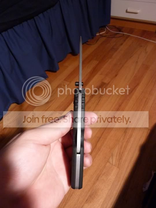

I didn't want to hijack the recent Lawman thread, so I'm going to post my pictures and impressions here. I just got it today, and will proceed to strip the blade, lockbar, and backspacer tonight, pictures will follow.
This knife came at least as sharp as my Recon 1. It slices paper and cardboard very nicely. The blade length is much more practical for me, it's the upper range of what I would comfortably EDC.

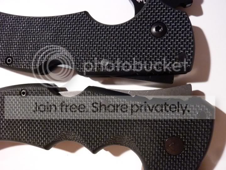

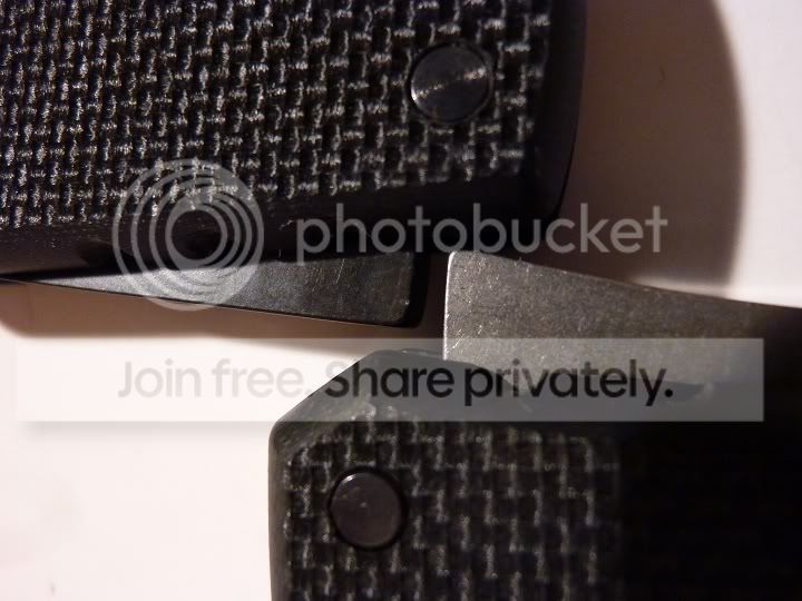

The blade stock and scale G-10 are the same thickness as the Recon 1. I think the G-10 might be even grippier, either that or I've managed to wear in the Recon 1 grip. The lockbar does not engage as deeply as the Recon 1 , and it has a shorter lever arm making it easier to disengage than the Recon 1. I don't have any less faith in it's lock though.

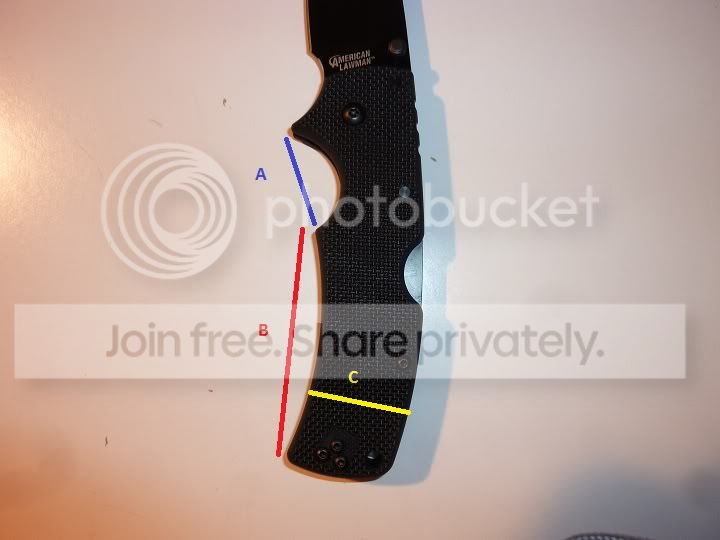

I like that there's the second finger choil up in the blade, but it's a little shallow at the front and I feel that your finger could easily slip up onto the blade. I'll only use it to choke up for more delicate tasks, where that risk is mitigated. The handle is not as comfortable as the Recon 1, which I don't blame on it's shorter length. I don't have large hands, and my middle, ring, and pinky fingers feel crowded. I think that the G-10 finger choil (A) is too large, and if it were made smaller, then the finger section (B) would be a little longer, and not quite as squished. I suppose that this makes the choil more usable with gloves however. Also, the handle width near the pinky (C) is about a 1/4 inch too wide for my hands. These are minor issues that are possibly unique to me. Overall, I really like the knife, and I would rate it as highly as the Recon 1, because the blade is a more practical length. I think a mini Recon 1 would definitely bump it in my book though.

...The lockbar does not engage as deeply as the Recon 1 , and it has a shorter lever arm making it easier to disengage than the Recon 1. I don't have any less faith in it's lock though...
Thanks for the review and pictures. I am thinking about picking one of these up, or maybe the CS Voyager in 3". I have small/medium hands and I worry that the finger choil/cutouts are too big for use without gloves.
Regarding your quote above, do you think that, after some time/use, the lock will seat deeper and more securely?
It's not a matter of wear, this is the level of engagement that is designed into the lockbar/tang. Don't be concerned about engagement strength, it's plenty robust. As this thread http://www.bladeforums.com/forums/s...e-in-the-Tri-ad-lock-vs-traditional-lockbacks shows, the Tri-Ad lock has a lot of engagement compared to other trusted lockback designs. The picture on the first page shows a Cold Steel Hold-Out which is, if I had to guess, at least as engaged as the Lawman.

My Recon 1 appears to have pins for the Triad bar that are smaller in diameter than those used in my G10 build American Lawman. Not by much but enough that you can pick up the diff with the naked eye. Your photo appears they are the same so it seems some earlier G10 models had larger pins if what I'm seeing is correct. It does look like the diameter of the shoulder stop and the pin center are different diameters on my Recon 1 which just came today, and my well used all G10 Lawman. I got this Lawman just as the change over from the original stainless lined models were phasing out.

All the pins look to be about the same size, but I didn't try to fit them, so I'm not positive. Another reason that the Lawman lockbar is so much easier to disengage (aside from it's smaller engagement, and shorter lever arm) is that the cantilevered spring inside the handle is longer. I suppose it could have a higher spring constant than the Recon1 spring, but I doubt it.
