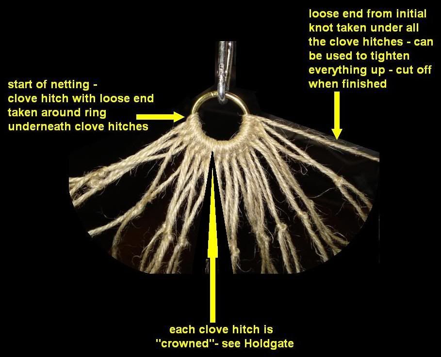

Well Don, since I last posted on here, I did some research on purse nets. They are a piece of cake to make. Actually there are 2 easy methods - both the one in the link above and also, easier yet - buy a piece of premade netting, cut it the length and width you want, add a split ring at each end, add the nylon pull cord and stake and you're done.

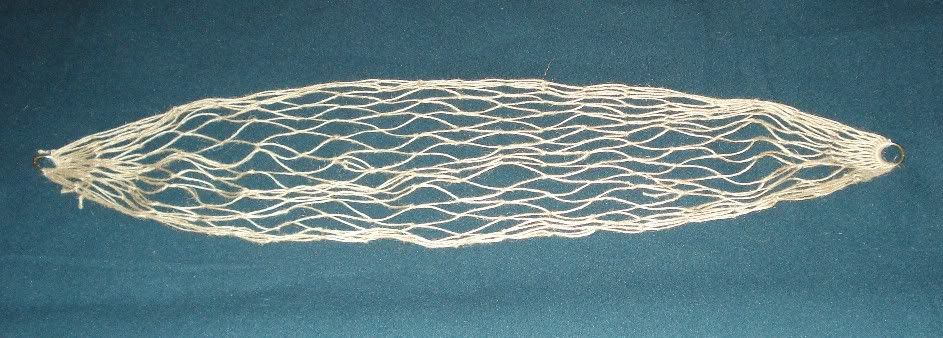

To further illustrate my point, this is how far I got before I realized that the mesh size/number was too small. :( A Spyderco Manix shown for size perspective.

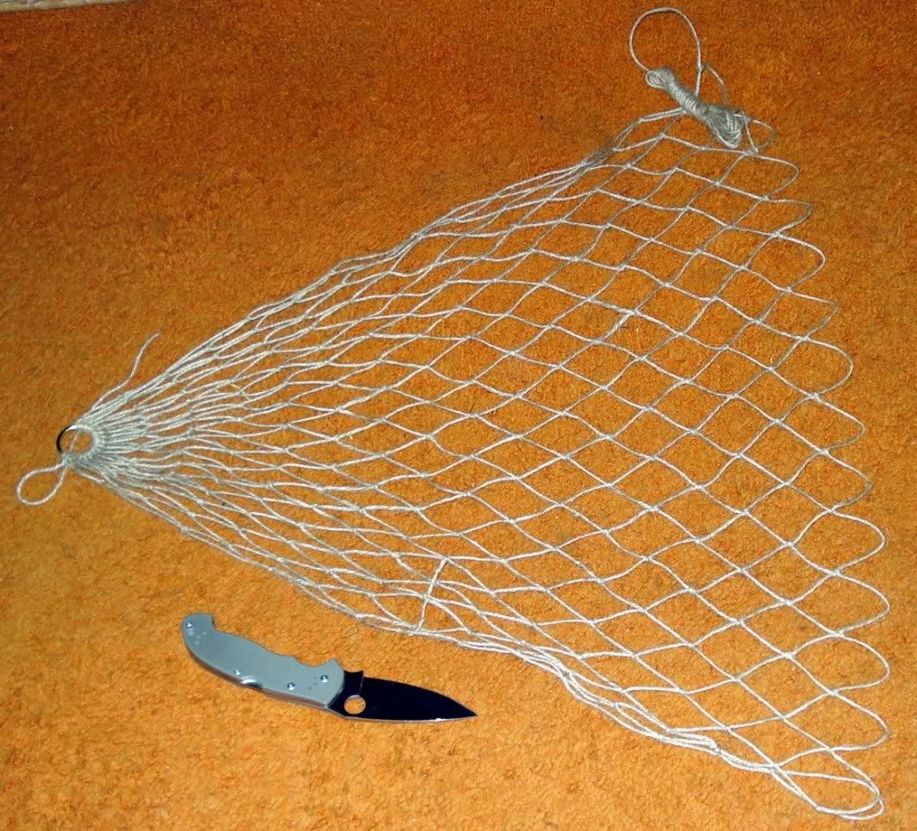

Hey Don, it's finished. Looks better in person than in this picture. It's 42" overall, 4" mesh (2" per side), 15 mesh wide and 18 rows long. I'll let you put the draw string and stake on.
Couple of additional details:

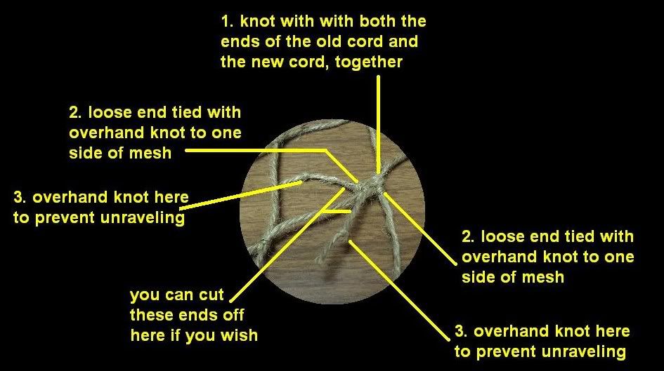

Details of joining in additional cordage, and options:
It was fun doing it - never made a purse net before. Also rekindled my interest in net making and I learned a couple of new techniques. :D
