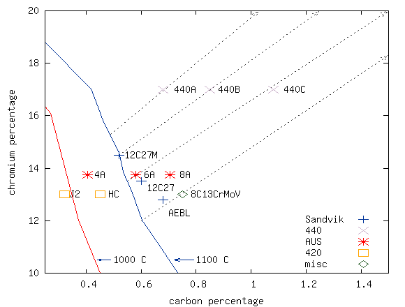

While tool and alloy steels have well known classes, the AISI D,A,S series for example, the stainless steels often get jumbled into one big group. They are often labeled by the carbon content, but that is flawed. Is L6 a low end blade steel because it only has 0.7% carbon? No, and thus saying the same thing about 440A is equally absurd. To rank the stainless steels requires consideration of the relationship between the elements. To start, consider the simplest stainless steels,C/Cr alloys, which mean the other elements are not in a large enough amount so as to induce a major influence on carbide fraction or hardness.
First, the solid lines are the carbon saturation lines which show the maximum solubility of carbon and chromium at 1100C and 1000C in the austenite. As would be expected, at the higher temperature the austenite can hold more carbon and chromium just like hot water can ohld more sugar. As the carbon content increases, the steel can dissolve less chromium as carbon dissolves and diffuses a bajillion times faster than chromium because chromium is much heaver. This is one of the reasons why increasing the carbon content and keeping everything else the same will decrease corrosion resistance.
Second , the dashed lines are called "tie lines". Any steel on a tie line has the same austenite C/Cr percentage at that given soak temperature which is the composition at the point where the tie line intersects the carbon saturation line. As the tie lines move to the left then their steels have the austenite percentage of carbon lowered (steel gets softer) and the chromium percentage gets higher (more corrosion resistance). As the tie lines move to the right then this reverses. As you move up along a tie line there is a higher carbide fraction in the hardened steel and thus a greater wear resistance and lower edge stability.
A few examples :
1) 8C13CrMoV vs AEB-L : They are close to the same tie line so have similar as quenched hardness and a corrosion resistance. 8C13CrMoV is to the right of AEB-L and thus has a higher carbide volume (this is basically a linear responce of the distance along the x-axis of the two points) and so more wear resistance and lower edge stability. 8C13CrMoV is a higher wear alternative to AEB-L and AEB-L is a higher edge stability alternative to 8C13CrMoV. Both of these differences are small because the distance between the steels is very small. To obtain a higher hardness or more corrosion resistance requires a steel on a different tie line. Note 8C13CrMoV is used on the Byrd line and AEB-L on high end customs.
2) 440C vs 6A : Same thing only this time the differences are large because these steels are quite far apart on that tie line. This is contrary to popular opinion which dismisses 6A but the above shows it would be expected to have a similar max hardness and corrosion resistance and a greater toughness, initial sharpness and edge stability. Hard to argue all of that has no benefit in any knives.
3) 440A vs 440C : These are on two different tie lines. Looking at where both tie lines intersect the carbon saturation line shows 440A has a lower carbon content in the austenite but a higher chromium content. The corrosponding distances along the x-axis from their positions to the saturation intersect points predicts that 440C has a much greater retained carbide fraction. Thus 440A would be expected to be weaker but tougher, more corrosion resistant but less wear resistant. This comparison of course isn't surprising.
4) AUS-6A vs 12C27 : Very close positions and thus would have very similar as hardened strength, corrosion resistance and wear resistance and edge stability. This is contrary to popular opinion which often dismisses AUS-6A but praises 12C27.
I'll follow this with a table which shows the austenite composition of these steels at a specific hardening temperature and what this means in terms of as-quenched hardness and carbide fraction. Just how much more carbide is in 440C vs AEB-L for example and how much harder is AEB-L than 12C27M. Note, and this is critical, optimal performance requires involved heat treatments which includes fairly high austenization temperatures for some of these steels, quenchants (not air cooling), and repeated cold treatments and tempers. Landes has given specific recipies for steels to optomize them for cutlery. These are not what is often given off a spec sheet because those methods are optomized for high volume production where the performance/cost ratio tolerance is very low. I'll eventually web page this and include the relevant references
A few examples :
