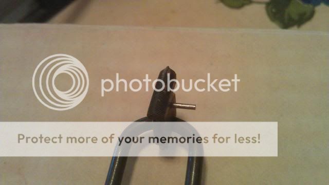

This is your single line 60 degree short cutter. Use this to cut your master lines in a second and later on to cut lines in places your other cutters won't fit.

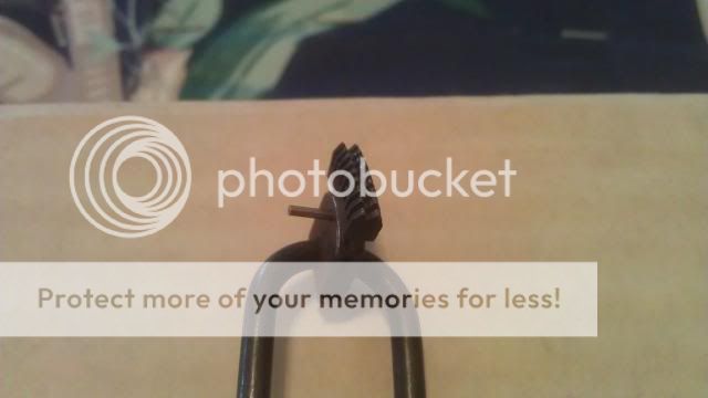

This is the 60 degree double line cutter. Once you get a nice deep line cut with your above tools, ride one side in the first line and carefully cut the new line with the other side. This is tricky. You have to push hard to keep in the line but if you push too hard you can fling out and make a booboo.

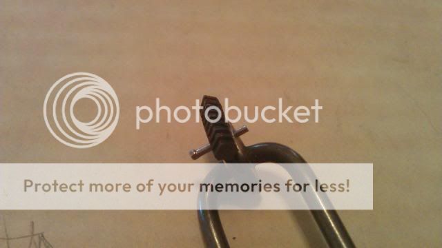

Here is the single line finishing cutter. This one has a ton of finely spaced teeth that are basically the checkering tool equivalent of fine grit sandpaper. The diamonds will be fairly rough and flat on top until you hit them with this bad boy. Then they'll be smooth and sharp! Sweeeeet

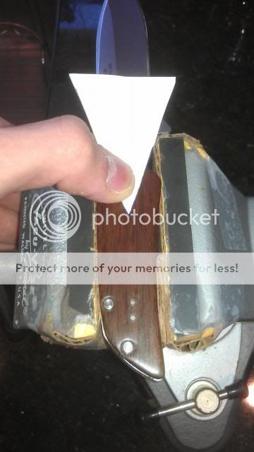

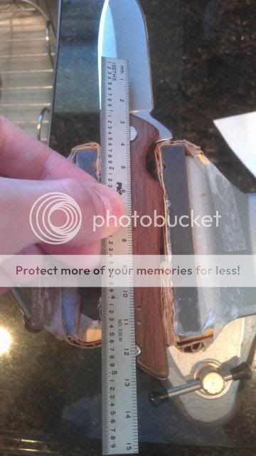

Put your knife in the vise, grab your straight edge and mark the center line.
Grab your template to make diamonds 3x longer than they are wide. The angle needs to be 37 degrees if my memory serves. Line the point up with the dot and trace the edges onto the scale with a felt tip pen. Don't worry about contaminating the wood with the ink, you'll check it off in a second.

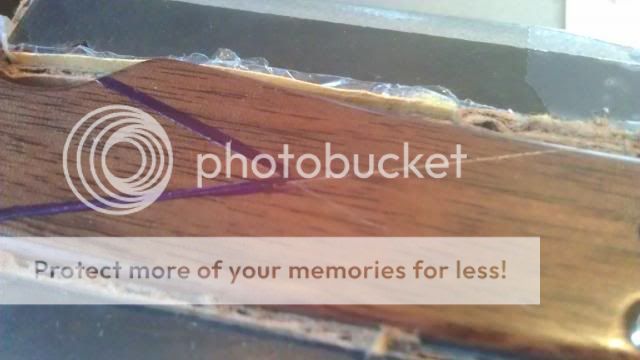

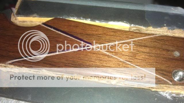

Use your other knife, for me this was my Benchmade Torrent :thumbup: and score the line that will become your master line using your straight edge like so. The deeper you make this score line, the easier your master line will be to cut but don't screw up and cut all willy nilly because you were pushing too hard! This is tricky!
I use the short cutter to cut the master lines because I can see exactly where I'm cutting and it's an aggressive tool so it follows the lines easily(ish). You can't win it all here but you can totally lose it! These lines will dictate the integrity of the rest of your lines so it's important to cut them as straight as you possibly can. I use minimal pressure at first and build up to cutting pressure once I wear through the finis

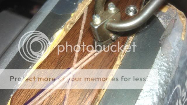

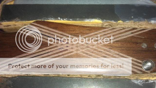

Now the master lines are cut, use the double line cutter to move on. Push hard enough to stay in the first line but you have to twist the tool a bit at first and level out as the second line gets deeper. This takes a bit of practice to do all at the same time.
~30 minutes later
In a few hours you'll be here. The diamonds are roughed out but they're still generally flat on top and need some work.

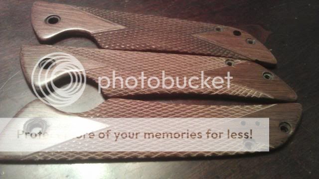

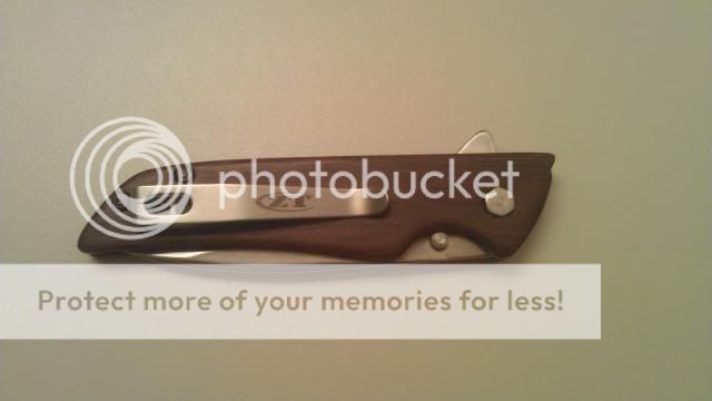

The finished products before last coat of TruOil finish. The top scale represents my first attempt from a few weeks back, and the bottom two are the ones I finished today.
In a little while the last coat of TruOil will be cured and I'll post pics of the real finished product!
