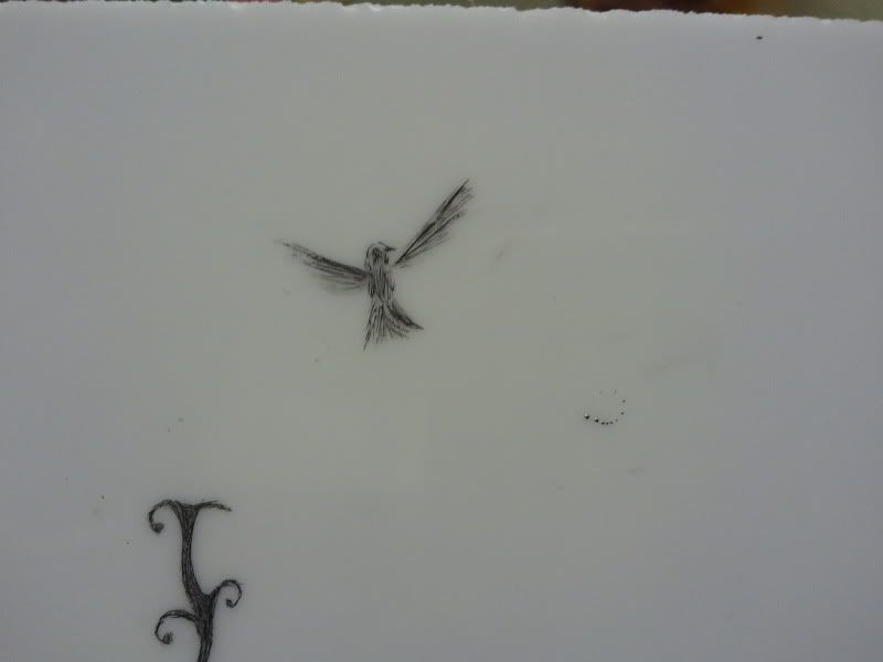

I've always been intrigued by scrimshaw, and being a sailor I am really drawn to it artistically. I have always sketched, and kept a sketch book with me for as long as I can remember. I finally decided to give it a shot. I'm not a real great artist or anything, but I enjoy my work and that's all I do it for.

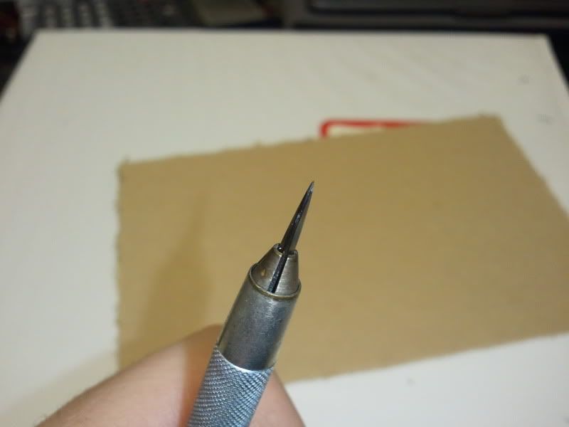

I took one of my large sail repair needles and sharpened it to a very sharp point and loaded it into a 2mm lead holder. I have a stack of acrylic sheets I use for scales on my straight razors, so I grabbed a white one. I didn't lay out a drawing or anything first, just kinda started. Once I figured out how to best make lines, I just started sketching. Well, it turns out that a triangular shaped needle is not ideal for this work, the scribe tends to wander as a flat edge catches and goes off course. I will make a new one from a broken drill bit.

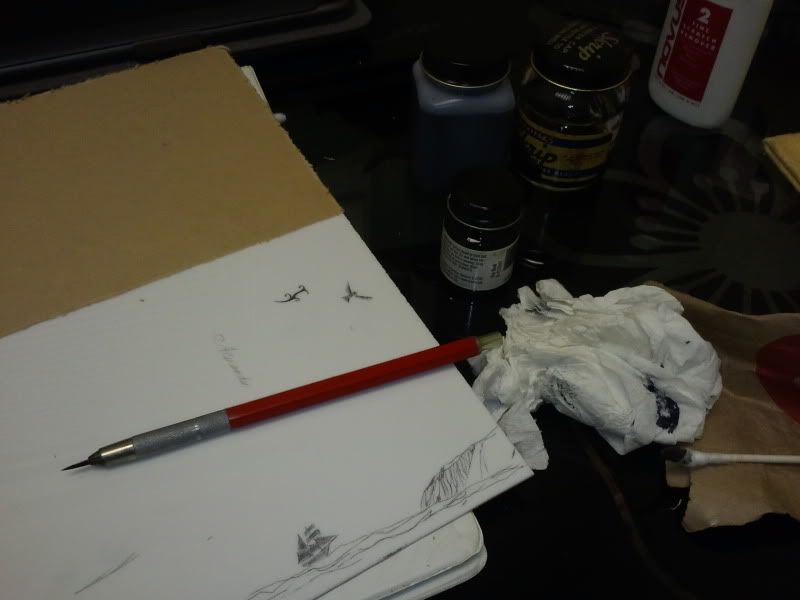

So after I got some lines in the plastic, my next step was to color it. I tried India ink (FAIL), permanent fountain pen ink (FAIL), sharpie (FAIL), and testors acrylic model paint (semi-FAIL). The India nd FP inks just beaded up on the plastic and didn't collect in the scratches at all. The sharpie did cover well, but again didn't stick in the lines well either. The acrylic paint covered very well, so well in fact that I couldn't buff it off and thought I was stuck with a big black smear on my plastic :eek:
Some isopropanol eventually took the paint off and I realized I was "denting" the plastic in places rather than cutting a line in, so nothing would stick in it. I resharpened my scribe carefully and went back over it. The lines looked better, but now I was still stuck trying to color them. A quick youtube search and I found I should apply the paint and keep buffing until it is dry and most all of it will be off the piece. Of all things, a white plastic eraser worked the best to remove the rest of the overage of paint.
So here is my feeble first attempt at scrimshaw, I hope to be able to add it to a knife someday and plan to keep practicing at it. Maybe I will polish up some antler and see how it goes compared to the acrylic.

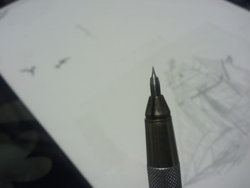

Ok, so I fashioned up a new scribe from a broken HSS drill bit. Not having a metal lathe made it difficult, I ended up chucking the soon to be scribe in my dremel and put a fresh 120# belt on the 1x30, turn the dremel on and hold it against the running grinder. Worked well! I managed to get a steep enough angle on the point and to keep it from breaking easily I put a step in it so it wasn't such a long taper. Some 600# paper against it while in the dremel polished it right up.

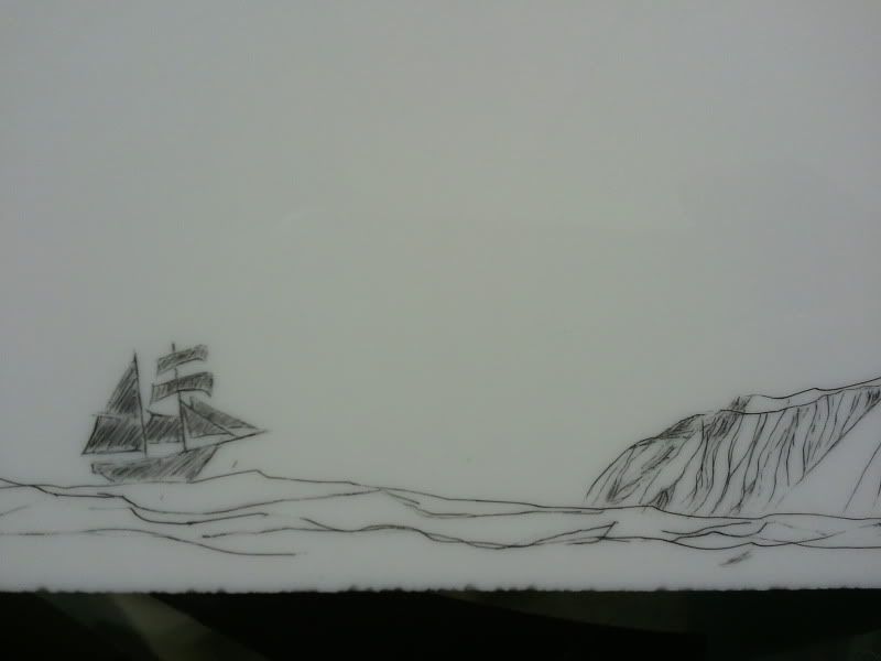

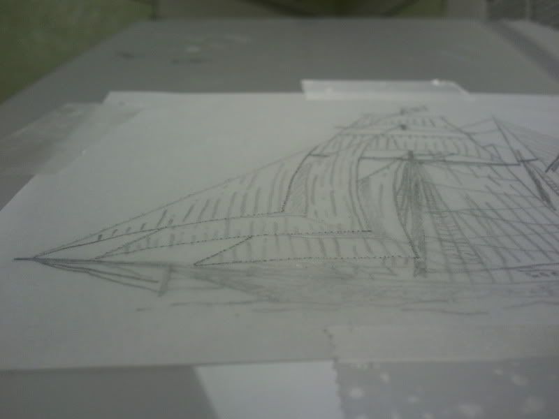

This new scribe point is so much easier to control direction than the three sided needle I used first! So being the hard headed person I am, I tested just a couple lines with it and then sketched out an ambitious project! Its roughly 2.5" square, not terribly detailed, but is a significant projct for me. It is of the T.S. Californian, the tall ship I sailed on when I was 18 as a bosuns mate/watch captain.
So I cut out the sketch and taped it to my sheet of plastic. I am outlining the major shapes by the bulino method, basically a bunch of tiny dots really, really close together. Once I get the basic shape done I will remove the sketch and then connect the dots creating solid lines.
