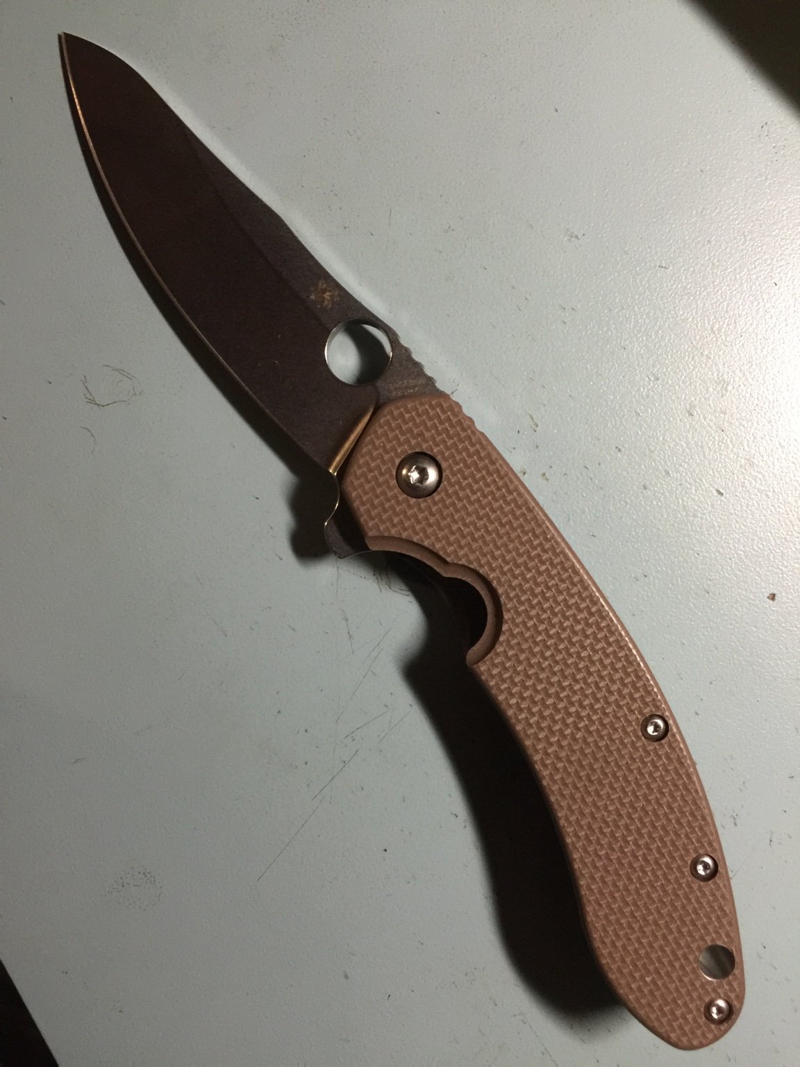

I love knives, almost anything with an edge calls my inner child to play, so I recently bought this Southard here in the exchange, it is basically brand new, and as it usually happens with any Spyderco I get, I love it. The action is just perfection, it opens almost effortlessly; the construction is flawless, the centering perfect.

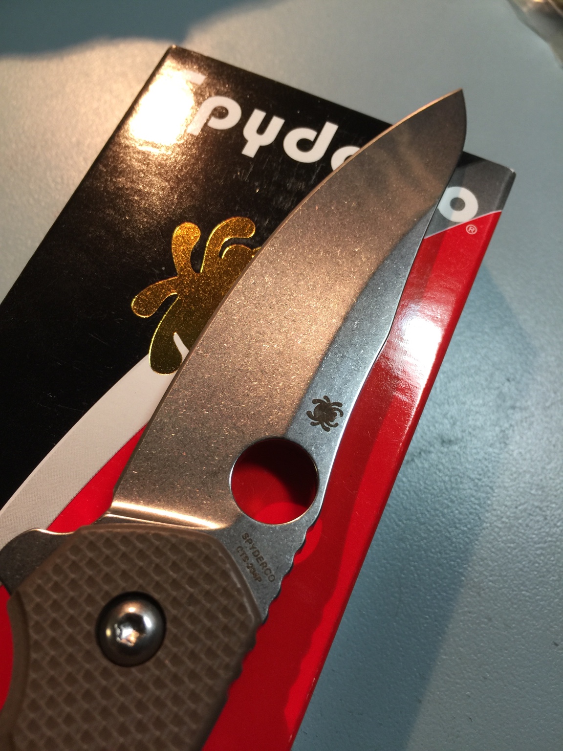

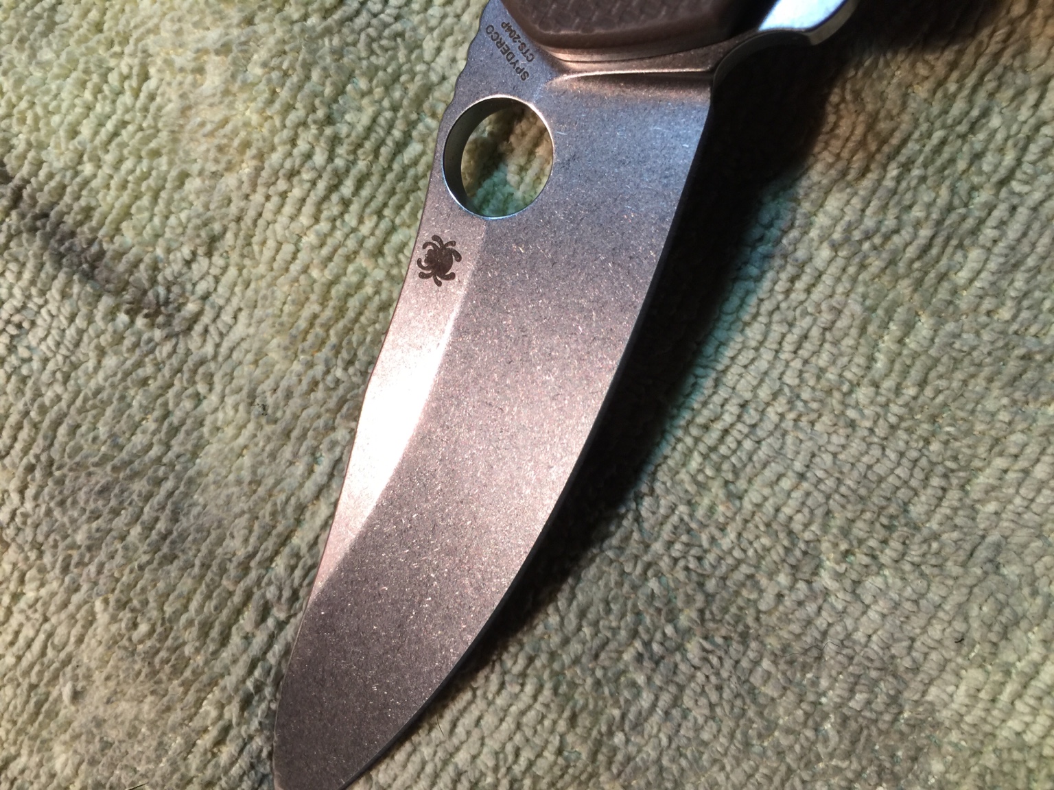

Let me start with the beautiful stone wash finish, I'm not a metallurgist but this particular steel, CTS-204P, is very cool looking when finished like this:

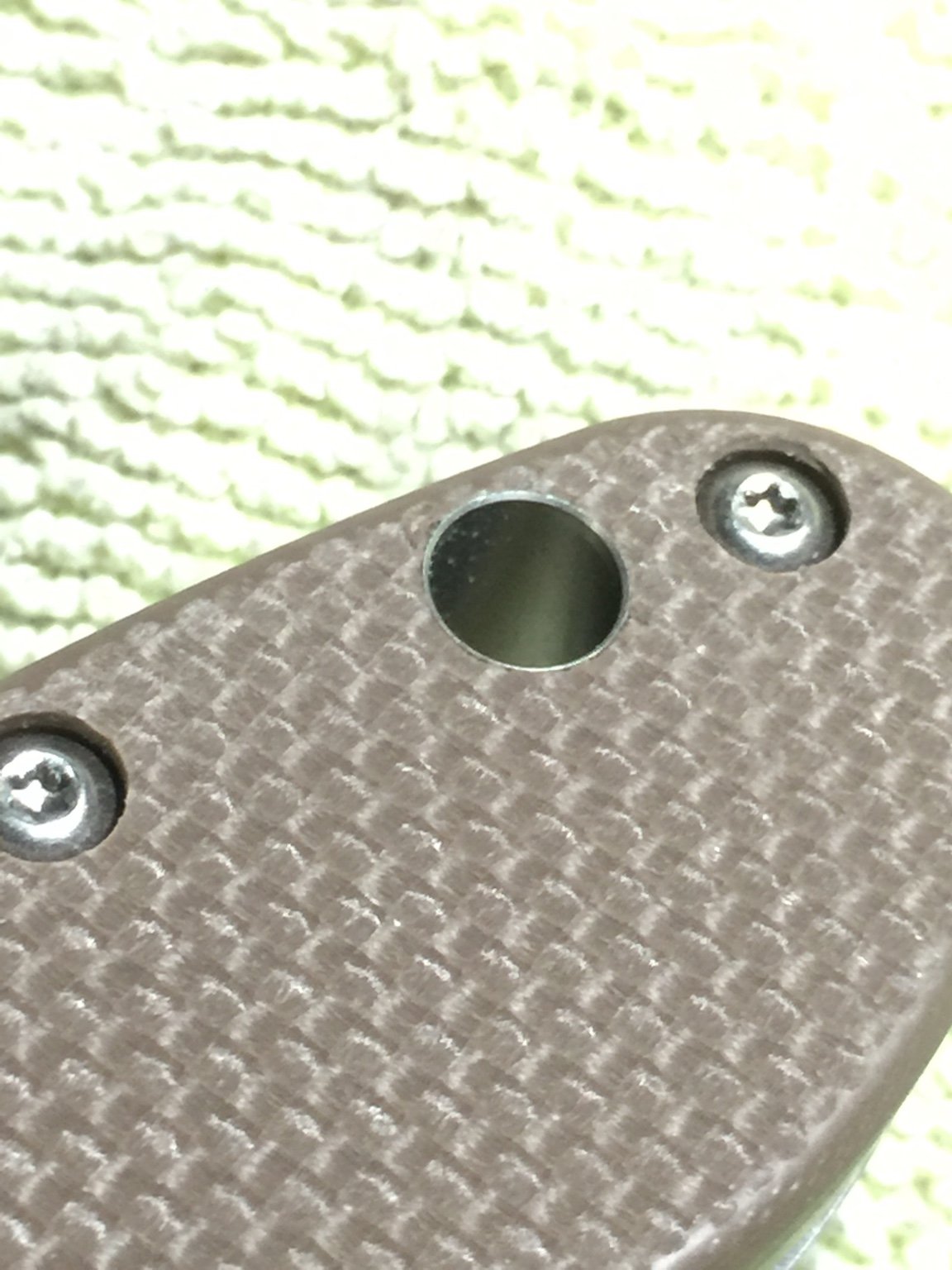

The knife is held together by ten screws, 2 T10 in the pivot, 6 T6 in the stand offs of the handles, and another 2 T6 holding the pocket clip; which brakes away from the typical branded clips and it's perfectly positioned to the side of the R.I.L.

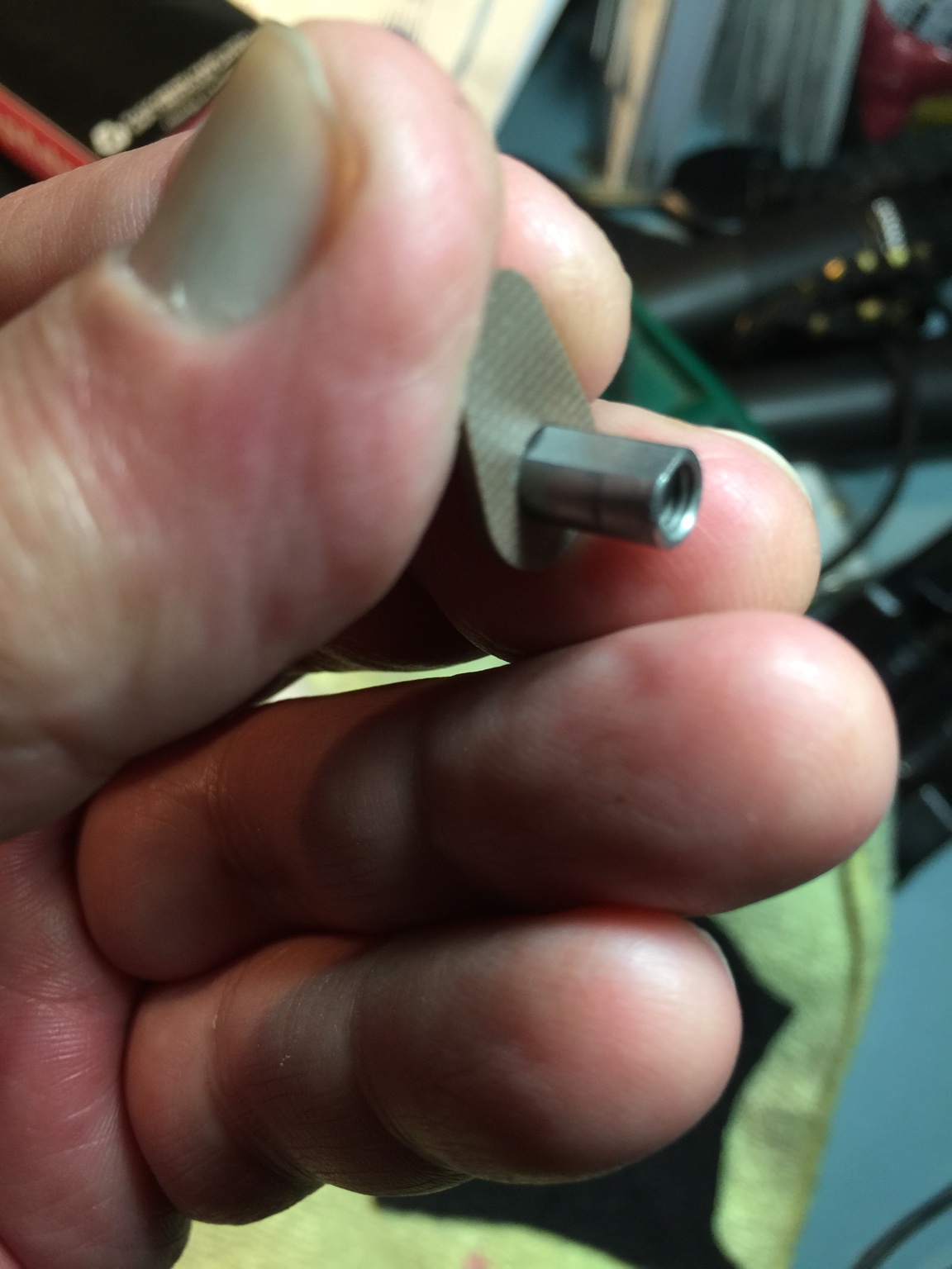

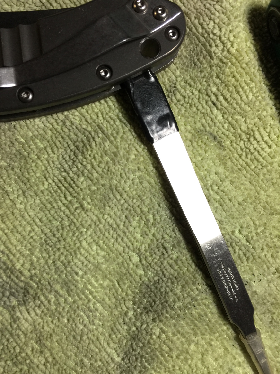

The lanyard tube is pressed fitted into the scales so I was having a hard time taking them apart, I gently pried them open with the handle of a pair of tweezers wrapped in electrical tape:
I hope you guys don't mind the greasy microfiber rag; it works to keep all pieces in one place though. (I'm on my laptop now, and I see my dog's hairs in there too, oh well, I love my black Labrador but his hair is all over the place!:() The tube is also perfectly flush with the handles.

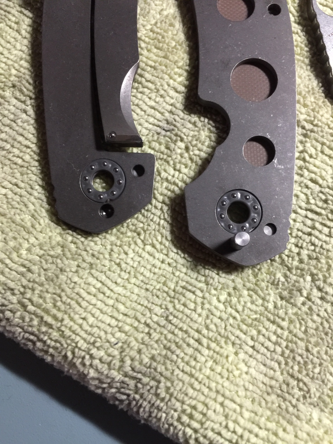

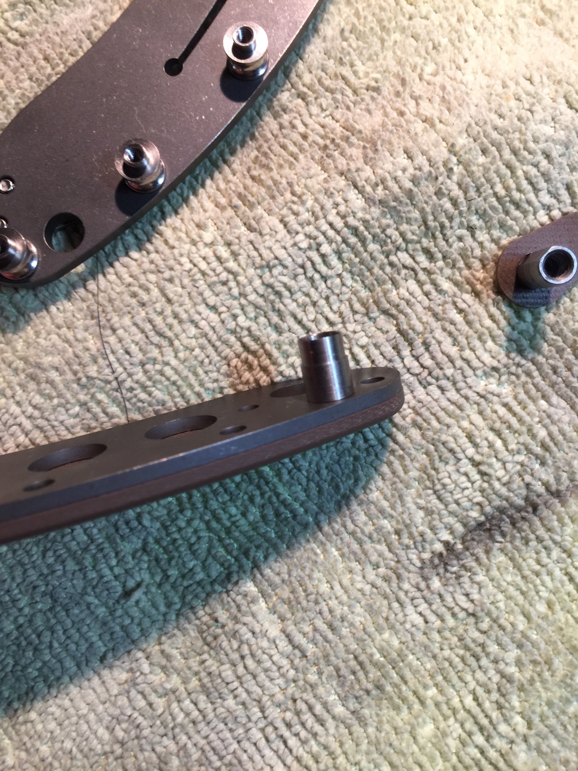

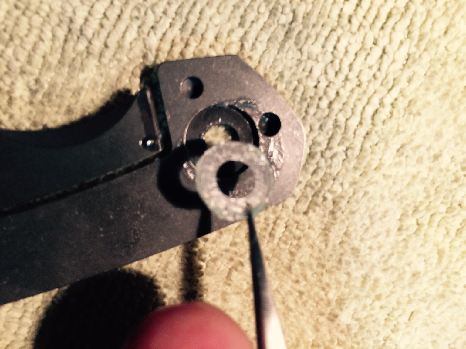

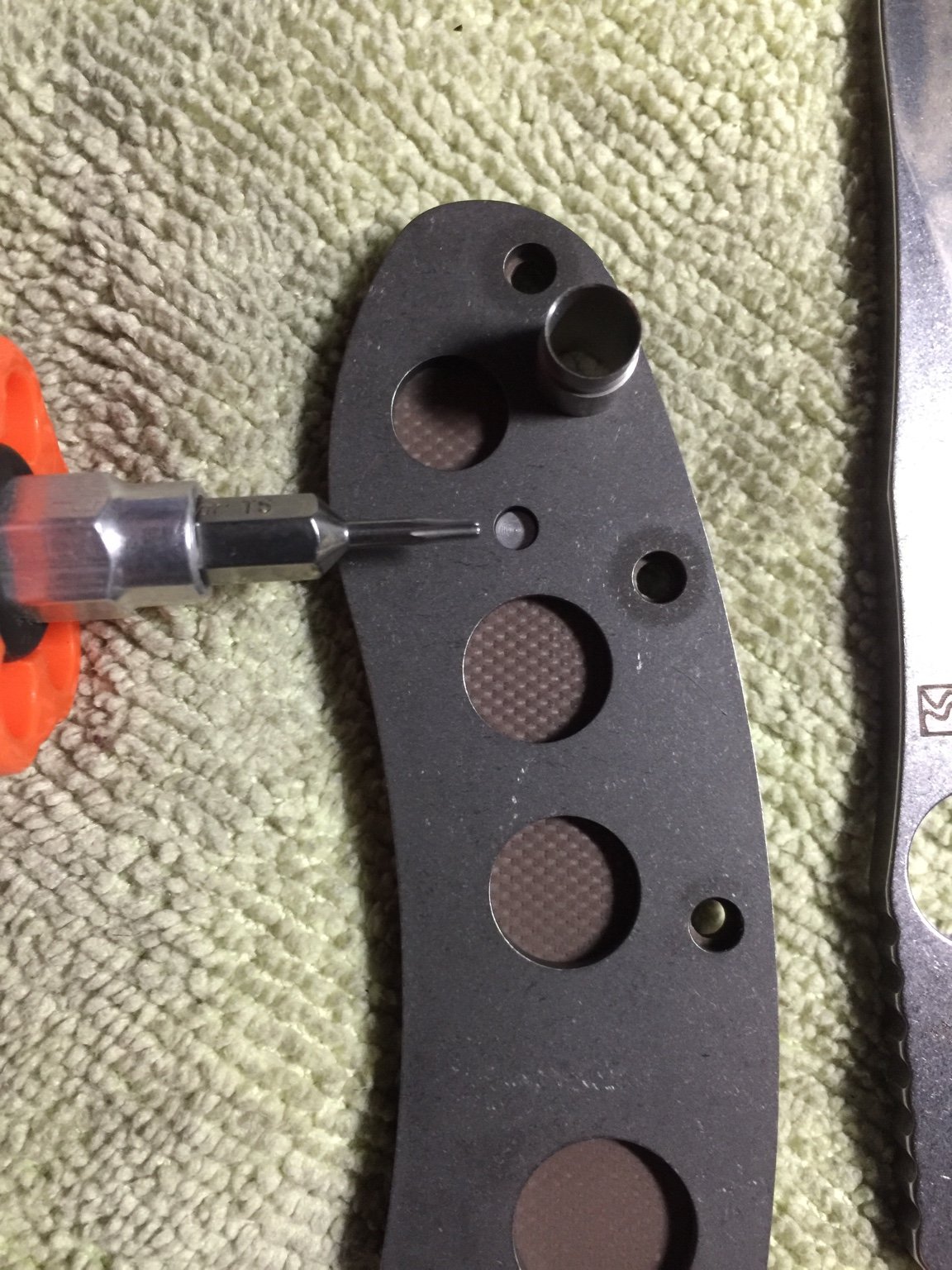

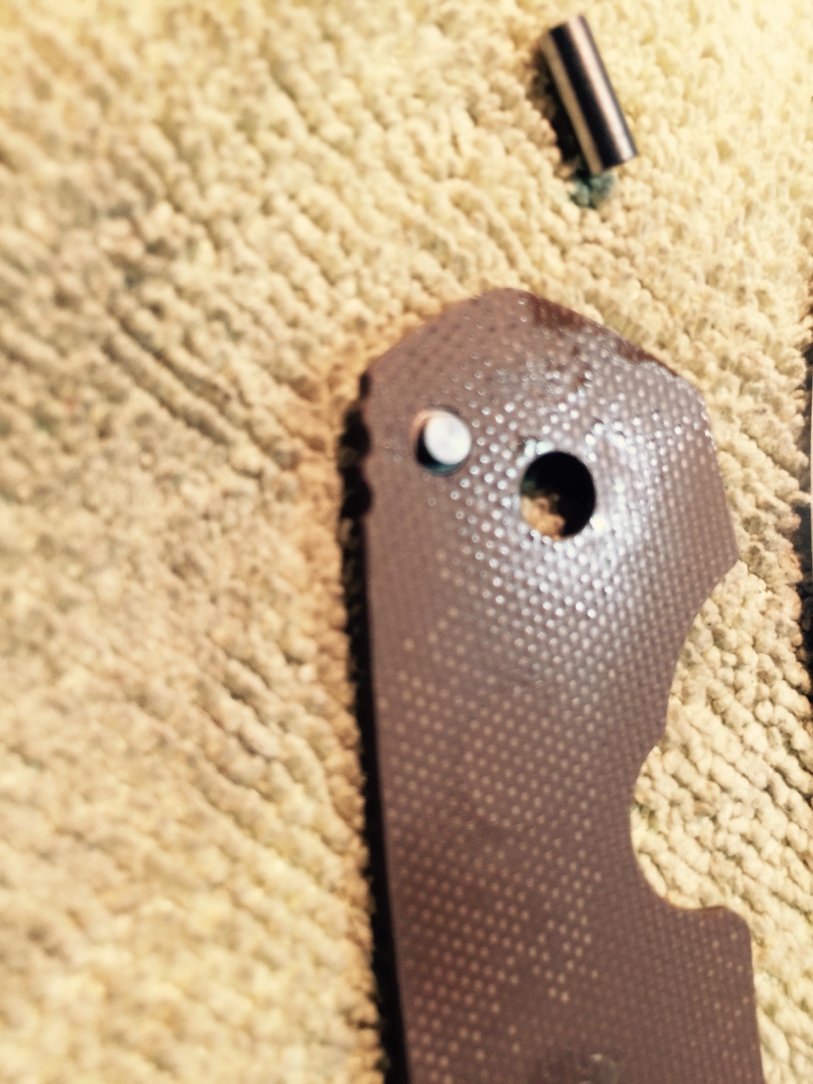

One thing that impressed me is that the G-10 brown scale has two short pins installed to keep it from sliding out of position from the titanium liner, I have the torx wrench tip pointing to them in these pics:
Here is one of them without the liner on top of it:

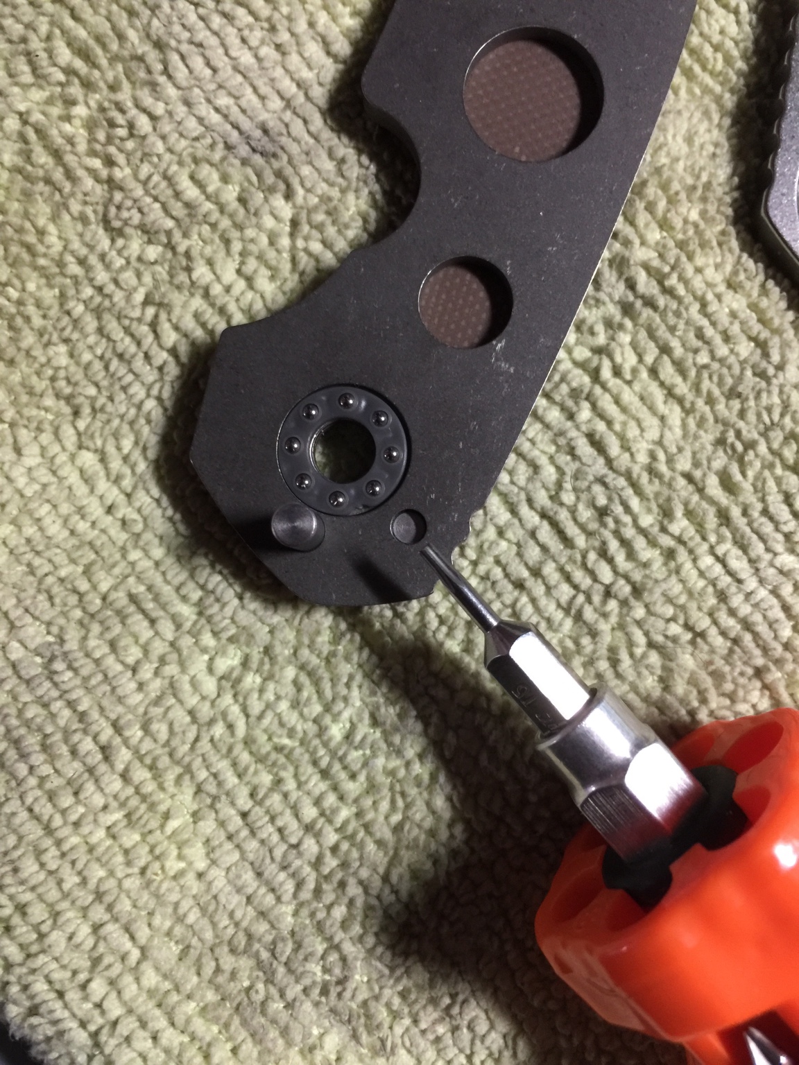

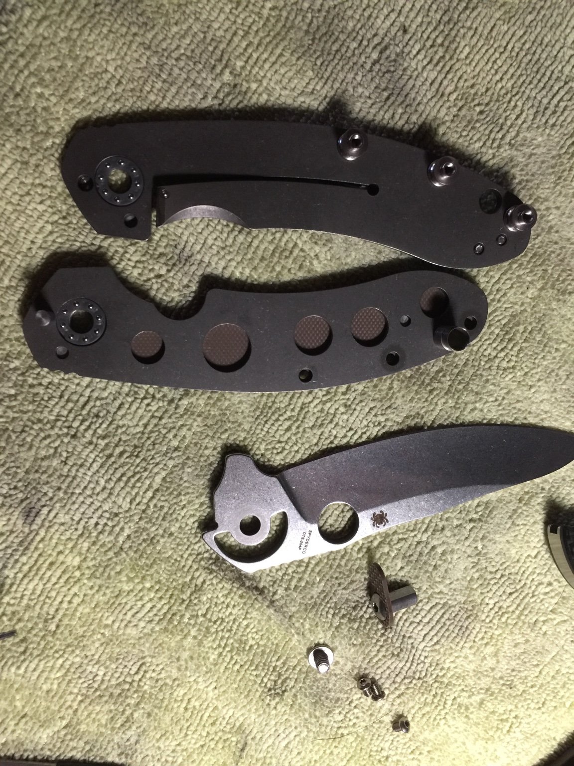

Here are the major components separated:
As you can see, the blade has a cut out, or channel for the internal stop pin, which is securely held in a hole machined in the titanium liner/handle combination; I hope that makes sense.

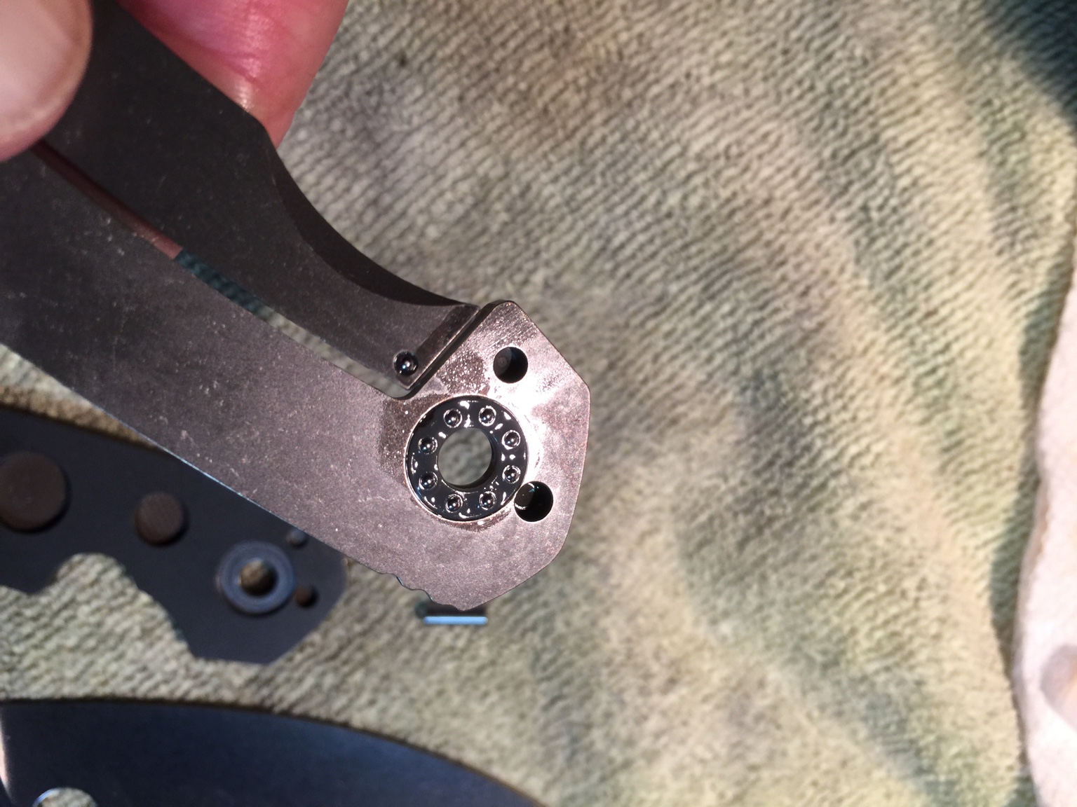

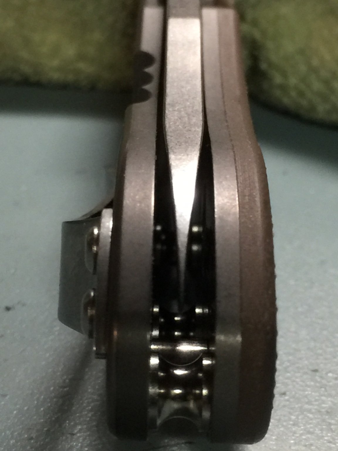

Next comes putting some lube in the ball bearing washers; this is the whole purpose of taking the knife apart; for this I hold the parts to be lubed under a halogen lamp just to warm them up and melt the grease; the theory behind this step is that metal expands as it gets hot, allowing the grease or lube to penetrate into the surface; (in fact these are the instructions for use that come with frog lube):
As I was doing this, I discovered that the ball bearing washers sit on top of a flat stainless steel washer that is nested in the titanium liner/handle washer pockets; this is obviously to prevent wear from the stainless balls riding on bare titanium; I thought this was not only necessary but also genius:

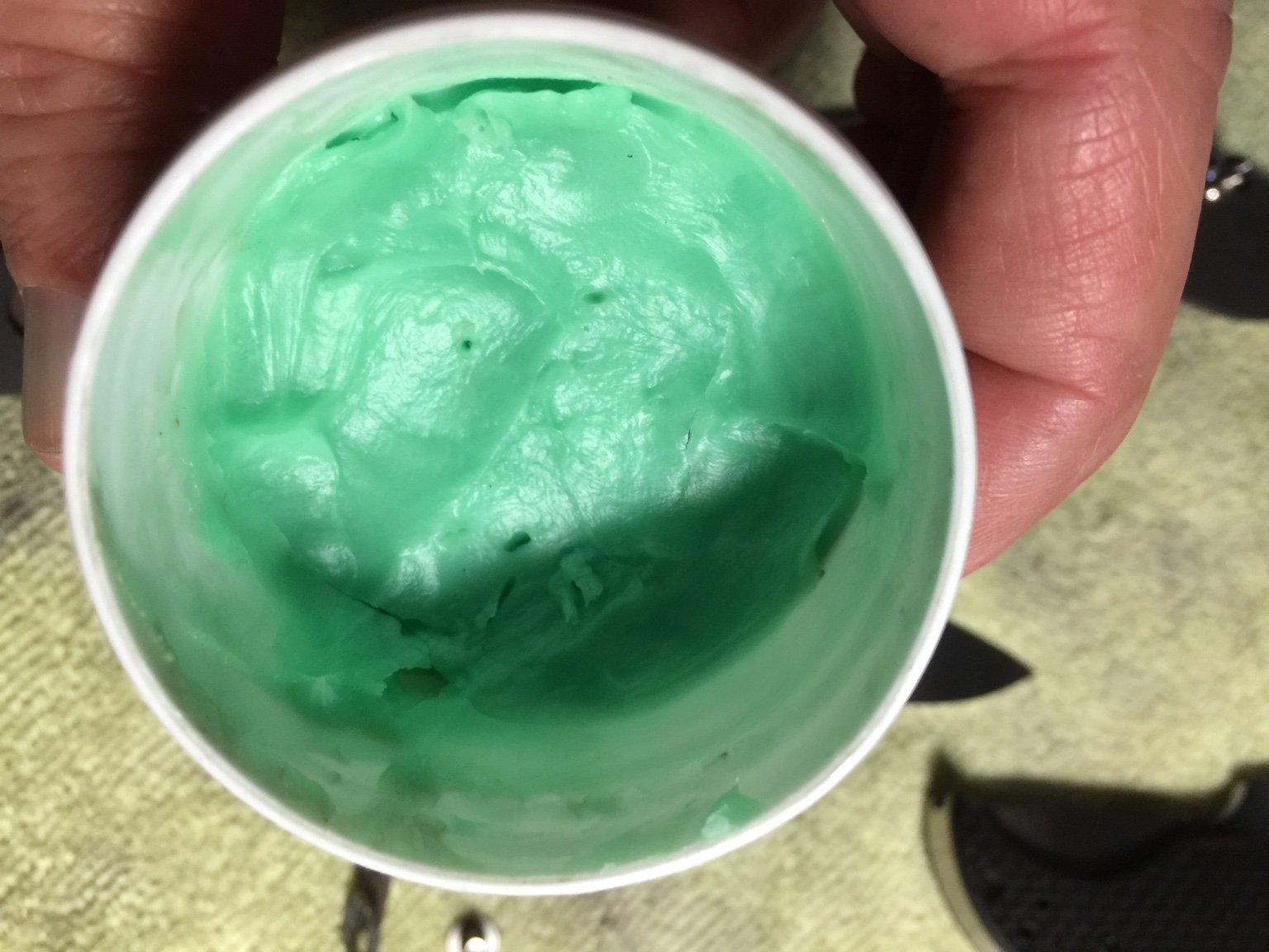

The Frog Lube grease:

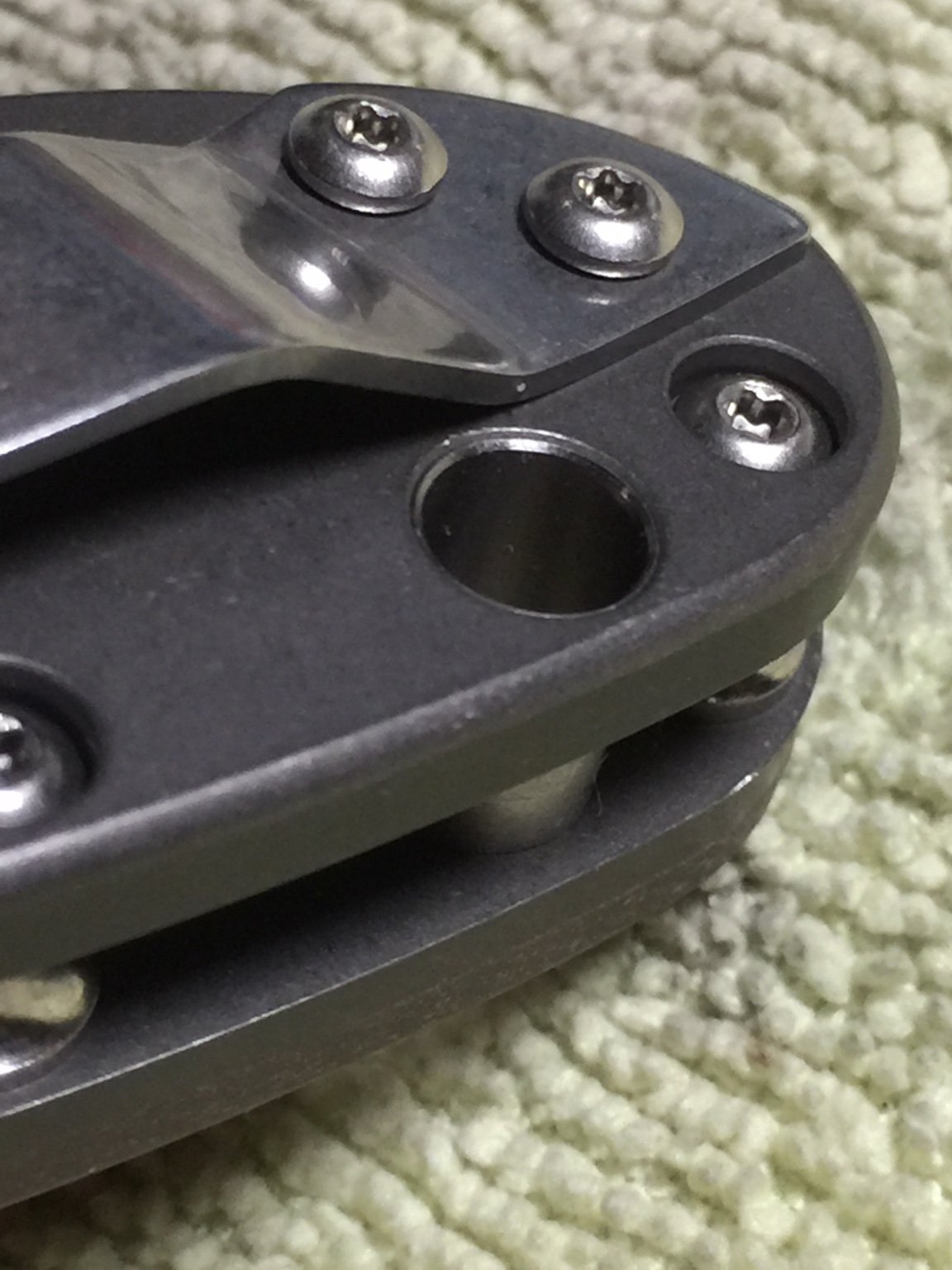

The pivot/over travel lock stop (genius, again):

I would second think using frog lube. At first glance it seems like the perfect idea and that's why I used it at first but after a couple months it started to gel up and get sticky where it was no longer acting like an oil or grease but slowing everything down. When using frog lube for firearms people are having problems when using too much. Your supposed to wipe off all excess and everything is fine but using it as a bearing grease I'm not sure it's the best way to go. I had a at 0562 that I had to clean off all frog lube which wasn't easy to remove . I ended up using regular gun grease till I can get something better. Great post though and love the pics.
Thank you. I have not experienced any gumming up or slowing down on any of my knives, nor my guns; of course I don't over use the stuff; I use a tiny bit and wipe all the excess, which I am not showing in the pictures because I was doing the whole thing and taking pics at the same time, and honestly forgot to take some of the details. I guess everybody's experience differs; they might be using too much of it, as you mentioned; I love the stuff and won't stop using it, it works great for me. I also have it in my 0560 and I didn't have that experience.
It is also very easy to remove; alcohol wipes it right off, that is my experience though; strictly personal; I'm not recommending it but I love the stuff; to each his own as they say.

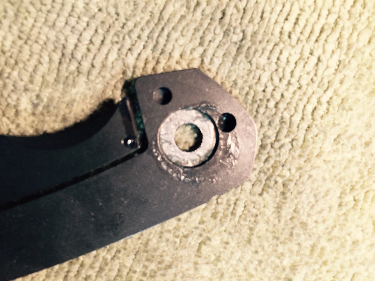

I struggled with keeping my Southard - loved the knife - not so much the flipping action, which to my mind was less than stellar. Looking at the photos of your bearings I understand why. My bearings were mostly buried in their nylon casing. The nylon sleeves came up and around the bearings. The bearings did not stand proud as they seem to be in your photos. No matter which surface I used the bearings could not make effective contact. The bearing/washers were dished too and that added to the lack of contact - too tight or too loose depending on which way the dish effect was oriented. I think I should have sent that knife back to Spyderco.

Man that's a bummer, sorry to hear that; sometimes a bad one goes by QC that ends up in someone's hands and turns that person away from the model, even the brand; I have a friend that says his Domino was a lousy flipper but mine was absolute perfection; yeah Spyderco would have taken care of it for sure, maybe you can get another one in the future; and you're welcome, it was fun. It is a great knife for me.
