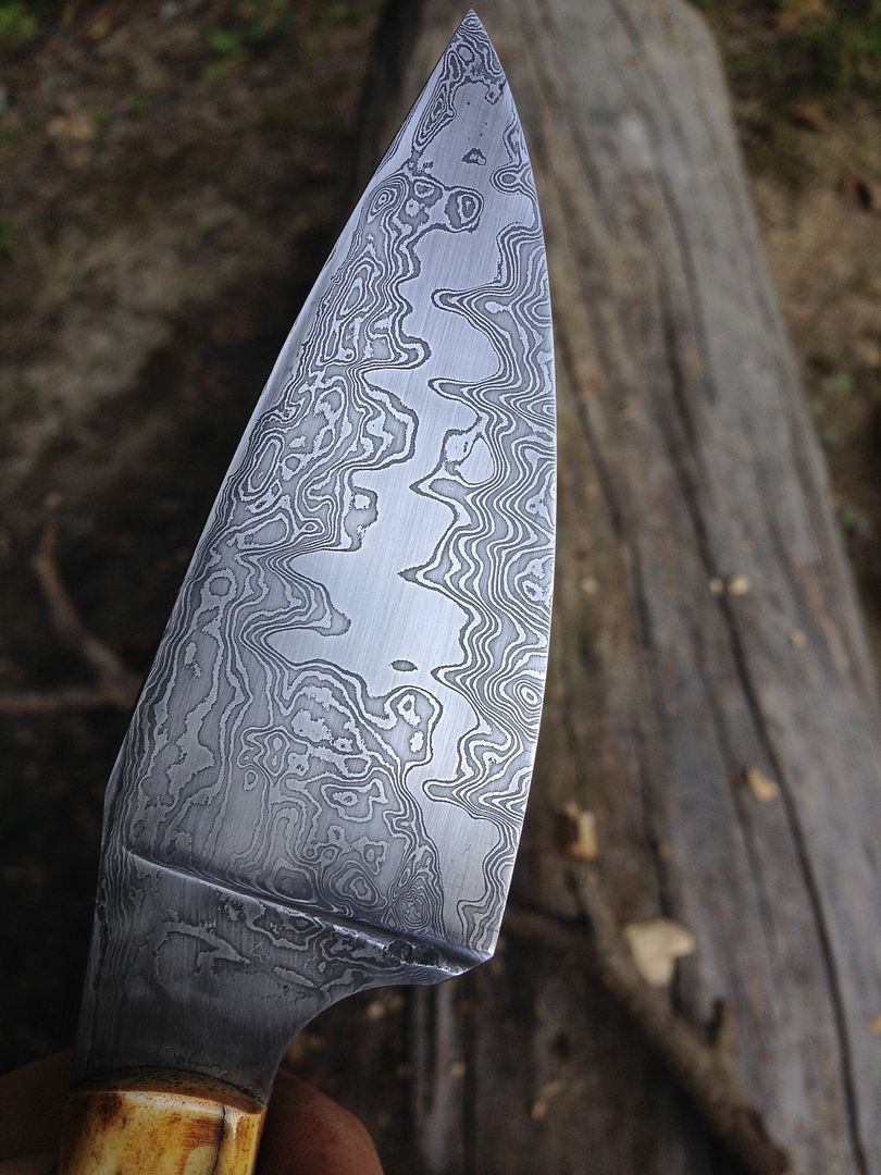

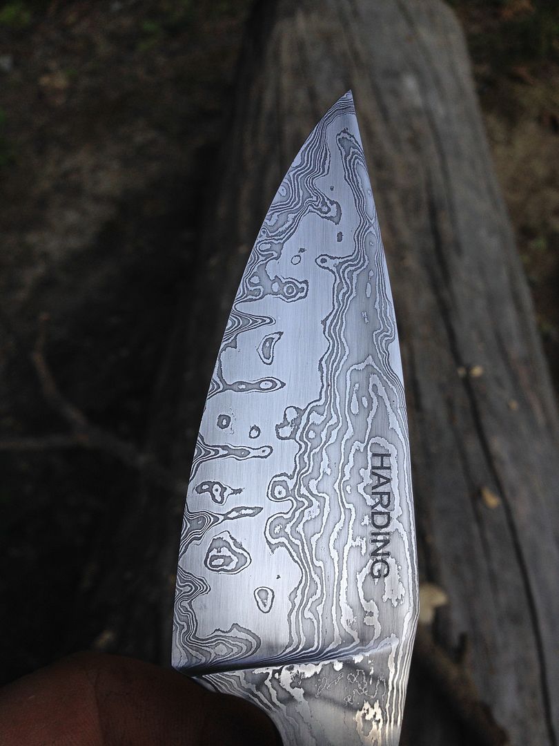

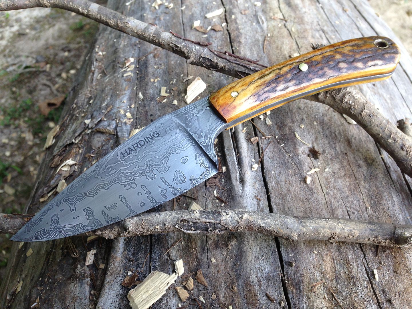

hardingknives Joined Mar 29, 2010 Messages 588 Sep 23, 2016 #1 83 layer random with some ladder and some of my old ass elk and brass
P paneraica Joined Mar 4, 2011 Messages 304 Sep 23, 2016 #2 I like that one. Nice blade shape and overall simple design DON
J jmcdaniel0 Joined Sep 22, 2015 Messages 47 Sep 23, 2016 #3 I like everything about this knife. Love the handle material! Interesting damascus pattern. is it 1084/15n20?

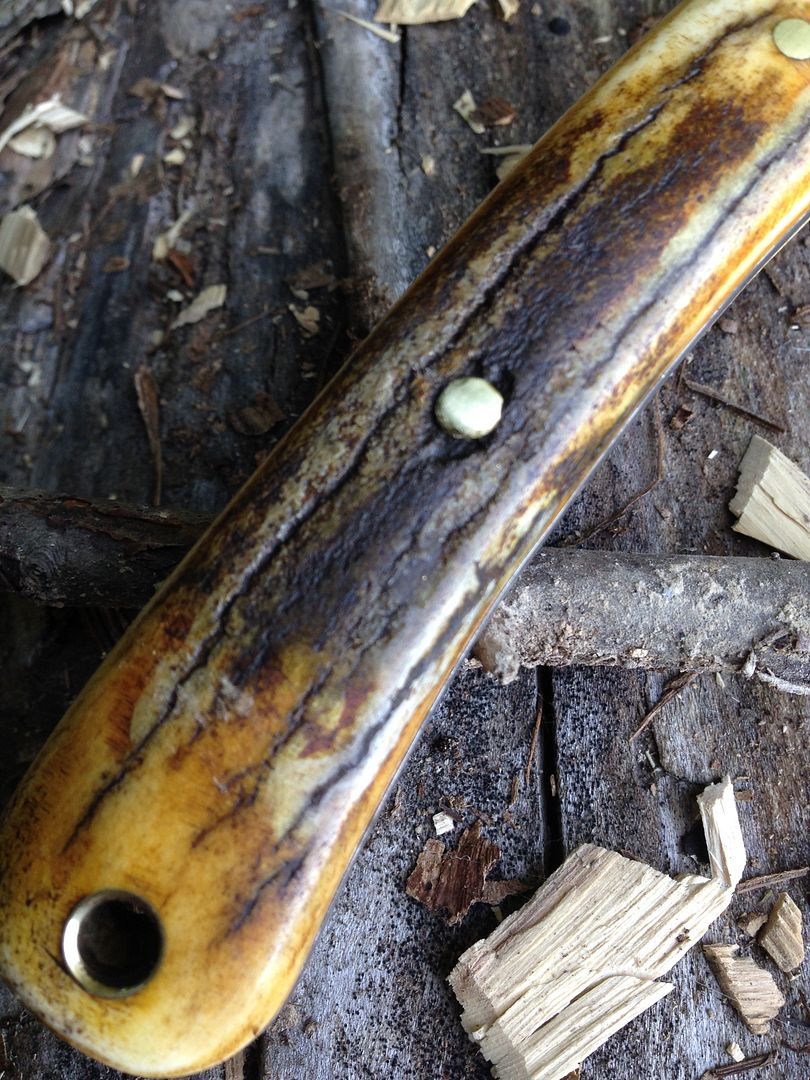

W watermule Joined Nov 26, 2015 Messages 246 Sep 23, 2016 #4 Again, love that old elk antler, great combo again! Rob

hardingknives Joined Mar 29, 2010 Messages 588 Sep 26, 2016 #6 Thanks guys! Steel is 1084 and 15n20, 81 layers with two thick 15n20 layers added then ladder cut made with a grinder
