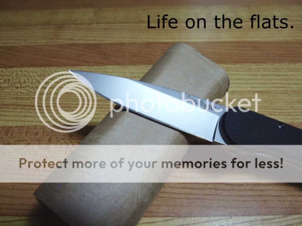

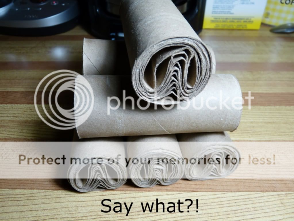

So there I was on the commode, playing with my...(wait for it)...knife. Everything to read had already perused and as I gazed around, my eyes fell on a few empty toilet paper spools, you know, the recycled cardboard cylinders that the TP gets rolled up on. I was turning one of the spools around and suddenly it was like that scene in 2001 A Space Odyssey, where the ape man is flipping that Tapir bone from side to side, all the while looking at it from a different angle. I slowly flattened a core and then folded it in half, lengthwise. I grabbed another spool and inserted the folded core into it, then I flattened it too and inserted it in yet another core. I repeated the process a number of times until it formed a shape that you see in the pictures below.
I discovered that when you get enough cores folded within an outer core, enough tension is placed on it to flatten one side and leave the remainder in a circular form. Knowing that Ernest Emerson recommends the back of a legal pad to fine hone his knives, I figures that my little invention should work as well, so I tried it on a few of my working knives that had lost that shaving edge. Well, a couple of minutes on the 'core' and they were back to hair popping sharp. The round part of the cylinder worked great on recurved blades as well! Now I just do more frequent touch-ups and everything is nice and sharp.
