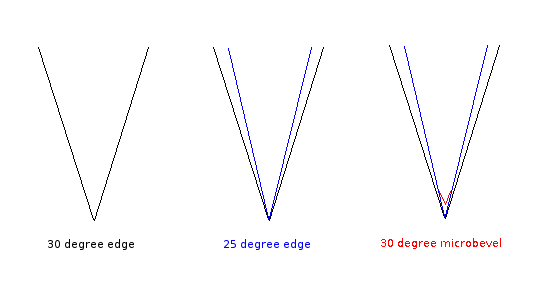

For clarification the science behind the primary bevel and microbevel would be this: You are reprofiling your blade using a very hard sharpening stone to the 12.5/side angle. Now the edge is a 25 inclusive angle from top to bottom. Now using a less coarse stone your sharpening the blade at a 15/side angle thus forming a microbevel , the primary bevel is left untouched because the less coarse stone is unable to affect work done by the very hard sharpening stone. Is that correct?

Kind of short on time here, but the tried-and-true method is to sharpen one side until you can feel a burr raised on the other side; the burr being a very fine, tiny strip of metal that gets bent over rather than removed when you've gotten to where you're sharpening all the way to the edge. You then sharpen the other side until you raise a burr on the first side ... that way, you know you've completely sharpened all the way to the edge on both sides.What are some methods for determining progress when re edging a blade, when do I stop? How do I know I got my 25 angle and can start on the microbevel?
Thanks again, Stretch, for taking the time to elaborate after I was being lazy/hurried. My only excuse (I thinkMan...we needed those drawings! That should be clear.
Dog of War is right when knowing "when to stop". However, if you're re-beveling from a 30 degree edge down to a 25 degree, for example, you don;t want to grind away at one side all at once. If you do that, grinding away until you get the burr, you will by that time have ground the blade way off center....
