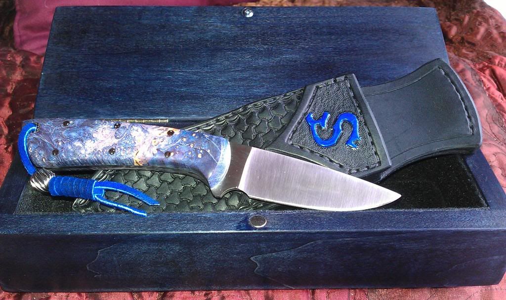

I made this box from poplar and dyed it with thinned out Fiebing's blue leather dye. Turned out really nice after a few coats of Formby's Tung Oil finish.

This is very true, and I meant to mention this earlier. This is especially problematic if you use a waterborne finsh. Additionally, steel wool is slightly oily, so not much of an issue for an oil or wax finish, but if you use a lacquer or waterborne finish, you can have issues. Good point, GrizzlyBear.
And nice work on the box and knife. Most leather dyes are alcohol soluble aniline dyes, of good quality. They usually work very well on most anything you want to dye.

That looks really cool GrizzlyBear.
