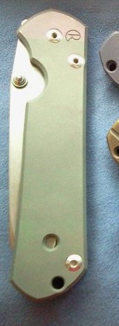

I can't really tell but was it the color green shown in this picture?
From what I read a setup that is able to run the needed 100 volts was close to $400.
100volts is the only place I know of that'll give green. It could be a few volts different but around there.
That one looks brighter because the surface is satin. Any voltage on a sandblasted piece will look darker than the same voltage on a satin/mirror finish piece.

Try cleaning it with windex to return it to all green if you want, on that shade of green oil from your hands will discolor it.
If you go a shade lighter or (maybe) darker it will change the wavelength you see and give you a more solid green that won't discolor from oil as much if you want that. It is hard to tell from a photo. The purple/green effect you have is very cool!
