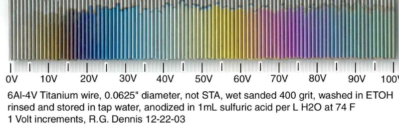

So ! I heat anodized a titanium CRKT M16 to a deep purple. If I want a two tone colour using electricity ( 9 volt batteries ) what would be the best result. Can I get light blues or is that voltage already "coated over".
What is the electricity equivalent of purple on the heat ? Has anyone tested this ? If I dont get any replies Ill post the results, I only have 6 batteries so my maximum voltage is 54 :grumpy:

From my limited understanding, I believe heat induced oxidation produces colors comparable to the lower half (ish) spectrum of colors produced by electro anodizing. IIRC, I got purples around the 15-20 volt range, and transitioned into blues with lighter blue coming around 30-35 volts. I seem to remember the voltage/color mix to be slightly different with CP Ti than 6Al4V. Keep in mind that alkaline battery voltages diminish quickly at first, then settle into a slow but steady drop, then begin to fall quickly again. If possible, I would check the voltage of your system before applying it. Here's a general idea of the colors you could expect in different voltage ranges:

How did you do that? It looks cush
The top photo was a blow torch on a strip of grade 5 ti
The bottom one is electrochemical anodising :)
