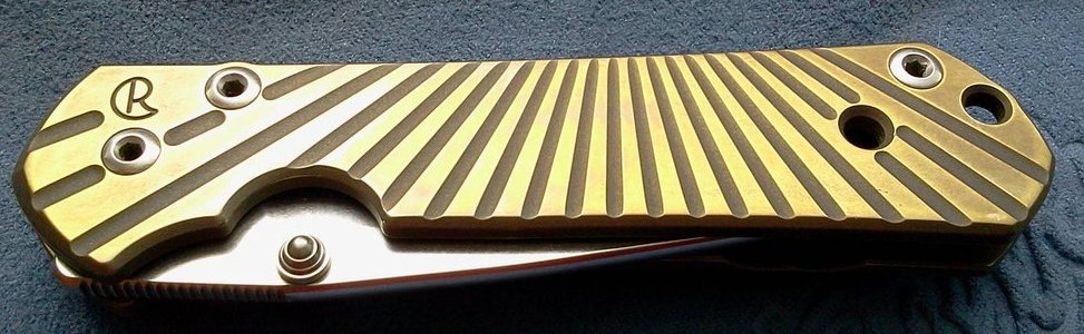

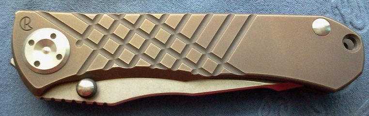

This is gorgeous!!! I want to do one like this, what did you do to achieve this?!?!
I thought this was done by application of a butane torch. Perhaps you're using a battery and some stuff from Brownell's?
Interesting and very nicely done.

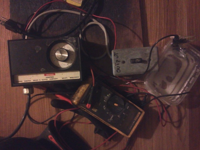

How do you attach the alligator clip to the Ti handle without the clip going into the solution? Did you use baking soda/water? I've seen a few how to videos but none are very good...
Yep, baking soda and water
To get past the problem of not having the gator clip in the water, I'll do maybe like 90% of the titanium submerged (% doesn't really matter as long as it's more than half), then flip it over and do the rest. As long as the current stays the same (and it does if you don't touch the dial), it'll all end up the same color. For the other one, I take a longer piece of aluminum foil with some sticking in the water and some out, attach the clip to the part outside, then clothespin the foil in place.
Awesome! I'm going to give it a try! What's best voltage for a deep bronze? I've seen some charts but your experience is best!!!

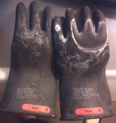

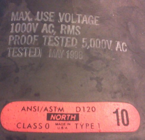

Wow, I love that WC. I'd like to do that with mine but I would probably electrocute myself.
