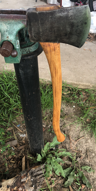

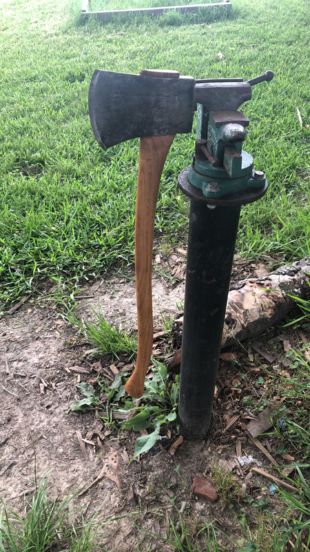

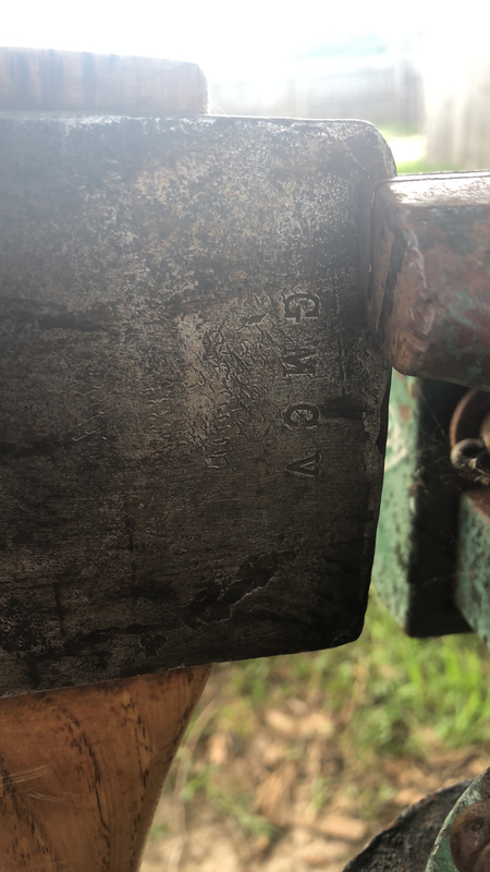

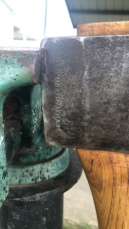

I have a Connie with Superior Cast Steel as the only markings. I’ve read the could be a AATCO or Rogers but I am not sure. Any suggestions would be greatly appreciated. Will post photos below
What pattern is it? When you try to identify an axe, post as many as possible pictures from different angles. Sometimes shape of the poll, or shape of bevels can help with identification.
I doubt that it is Rogers
Not likely, but possible: Daniel Simmons & Co
Robert Mann
William Mann
less likely than other Manns: James H Mann
First impression seeing full axe and bevels: METCo Connecticut. Top down picture, showing shape of the poll, weld in front of the eye is always helpful, too.
Are there any alphanumeric marks on the poll?
