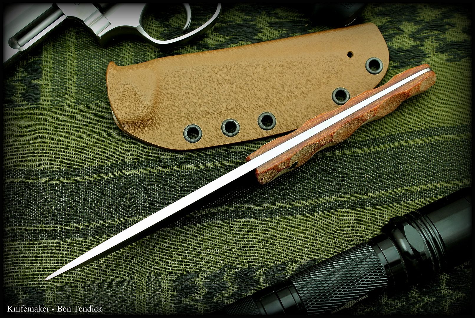

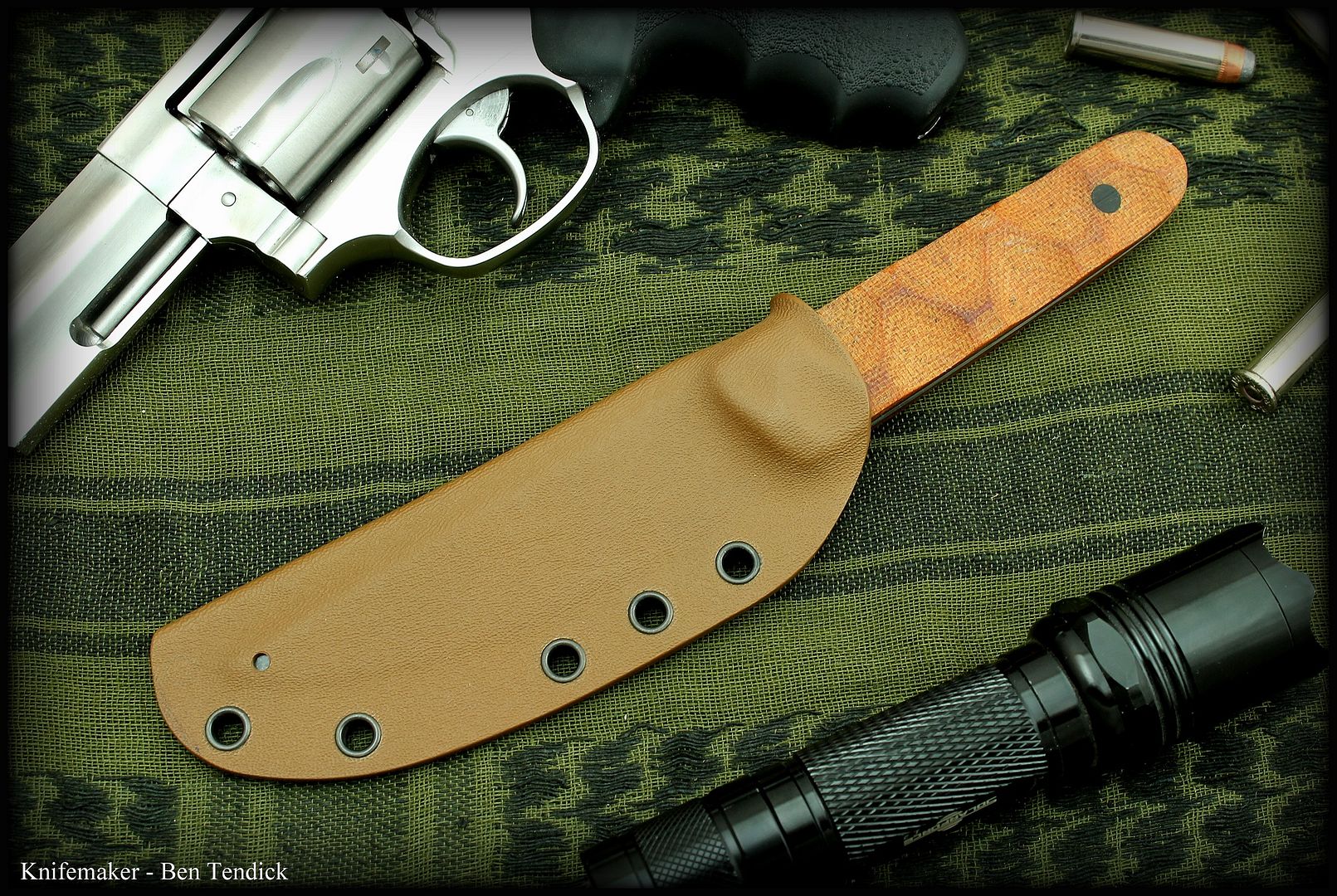

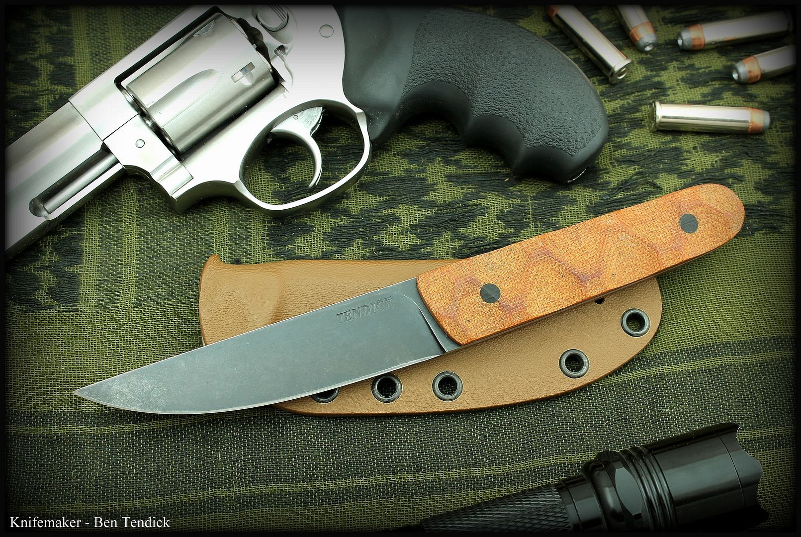

I just finished up another one of my, all business, BDU Kwaikens. This one is done with a dark stonewashed finish and contrasting natural canvas micarta. The tang is tapered and the pins are carbon fiber for a very light and balance tool. The kydex is setup to run a large Tek Lok, Molle lok or various other options. It is full flat ground on both sides for very sharp edge and fine point. The handle is scalloped for excellent grip, but is smoothed for comfort as well.
Any comments are welcome!
Thanks Rolf! This one is basically how yours will look, only chisel ground obviously. ;)
I'm not usually much for kwaikens, but that is a nice piece there. I'm a fan of tapered tangs.
That looks to be the ultimate EDC fixed blade. Perhaps I'll be able to order one in the next few months...
I just received my kwaiken. Not only is the knife gorgeous, it fits my hand like a glove.
Thank you Ben, for a PERECT edc fixed blade.
Mine is just like the pix but it has a 3.5" chisel ground blade.
