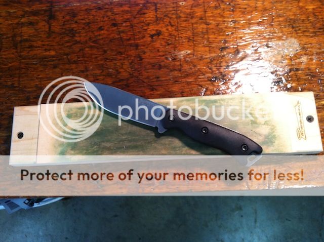

I prefer my blades naked so I had her strip:

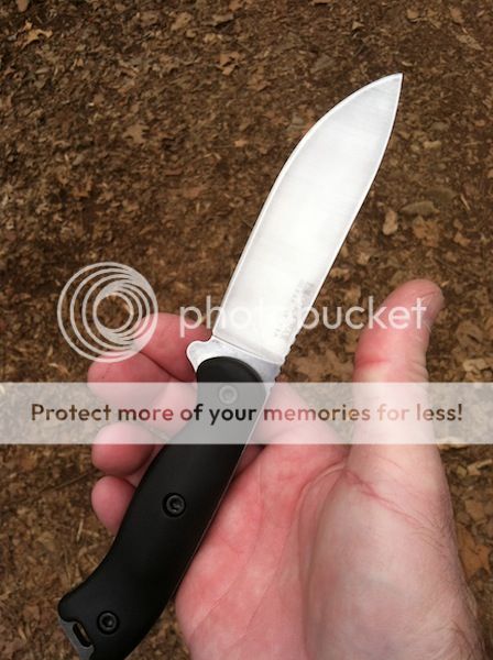

I used some 400 then 600 grit wet/dry paper on her to shine her up a wee bit then took my belt sander and cleaned up the tooling marks on the spine forward of the handle. Might do the rest later, might not.

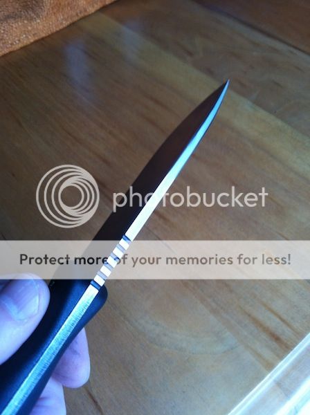

Then it was edge time! Previously I had never gotten a knife 'hair popping' sharp before, but this one is!
A strop is one my best recent purchases.

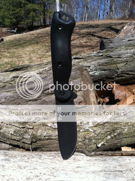

I just need to make a leather sheath for her and I will be good to go! Blade will go with me anytime I'm in the George Washington National Forest hiking or motorcycling (probably not mountain biking).

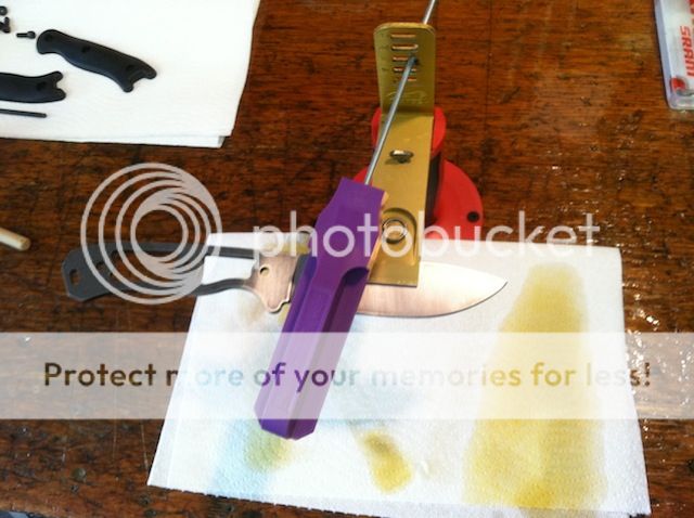

What sharpener is that? Sort of like a Lansky?

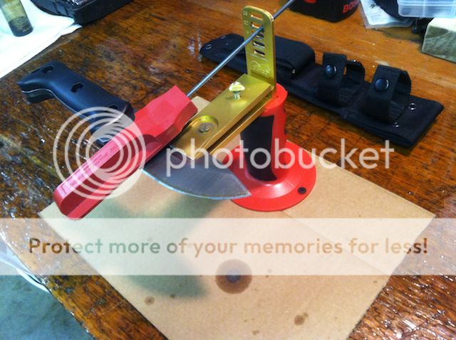

It's a Gatco, same concept as a Lansky. I have I think 5 oil stones with it down to an ultra-fine one, I think it works very well. Can even handle a BK2 without slipping (or stripping).
One tip for using this type of sharpener.....I like to make sure I am able to reliably repeat an edge and angle that I put on a blade on subsequent sharpenings, this means placing each blade back in the holder the same way each time. I take pictures and keep them in my phone as a reference. With this I can see the depth and placement I used last time. Like so:
