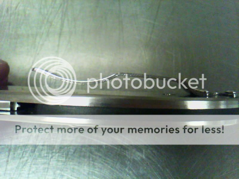

I know there have been many instances where Spyderco users have bent their Spydie clips while carrying them.
Well tonight I had bent a clip for the first time. This thread is not to knock their clips or to judge quality. It was an accident that many here have faced. Simply walked through a swinging door and it snagged the clip and really bent the clip out.
Have to say I was really upset when it happened, because the Lum is my newest Spydie! I believe I have previously read that someone had bent their Lum clip.

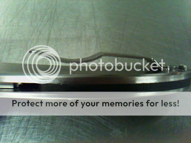

Anyhow 5minutes with the BM Torx Kit and P4 Squirt the clip is as good as new and back in the pocket. :thumbup:

i think you can still bend it back further. if i was in your situation i would use a vise.

When I spring a clip, I adjust it in a vise clamping the drilled end and bending the tongue with my fingers. I adjust the gap to suit the thickness of the fabric that the clip is grabbing.
While the clip is off the knife, I check the underside for drag burrs that are formed in the blanking process. If burrs are present, I remove them with a small file. I sometimes check the burr situation on new knives to prevent premature pocket wear. An unfinished clip edge is like a buzzsaw.
