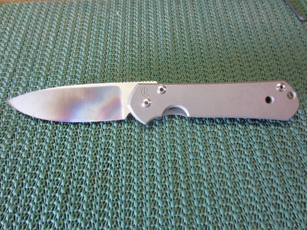

I've long wanted a Regular blade on a Classic or 21 handle scale, so i gave it a shot.
This is a Small 21 handle. I made this blade something like the shape of the large Regular blade.

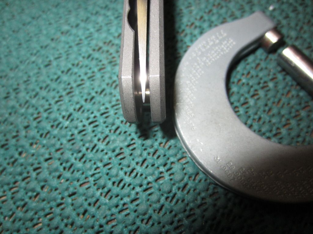

I did not achieve the precision of a CRK of course, but it works pretty well. It's a flat grind, I've got the shoulder thickness to .015" at the edge, it should be a slicer.:) Needs more work, but nearly there.

I don't plan on making another, but wish CRK would make a Drop Point blade on a bushed pivot again.

about as good as it's going to get
Thank You!
No stud!
To open, using the Skellern method. Thumb on the jimping, then round (arc) motion.
Used D2 as blade material, I like the the really sharp edge I get on D2 and it keeps that keen edge a decent amount of time. I like it better than S30V or 35VN for that reason.
I really like that. I would love to see it with just a nail nick, no stud. Great work all around.

Joking aside, that looks great! I really like the high shoulders of the grind. I wonder how the same blade would look with a sweeping plunge line.

I like it. A drop point is my favorite blade... You did a very nice job on it
