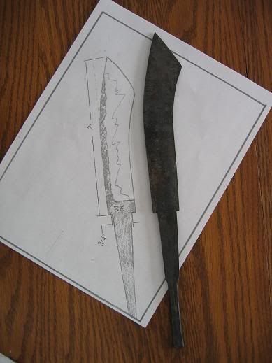

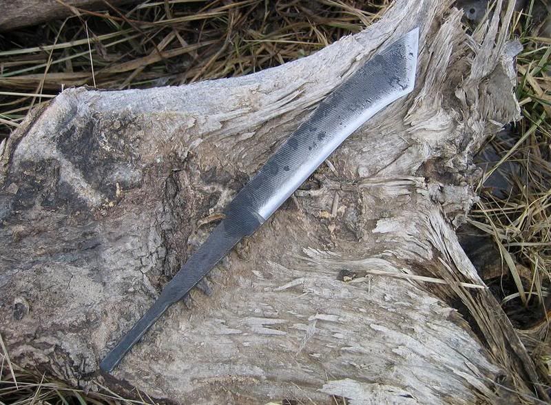

Forged from a Nicholson (flat bastard file) This one is still in progress... I will call it the "Bush Bastard".
Rick
Just after forging.....
Setting the bevels and getting ready for heat treat...

Unique to say the least. I'm looking forward to the finished product. What kind of handle do you have in mind? My guess is that, that "point" on the sweet spot is going to bite deep but wedge a bit in wood, but it will also be easy to rock out. I sure wouldn't want to take a hit from that upside the head! Mac

I just drew it up one day... but I guess the Rambo #4 knife must have been in the back of my mind somewhere, cause if the edge was on the other side it would be #4's little brother!
That and it kinda has a "sawed-off" Khukri kinda look to it.

Looks cool. I can't really tell from the sketch but do you intend for it to look like the Puma hunter? Cuz I think thats a sweet knife.
Not trying to start trouble, but exactly what are the reasons for that edge and point design? :confused:

I wanted a forward heavy design for taking saplings and light chopping. The secondary point (no idea what you call it) is great for pull cuts and really bites in on the push cuts. The tanto-like tip is good for gouging out bowls and spoons, too. This is definately a shelter making "bastard"... perhaps not the best hunter/skinner... lol.

One question: I've heard people say that it's important to grind out the ridges on a file early on in the knifemaking process, lest one weaken the blade. Any truth to this?
One more question: how do you plan to do the heat treatment / tempering?

Years ago, I got a neighbor friend who worked at a large plant to get me their used files for some homebrew wood chisels. They even used a plane surface grinder to remove the grooves - great! I then ground the rough skew angle with a die grinder mounted stone, wrapped it in a cloth, held it in a vise, and whacked it on the grind, shattering it like glass - cool, I thought. I shaped the edge and sharpened it on a 1"x42" belt grinder, down to 320 grit SiC - nice edge - finished it on stones to shaving sharpness - yippee, I thought. I didn't know about the micro-cracks I had produced - and how, even with the minimal shock of chiseling wood (I made a few mortise chisels for myself and my neighbor.), they might connect - and I'd lose a hunk of the edge - which I did - stuck in a mortise - fun to extract. The neighbor came back with one with a big piece missing. We both agreed - we weren't metallurgists. Ford was President... I found some clearance priced Japaneese laminated mortisers at a local shop.
You have to anneal the snot out of file blanks - then shape them and remove those grooves - then reharden the blank before finishing it... but you have a forge, so you know and do this. My hat's off to you - great job - neat design. Traditional wood handle, or dymondwood/micarta? That short tang may be a problem. I am anxious to see the results.

I normally make full tang knives but this one is a colaboration knife I'm making with two other makers. One gentleman is making the handle and the other is making the sheath.... we will hold a lottery... the winner gets the knife and a select charity gets the money...
I will be making another one with a full tang for my own line-up.
After forging, I heat it up and let it anneal in the forge overnight.
I had originally intended to heat treat with a clay coating to get a nice Hamon... but I think I'll full harden and temper back the spine.
