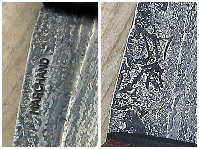

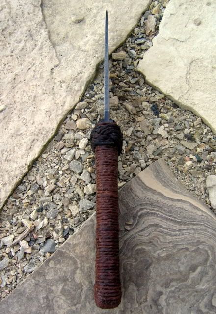

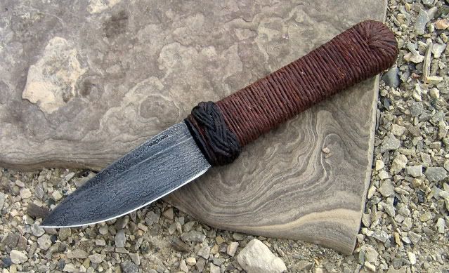

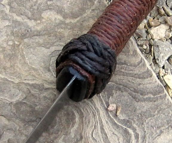

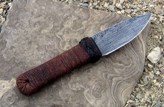

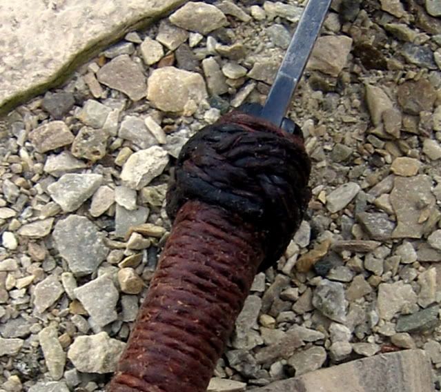

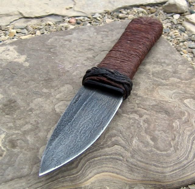

Bushknife Asymmetrical
5160 Hand forged
5/32" spine at ricasso
Distal taper to 1/8" at tip and butt of tang
9" OA length
4" blade
5" handle
Full tang
1 3/8" wide blade
Handle is leather backed, hemp wrapped and epoxy soaked
Thanks for looking.
Rick
Thats a beauty Rick! If I had money thats the 1 I would order!
I am taking knife donations incase you were wondering... ;)
I really like that. Looks like a very tactile, comfortable handle as well. Very nicely done.
great looking piece Rick...I'll wager the ergos and utility are second to none.
ps. I'm enjoying the heck out of your/my large bushknife.
