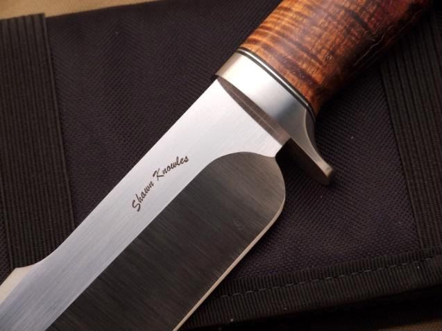

Here's another camp knife I did for another forum member. I really like the way this one came together. Let me know what you think, and thanks for lookin'.
Shawn
Specs are:
Steel: CPM 3v
Overall lenghth: 13 1/2"
Blade: 8 1/4" long, 1 3/4" wide at widest, .27 Thick
Handle: 5 1/4" Nice piece of curly Koa
Guard: 416 SS
Pic of My makers mark just for fun.

You did an outstanding job, Shawn!
Just when I think I'm gettin better, I see stuff like this and realize how far I have to go. That thing is very clean.

This showed up yesterday and I'm floored by the design and the execution. It's a flat saber grind on a blade that's more than 1/4" thick, and yet the bevel brings it down to a very reasonable thickness behind the cutting edge, and the point'll pick splinters! The high peak out front for the swedge shifts the weight forward, and with the hand pulled all the way back on the handle it has a lot of heft in a swing, closer to most 9" and 10" bowies. Grinds are PERFECT.
