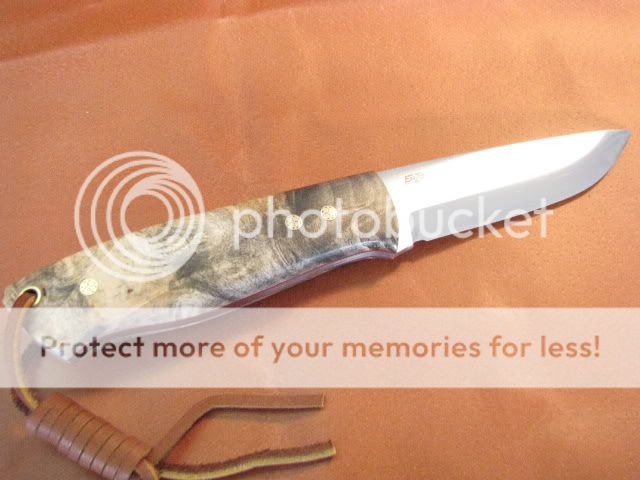

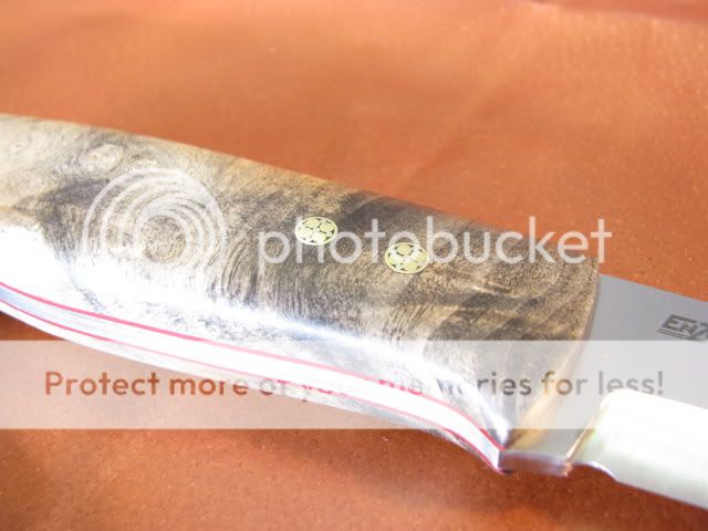

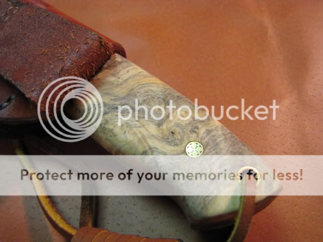

Here is another EnZo Trapper in Buckeye Burl. I made a mistake on this one and ended up with three pins instead of two. I like it better this way!
I've got this one sharp! It will pop hairs (treetop) right out of the sheath, even after several sheathings/unsheathings.

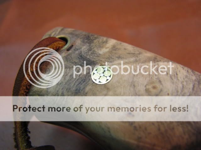

Something I've learned about buckeye burl: it's a relatively soft wood, so when I'm grinding the pins flush or shaping the scales, I have to slow down quite a bit. The pins will get so hot they'll burn the wood, even deep down inside. If you look at the second picture in post#2, that rear backside pin has a dark "rim" around its circumference. It's not eyecatching, but its there nonetheless, and I loathe any gaps or rings around the pins. Well, that was a pin that burned down deep, so even when most of the scale slab had been sanded away, the "burn ring" remained. On the sander it's not so bad, but that pin was extra-long after the glueup, and I used the grinder to bring it down close to flush. Bad mistake. Good oppurtunity for learning. :D
