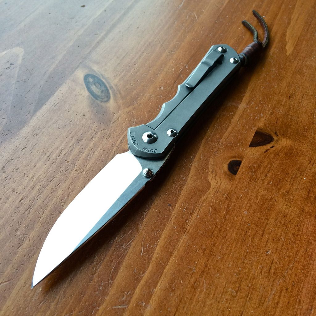

Inspired 100% by this thread from dweglarz13: http://www.bladeforums.com/forums/showthread.php/1360494-modded-my-sebenza-25-clip-pics?highlight=25+pocket+clip , I set about making my own mod to correct what I percieve (my opinion only) as one of the biggest design mistakes CRK ever let slide. I think their decision to apply the defacto standard CRK pocket clip to the Sebenza 25 has held the model back. In my own experience the annoyance factor of the clip has kept me from ever really liking the knife as much as I might have otherwise (again, just my take on things).
I went on a rant here: http://www.bladeforums.com/forums/showthread.php/1157256-25-Pocket-Clip-I-agree-with-the-haters which sums up my case against the 25 clip placement (yes there were sleepless nights, loss of appetite, and cold sweats :D). I also feel CRK is somewhat aware of this issue, hence the angled clip on the Inkosi.
So fast-forward to today. I really enjoyed Steel Addiction's post about his long term carry of his 25: http://www.bladeforums.com/forums/showthread.php/1163430-Sebenza-25-**Update**-from-Last-June-2013?p=15781843#post15781843 and noticed he was running clipless. Clearly the knife is a great knife to foster 3 years of loyalty, but what of that clip? I have tried to like the 25 clipless, but the knife seems not to sit nice loose in my pocket. I want it clipped!

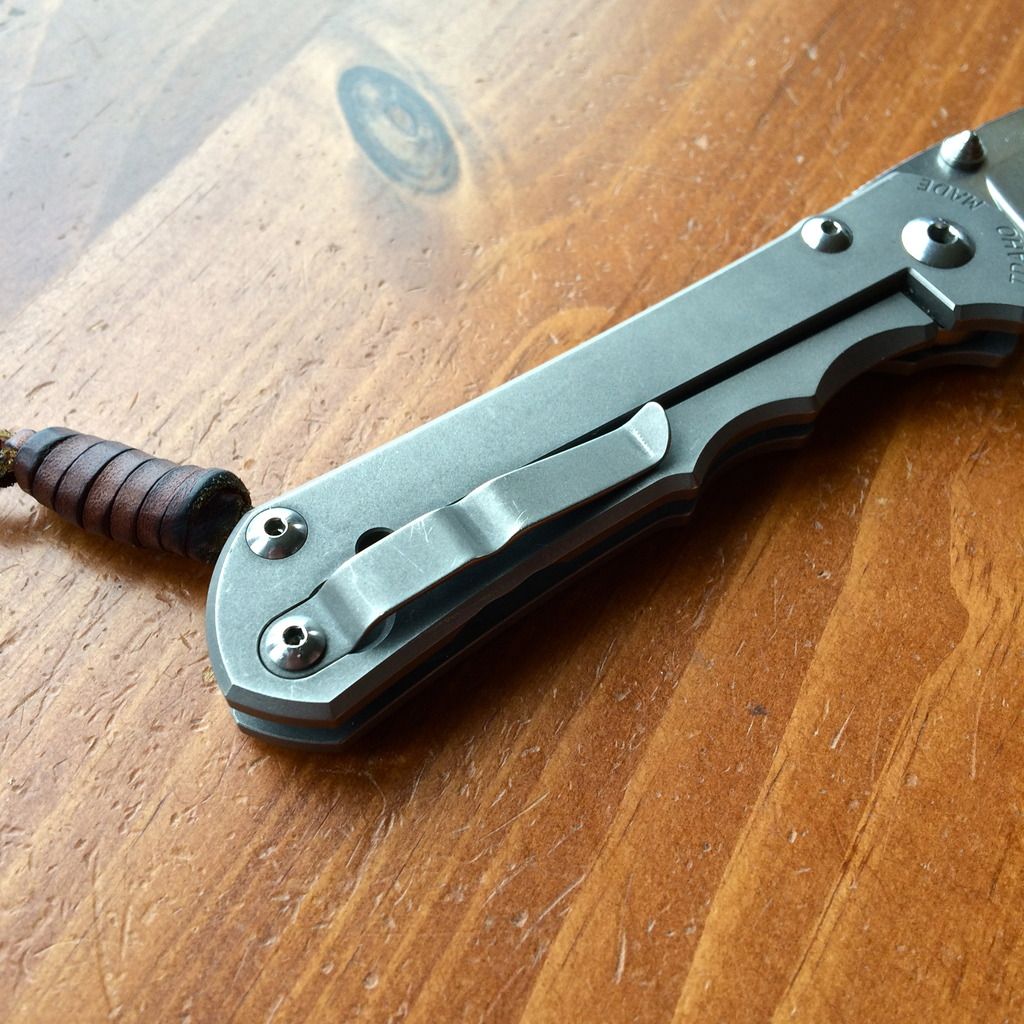

Taking the cue for dweglarz, I completed my own mod. I went for something asymmetric similar to Brad Southard's design on the Spyderco Southard Flipper clip. I sawed off the end with a dremel cut-off wheel, and refined the edge with the flat of the cut-off wheel and a Dremel fine rubberized stone wheel, then did some final touch ups with a loaded strop.
Things to know about the result of this mod:
1 - Be warned!! The original CRK pocket clip is absolutely perfect - this mod does nothing to improve the clip, it just makes the knife better in hand (which to me is more important - YMMV).
2 - Although the modded clip is arguably more "pokey", it is pokey in a place where there is nothing to poke.
3 - A very steep tip angle is required for the modded clip to still slip over the thick double-crease of some jeans. If you bend the clip tip to where it 'looks right', it will catch on jeans, you must bend it more. It really needs a fairly steep angle if you want to use it one-handed, with jeans.
4 - It helps to take some overall spring-tension out of the clip, so it is easier for it to slip over the lip of the pocket
5 - Start by removing just a little material and testing. You can always cut off more, but can't go the other way. Be patient and prototype.
6 - If you do this mod, and hate it, you can always buy a new clip for $15
Here are some pics of the finished product:

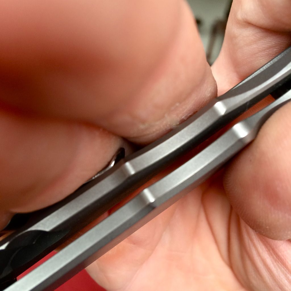

The picture below shows the clip "BEFORE" mods (note clip digs into middle finger).

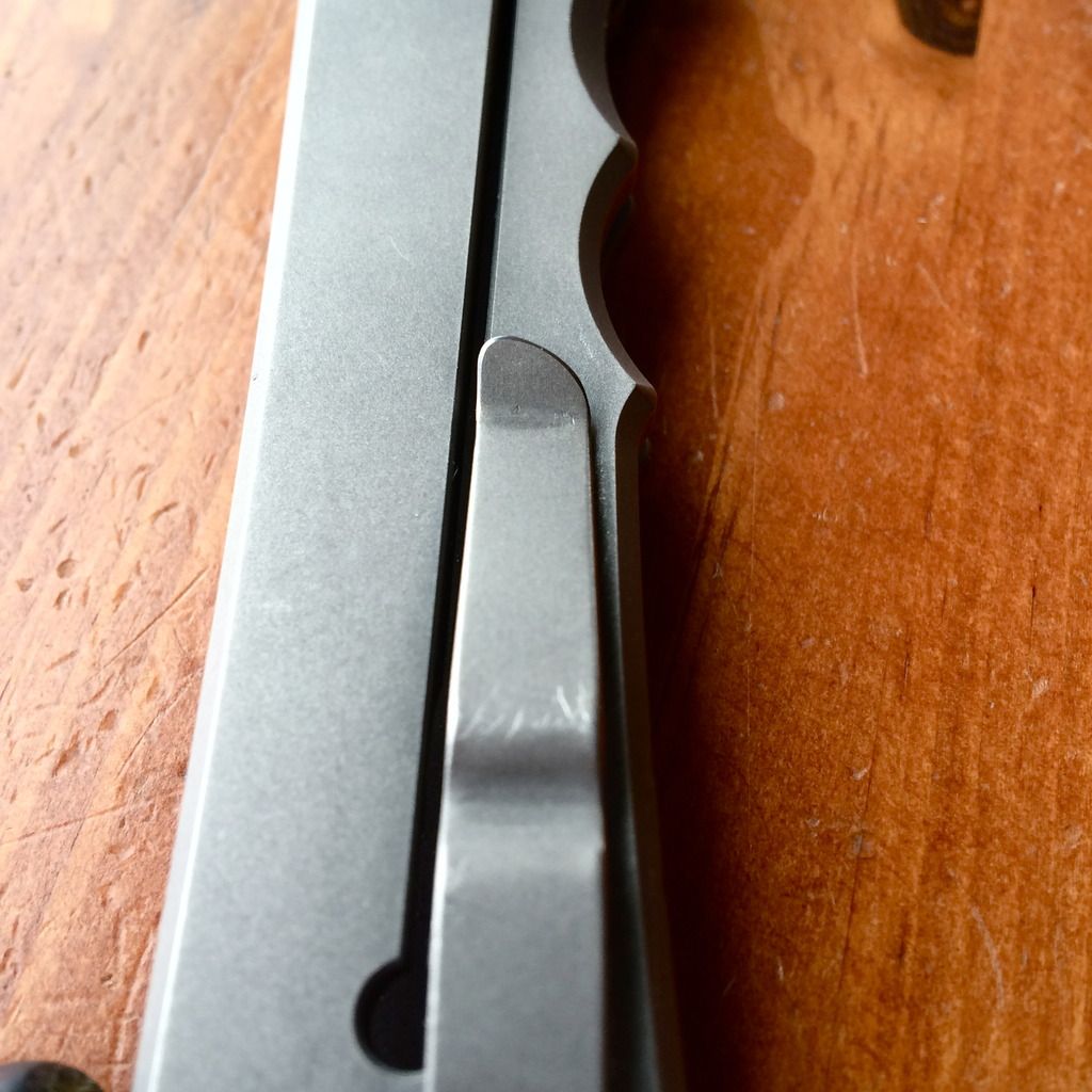

This picture shows the clip "AFTER" mods (note new 'pokey' clip is clear of both fingers).

Did you flatten the factory bend and make a new shorter bend?
Why didn't you try to crest the new bend so it wouldn't be so pointy?

AJack, No, I didn't make a new bend. I only removed material and adjusted angle. I didn't want to go too deep as I don't have a lot of experience with Ti. I agree a complete re-make of the original clip tip, by rebending a clip, would be a better solution, but I wasn't sure if I could achieve that and not make a mess. I may still try that someday with a different/newly purchased clip. You would have to take the old bend out first, to have enough material to form the new tip. That's the part that makes me nervous.
I was inspired by dweglarz, so hadn't thought a mod might work previously. So far I am happy with the mod. I may take it to the next level someday, but the good news is I am carrying a 25, and that's worth it.

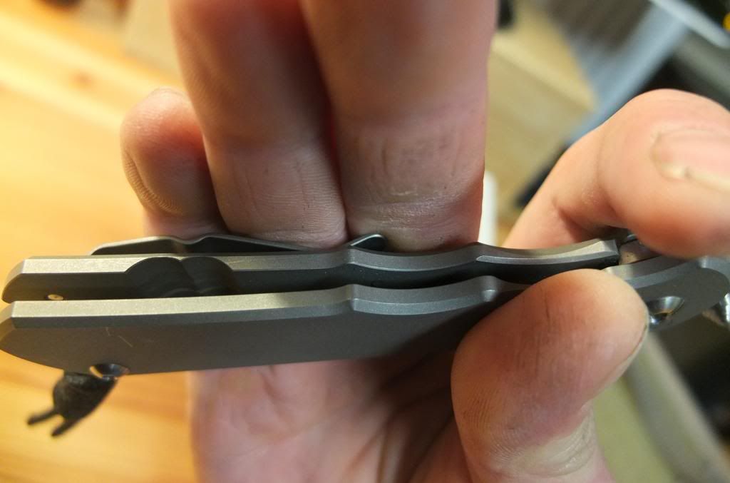

On the 21s and Umnumzaans, this is not a problem, as your hand is free to shift left or right, and the clip tip falls between your fingers. There's some good photos of what I mean in the "Haters Rant" I shared in my OP above. The 25 is only an issue (for me) because your hand is forced into a certain grip by the finger choils/grooves on the slabs. My complaint, as also expressed by quite a few other forum members over time, is that the 25 should have a different clip to place the clip tip between your fingers, rather than halfway into the meat of one of them. The mod discussed here is a desperate CRK fans attempt to fix the issue for oneself.
A great experiment for you, Vaporstang, is to take the clip off your 25 and feel it in hand. You will likely be impressed with the improvement. Then slip the clip, loose, under your fingers to the point where it disappears and is not annoying. You will find that the tip is now between your fingers, but the clip screw tab is hanging off the end of the knife. At this point you will become extremely frustrated because you'll want that great comfy feeling, but won't be able to fit the clip permanently in this location. Your next choice it to scream loudly at the sky "God grant us a shorty 25 pocket clip", or if you are not a religious person, you fire up the Dremel tool and take care of business as best you can.
