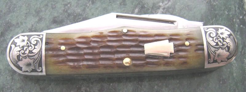

Yvsa, The back ground is treated with some checkering and stippling, which lightly lowers the level compared to the foreground. Then, it is blackened with printers ink. The fine shade lines hold the ink also. On steel, you don't alwayy need to add the ink, and I prefer not to usually, but the nickel silver is so soft, it doesn't darken as much just with the stippling alone. Also, many folks expect the ink on knife engraving.
I hope to do a couple of knives soon that have stainless bolsters, and we will see how they look without the ink. It makes for a softer grayer look that looks god with the warmth of wooden handle material. On some knives with synthetic handles, the black ink provides a starker contrast that works well.
I'll be glad to answer any more questions if that didn't explain everything.
