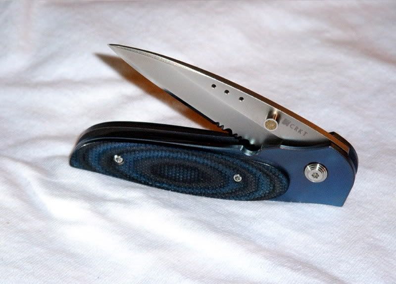

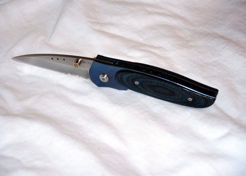

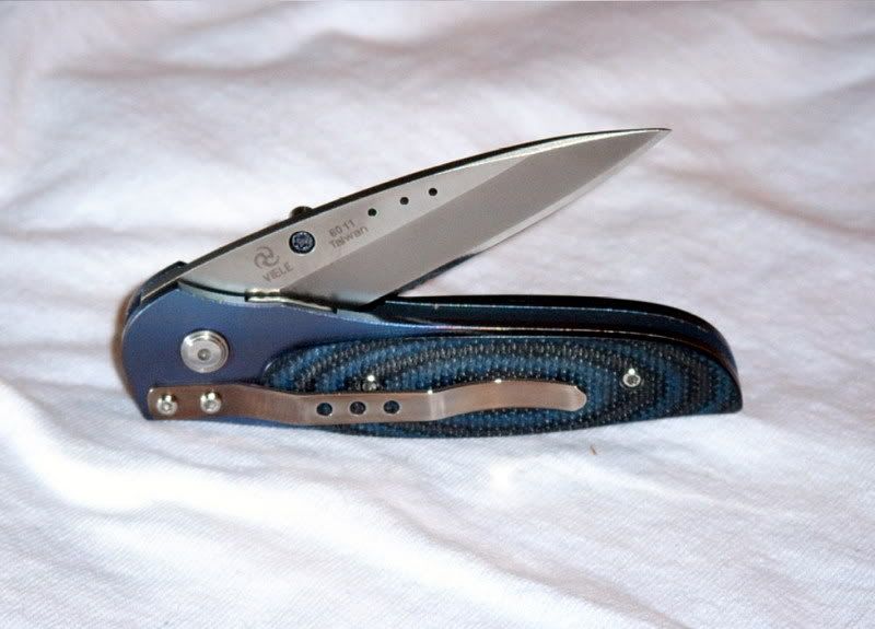

I also did some simple filework on the little backspine (plastic) , polished the lock and all torx screws , took out the rubber nib from the thumbstud and filled it brass dust mixed with superglue , sanded that down even and polshed it , then polished the pivots and heat colored the thumbstud screw and pocket clip and used a bit of flitz on the G10 which made the blue/black/grey stand apart more , also I filed down the obnoxiously big pivot screws and polished those , also gently sanded the G10 before polishing to make the knife more 'pocket friendly'. The final touch before re-assembly was a judiscious polishing of the blade.
The final result is a much more appealing knife.
A final note. This knife was regularly priced at a ridiculously high $120.00 !!
I mentioned that to the store guy and he just shrugged but honestly I cannot see the justification for selling this knife over $40.00 - the Steel AUS118 is good and the handles are solid titanium but otherwise I dont see the high cost. Anyways....
Sound off ! let me know what you think about this job - Dont be shy.
