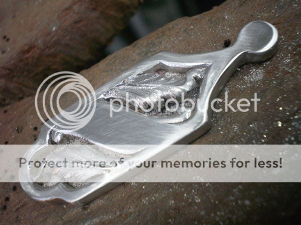

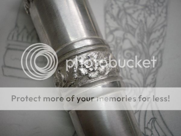

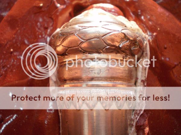

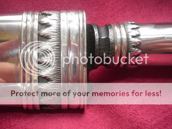

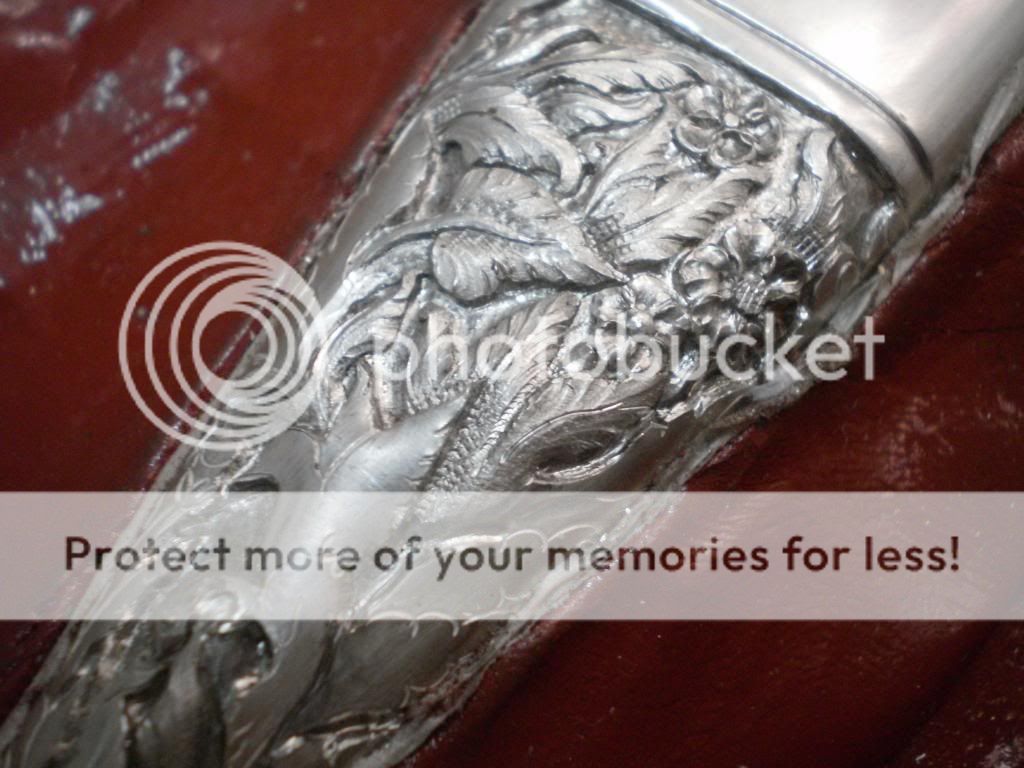

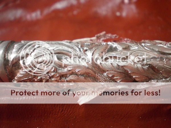

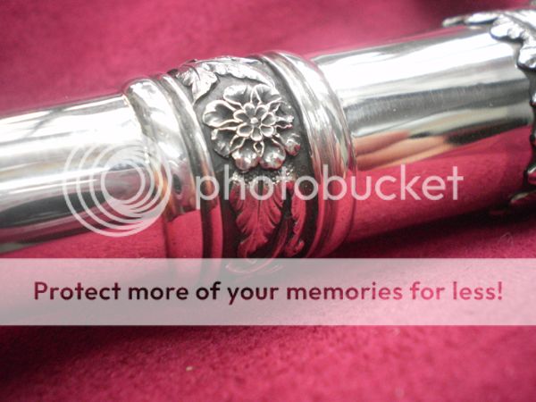

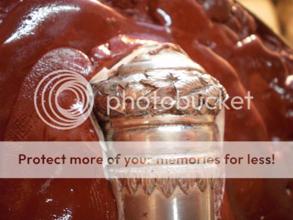

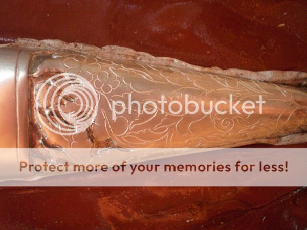

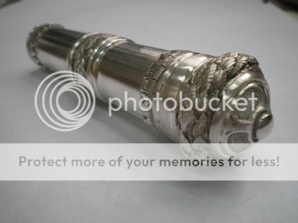

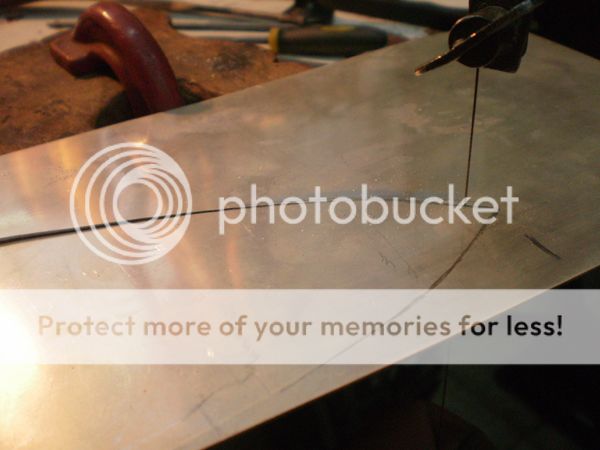

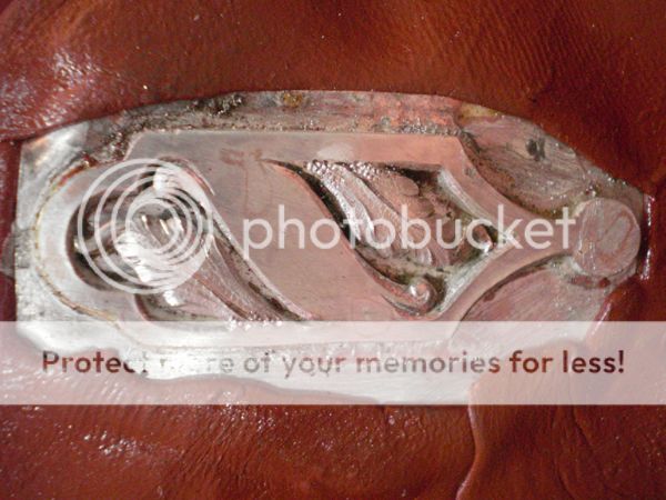

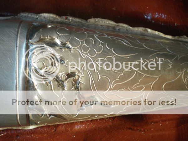

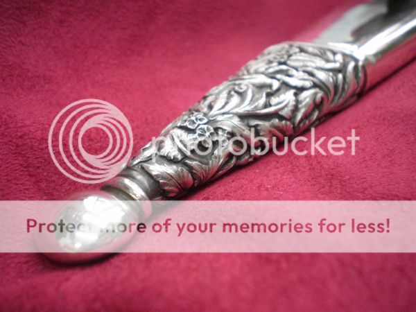

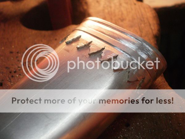

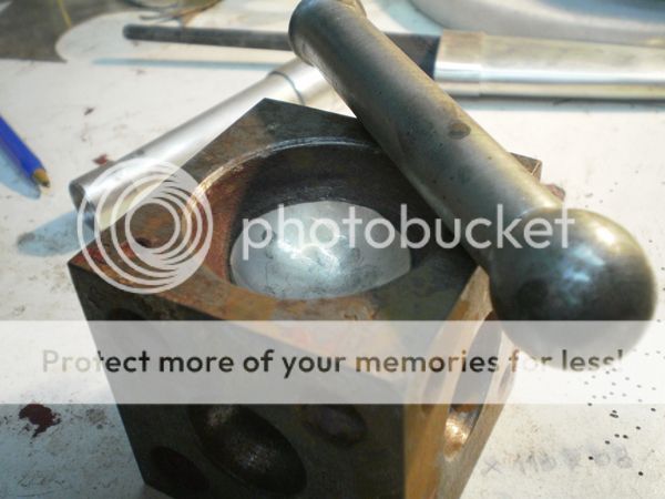

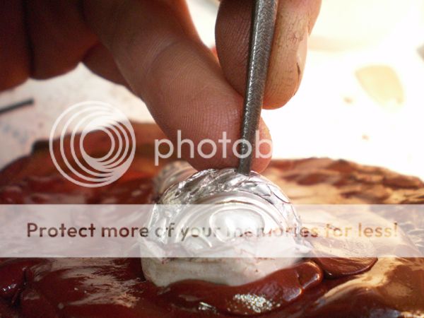

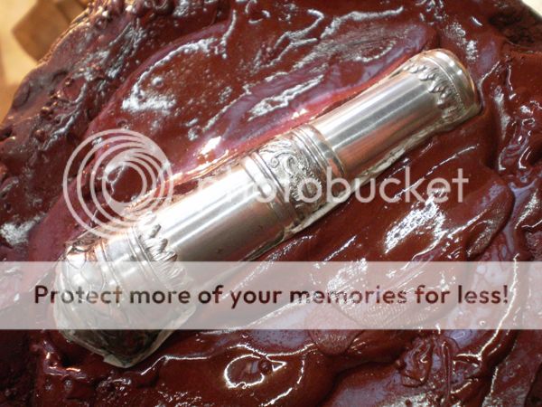

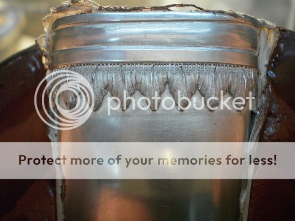

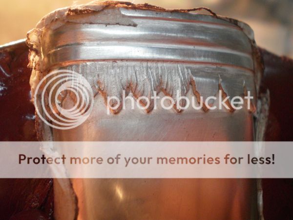

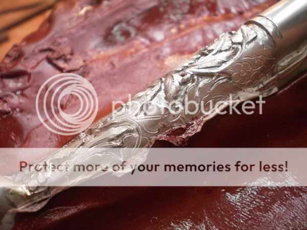

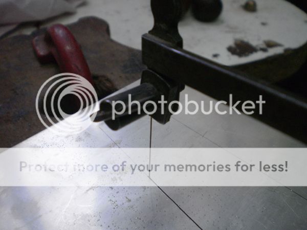

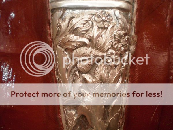

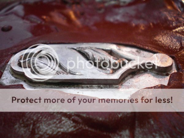

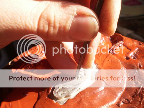

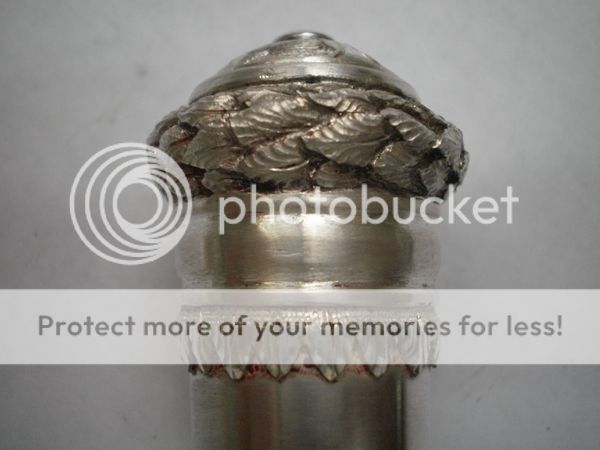

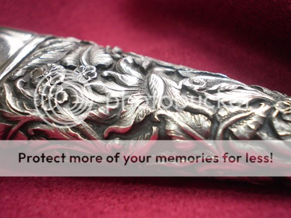

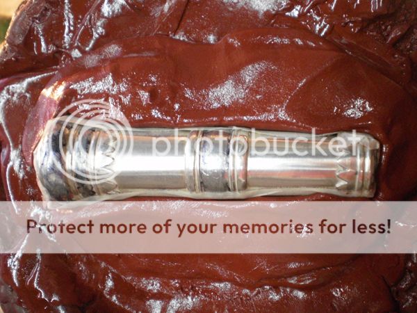

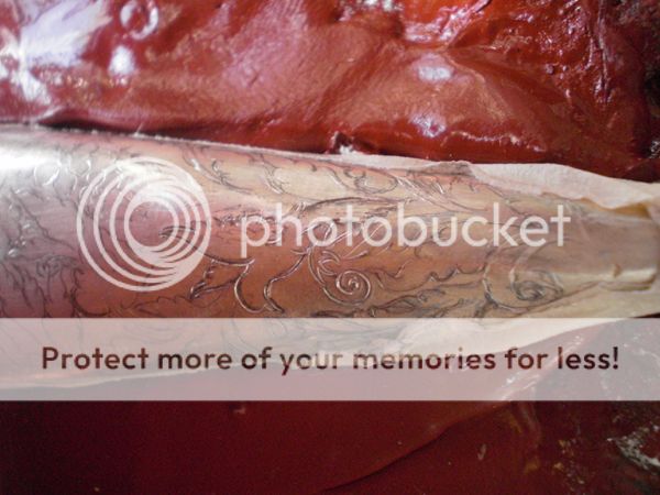

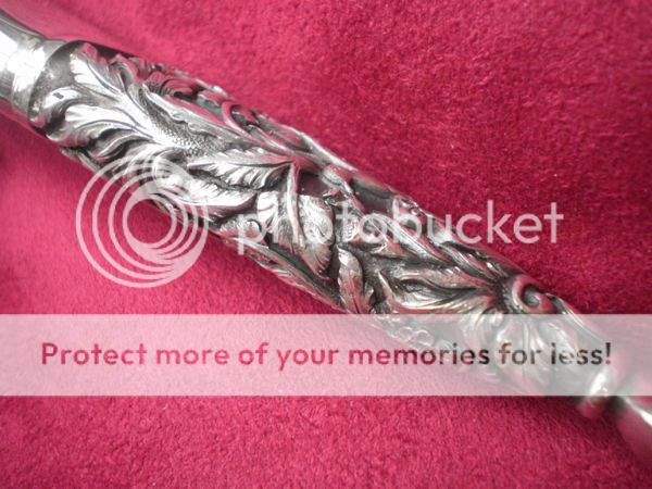

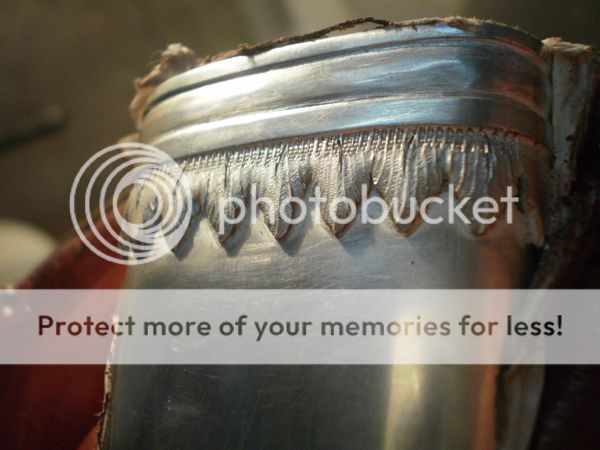

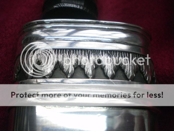

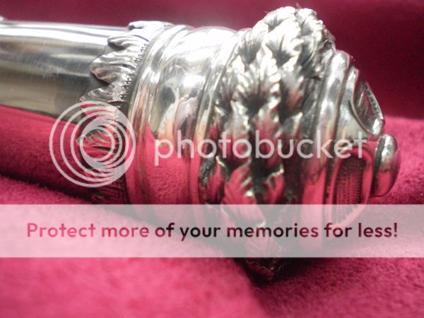

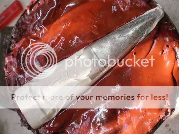

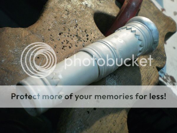

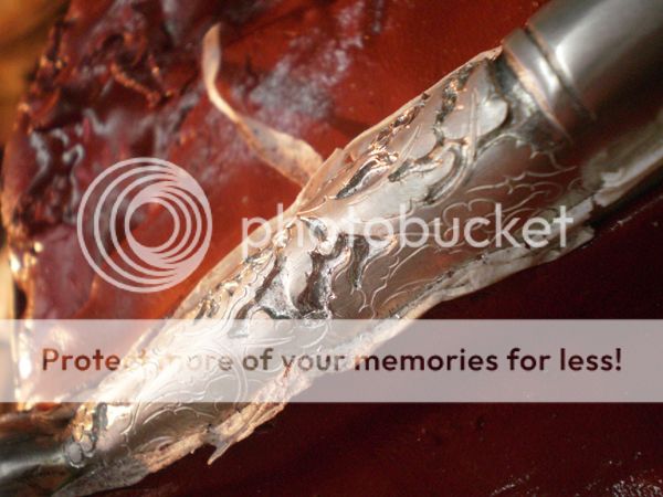

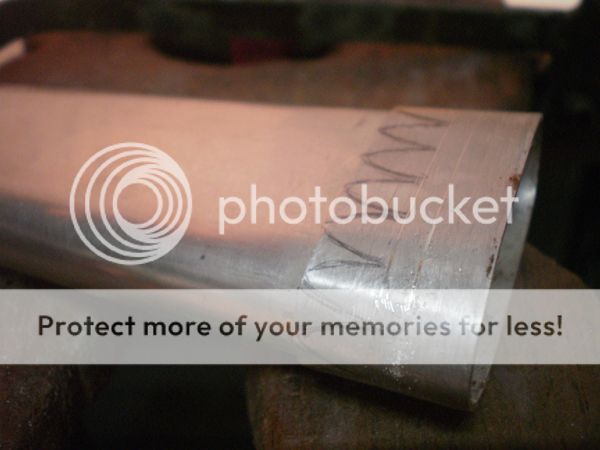

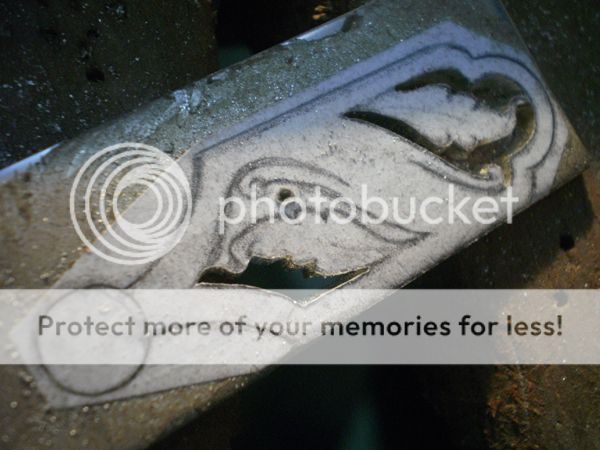

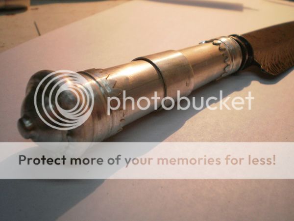

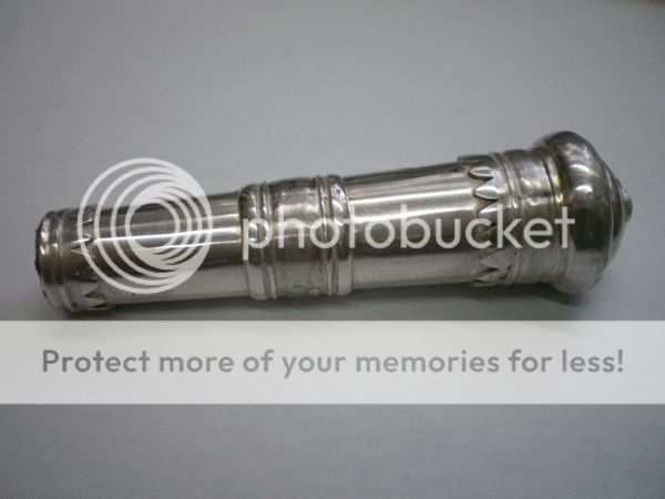

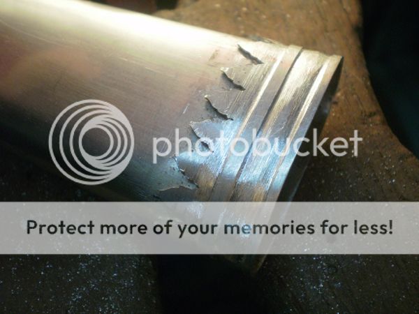

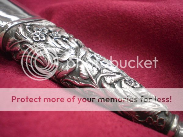

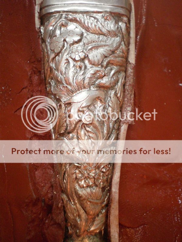

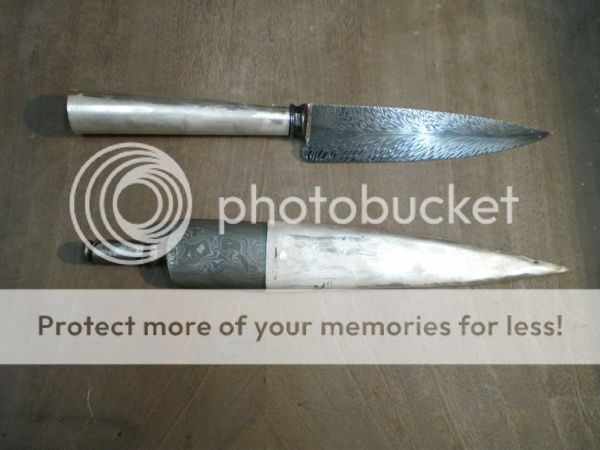

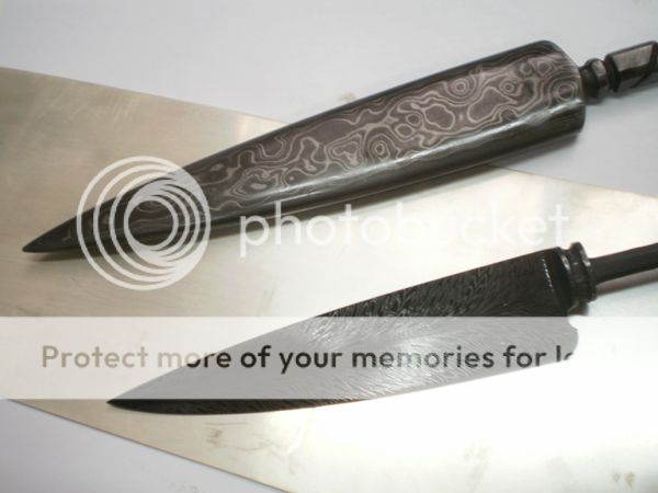

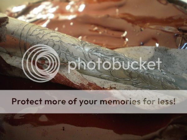

Another Luis Chavez WIP. Chased silver verijero, feather damascus.
Nov 14, 2006
414

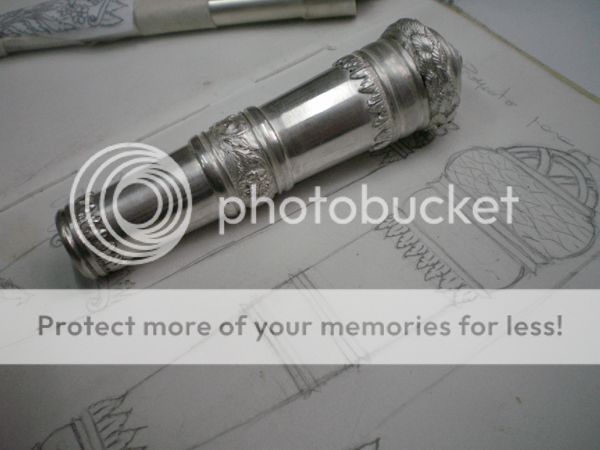

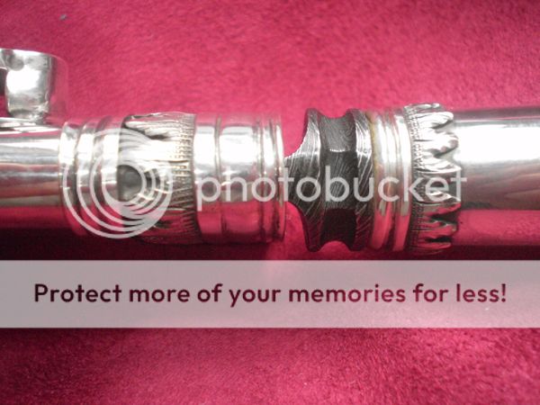

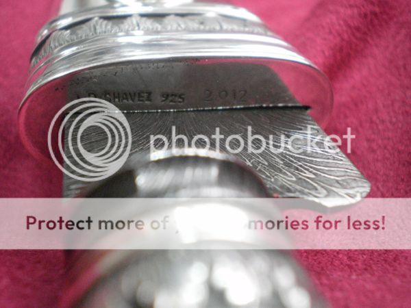

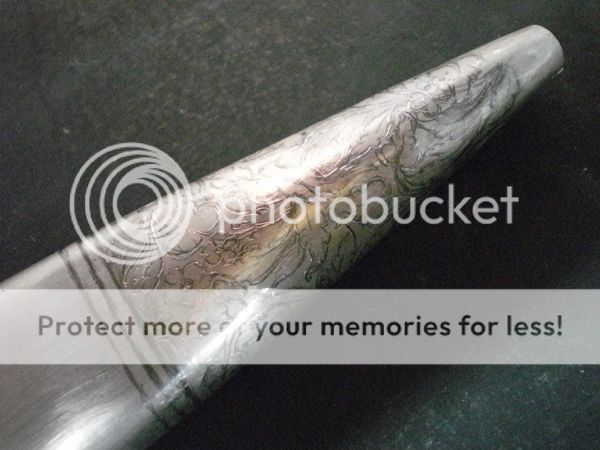

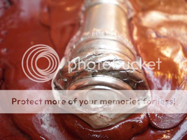

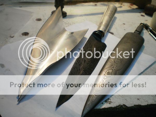

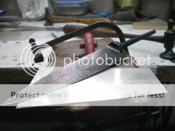

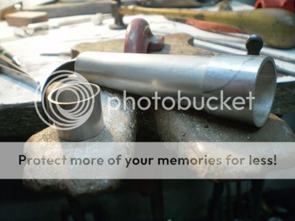

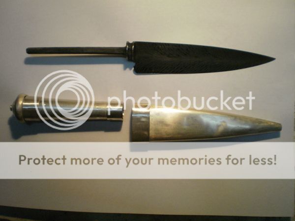

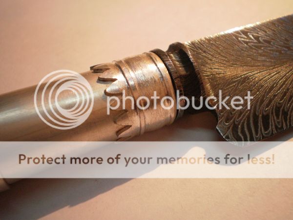

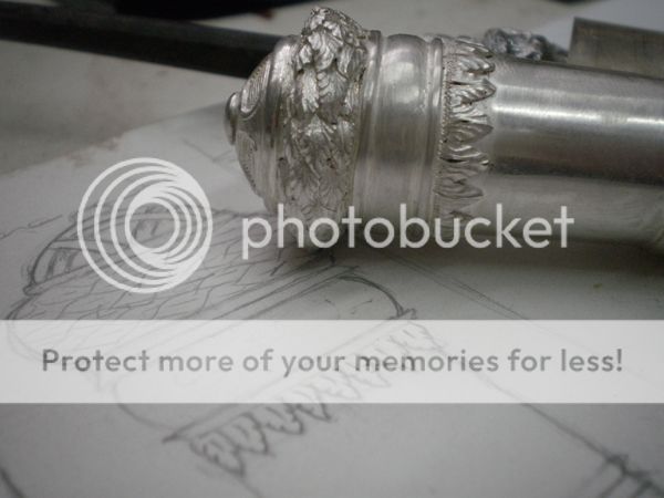

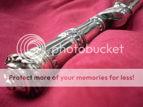

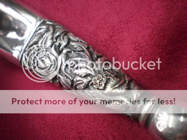

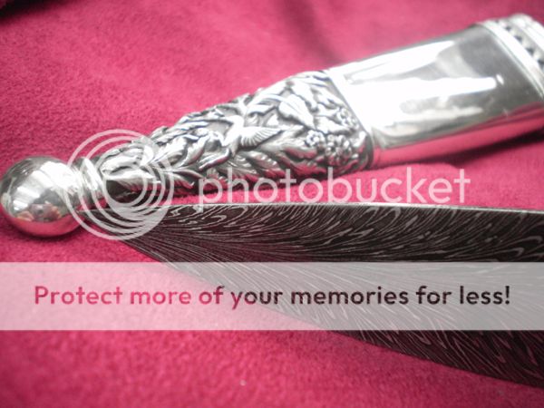

Good day to all.
I have another WIP made by Luis Chavez that I would like to show you.
Blade was made also by Mauricio Daletzky.
Truly incredible work. Thankyou for posting this. It's not very often we are fortunate enough to see the detail and work involved in creating such works of art.

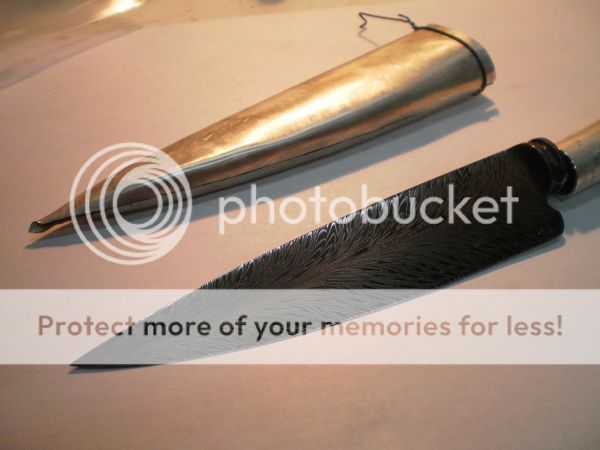

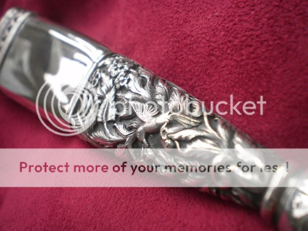

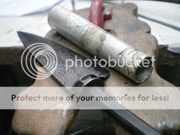

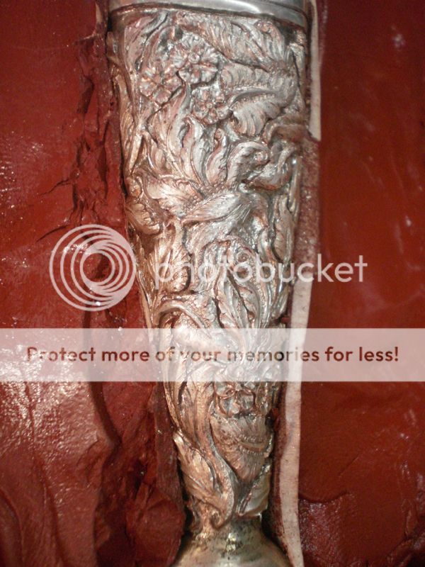

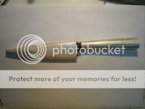

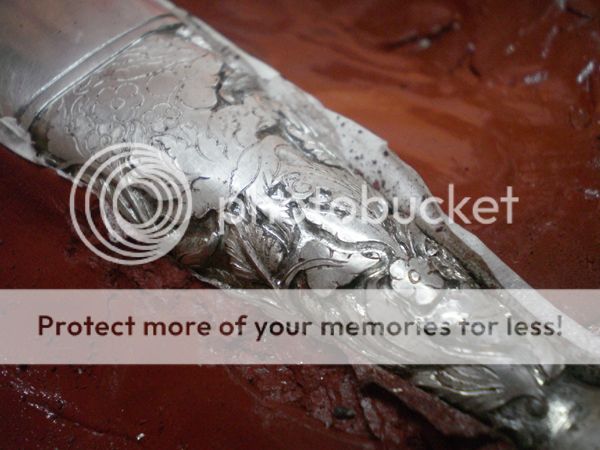

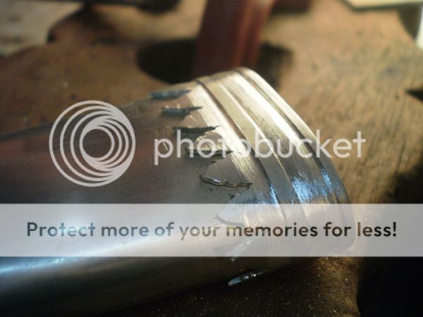

That is really beautiful! I do have a question, what stops the sheath from dulling the edge? Sorry, I don't know much about traditional metal sheaths. :o

9blades: As I explained in the first Luis's WIP, when the sheath is ready he puts inside two pieces of 0,8 or 0,5 mm brass or nickel silver bent in opposite directions, forming two arcs on each side, with the belly facing the side of the blade. They run the entire lenght of the sheath, they call this "ribs" and they keep the blade tight and centered in its place. The blade never touches the inside of the sheath.
