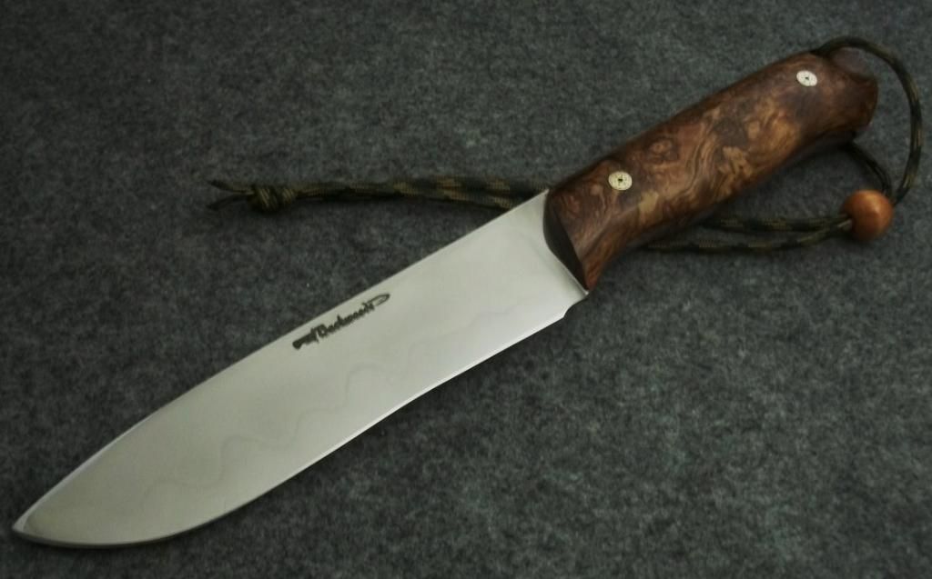

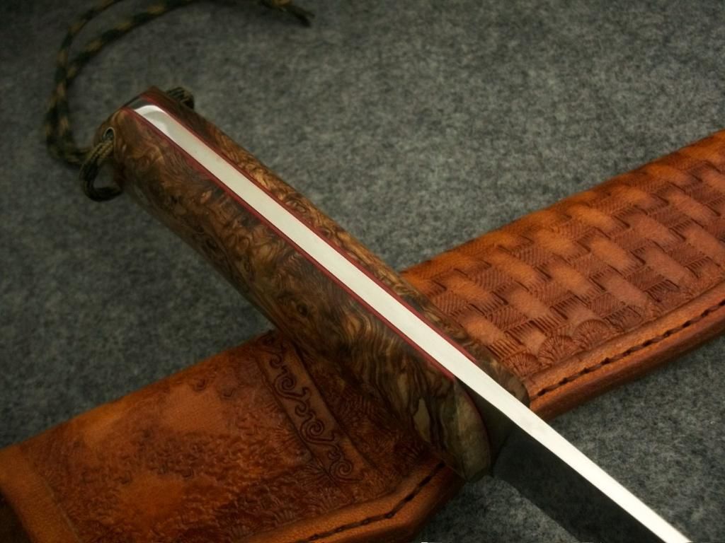

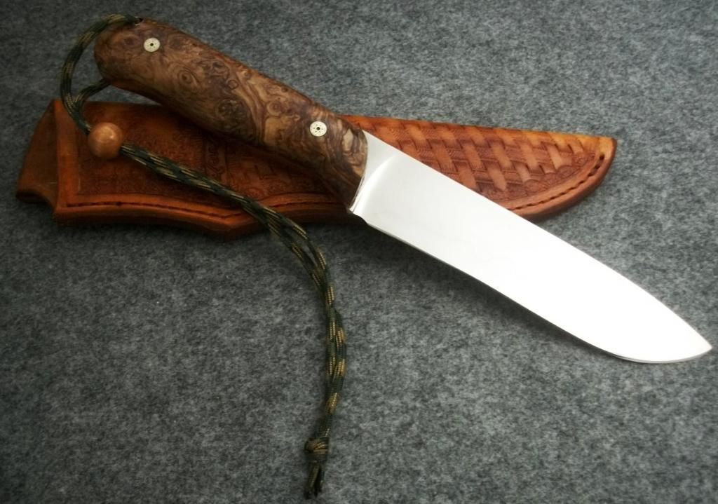

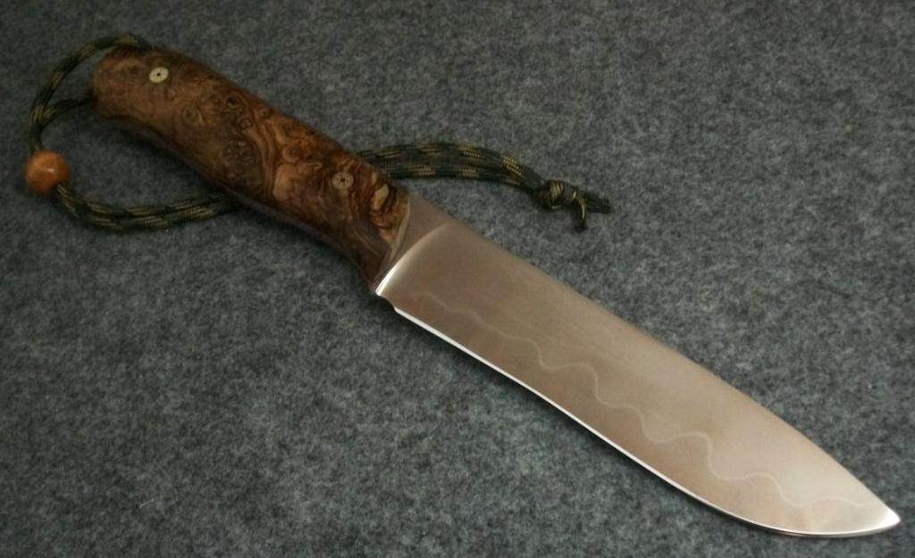

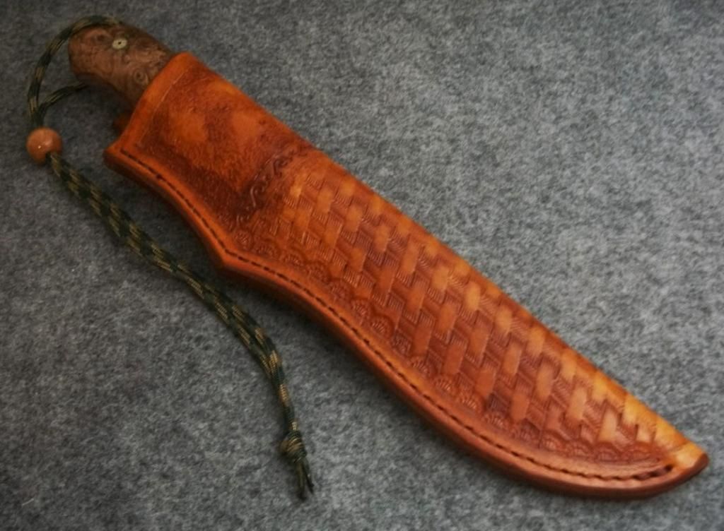

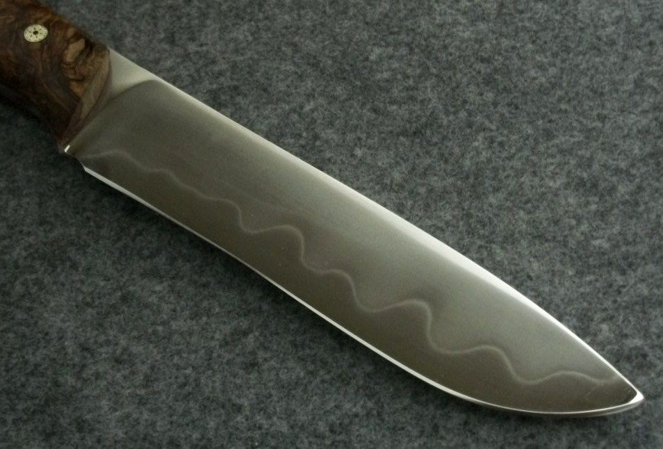

HERES A CUSTOM ORDER I JUST FINNISHED ITS A LARGE STYLE BUSHBUSTER!
SPECS:
ALDOS 5/32" /1095 /FULL FLAT GRIND WITH TAPER TO THE TIP,HAND RUBBED TO 1500 GRIT,WITH HAMON/KINDA WEIRD IT APPEARS TO HAVE A DBL HAMON IN HAND IT SHOWS ONE ABOVE THE WAVEY ONE IN A STRAIGHT LINE TOWARD THE POINT,MY FIRST EVER THAT CAME OUT THAT WAY.
AWSOME ROSEWOOD BURL
MOSAIC PINS/LANYARD TUBE/PARA LANYARD/W BEAD
RED TANG LINERS
TOOLED LEATHER SHEATH
RIGHT AT 11" OVERALL 6" BLADE,
