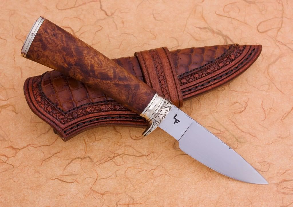

I got lots of great advice on the last picture I posted, so let's try this again. I'd love to hear any critiques and advice on this pic to help me improve.
It's a Larry Fuegen small hunter with Desert Ironwood handles, carved nickel silver fittings, and a forged 1084 (IIRC) blade...
Very nice Senator. A lot of improvement !! Are you using the Auto settings?
Greg
Thanks Greg. I'm almost always in Aperture Priority or manual mode depending on what I'm shooting.
I think the shot looks great:thumbup: I only wish mine looked that good.The knife is a real beauty !!
only comment I'd have is that crossing diagonals are disconcerting to the eye and mind so it is better to keep both more parallel to one another.
Thanks Murray. I'll give that a try and post the pic later today or tomorrow. What about the reflections on the edge of the butt cap and on the guard (to the left of the engraving in this pic?) I tried various angles and lighting positions and could never really eliminate them - only minimize them. Short of Photoshopping them out, is there anything I can do.
I don't get excited about that sort of thing as often you get a sense of roundness to the image with those reflections. At one time commercial photographers purposely put black reflections on cutlery. If you find then overly distracting then a bit of PS is fine. I don't know if Coop does some light blocking but I suspect he would cleanup in PS. I think also that if one is selling a service like Coop is, it demands a bit more than what most of us do which is just to present our knives in a nice way with good clean photos. You are doing very well.
I'm not sure what is causing the black along the spine of the blade but maybe something from your tent?
Filework on the spine? There is a lot of brown/red with the exception of the metal and the fine handle material and leatherwork doesn't want to stand out. Are you using a in camera white balance or custom ? Is the image pretty much the way it looks to your eye ?

Hi Kelly,
Been waiting and watching the thread before I pounced.... ;)
Let me preface by saying that anything I say here is based upon my own personal methods and views, and are completely subjective. I am no more an authority on your work than you are. But.... you asked. :thumbup:
Color balance and clarity is very good. The very first thing that reacted with me was that it was too much of a good thing. The background, although complimentary, just piles the orange tint on to sickening sweetness. I would have taken this shot, looked at it, and moved on to another.
This shot would have benefited with another pastel, probably a tan or a green. Just something not so very close in tint to the subjects.
Not my favorite pose (or Murray's) but that's not that detracting. Shooting the display side of a RH marked knife with a RH sheath always poses more difficulty than a LH mark on a RH sheath.
In this case both the sheath and the knife have the same upsweep. Generally the other combination of LH/RH displays offers an opposite sweep effect, which I find very visual. You can't change that here.
Although I wrote the tutorial on a light box, and it will help bring other's photos to clarity, I can immediately see the distinctions when a box-type studio is used, and I don't like the 'look'. Here's why:
This knife has so much light surrounding it, that it's a bit milky. I'll bet you brought up the contrast nicely to get it to this point. From a completely subjective feel of the image, I don't have a sense of the shapes and textures with the shadows. Lots of diffused lighting does this.
I see it very clear, but it's not moody. The handle, although obviously round, has no highlight refection to really show that wonderful shape.
My own setup has open sidewalls and an open frontspace, although I do surround the subject with mirrors. Some of this open space will be the dark reflections that would show the patterns in the shiny spacer and buttcap better. Because of the all-white surround of this box, I can't easily tell if there is a pattern there (I think so) or if it's just odd reflections. I would prioritize showing the patterns somehow.
Murray makes a good point. You might ADD some darkness into the background to see how that changes the reflections. You want to get away from the homogenous look. Dangle a strip of black paper across the back and experiment. You might go "Ahhhhhhhh......!"
And lastly the lighting is close to the same direction as the last shot you showed, which is directly overhead. Again, your call, but the lower you make your lighting angles the more you will show those textures and shapes more dramatically.
Too much information. No soup for YOU! :p
Coop
Greg - Yes, there's carving along the spine that falls over the edge onto the sides. I shoot in RAW so I can play around with the white balance afterwards, but this was originally shot with daylight WB to match the daylight temp bulbs I'm using.
Murray - Thanks for the tips. I see what you mean about the reflections and adding some sense of roundness. I'll try not to get too worked up. The only dark-colored item in the tent is the black lens body through the front flap, so that's got to be it.
Coop - Yup, I asked for it. Some of the best amatuer and pro knife photographers are on these forums and willing to spend some of their time giving me advice, so I'll be a fool not to take advantage of that. It's most appreciated.
Yes, there's a lot of info to digest, but that's OK. Give me a mission to tackle and I'll throw myself into it. I spent today learning what NOT to do with outdoor photography :o, so it'll be nice to tackle a task while learning what TO do. :D
