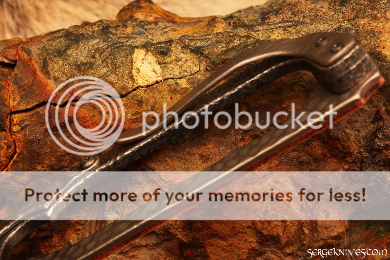

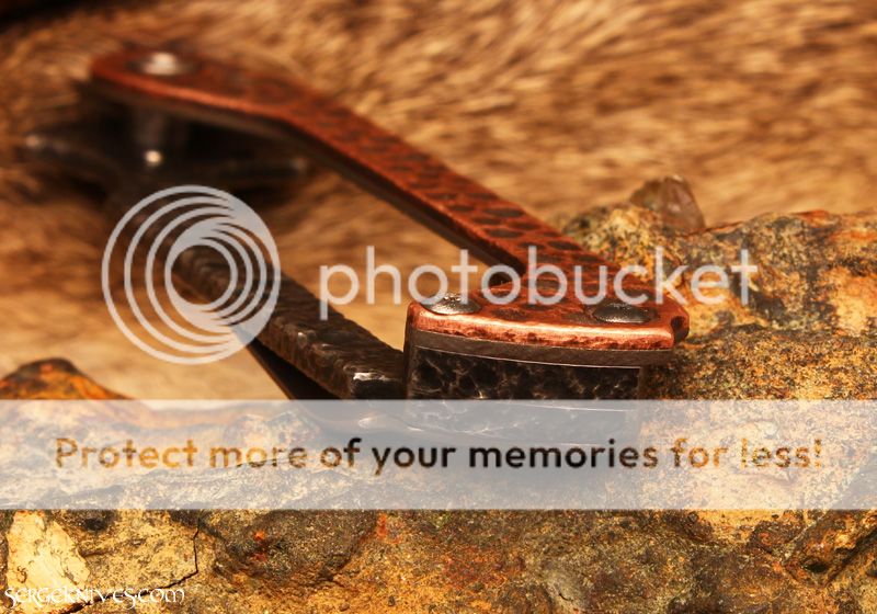

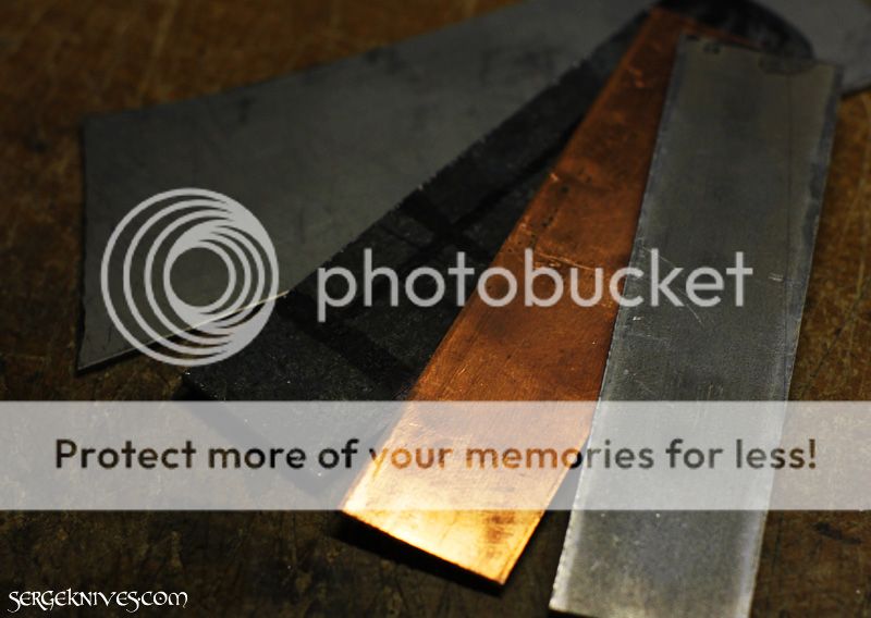

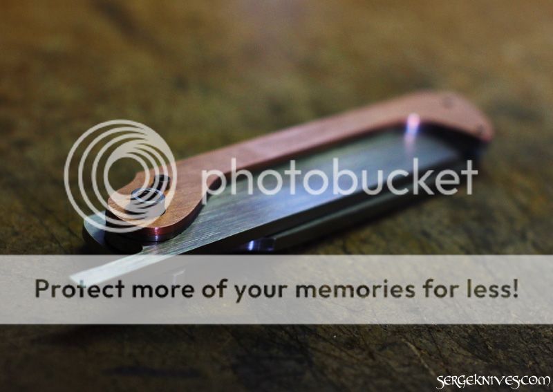

Hey everyone, working on another one for Blade. 1080 blade, will be clay tempered, copper, Ti and cable damasc handle.
More tomorrow.
Looking forward to seeing this one unfold Serge. Thanks for taking time to post these up!

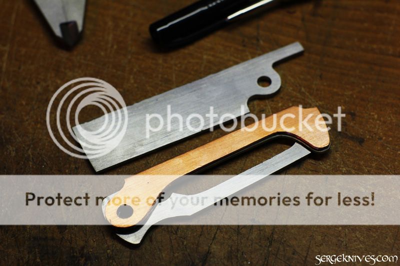

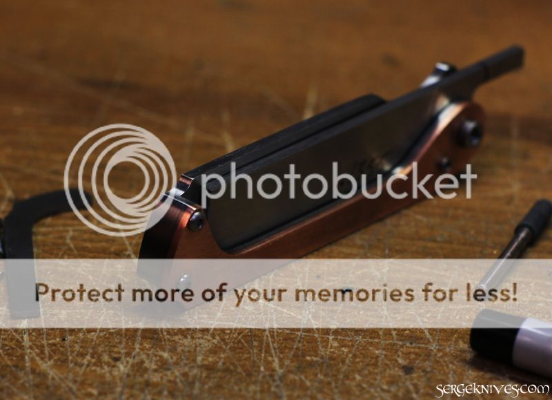

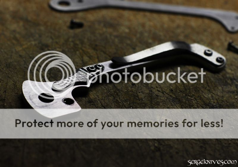

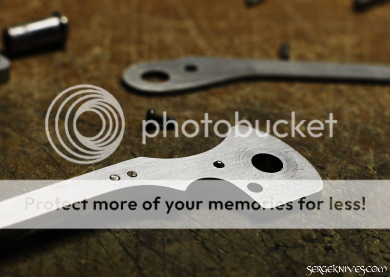

Thanks guys, here's more.
Added a steel backspacer.

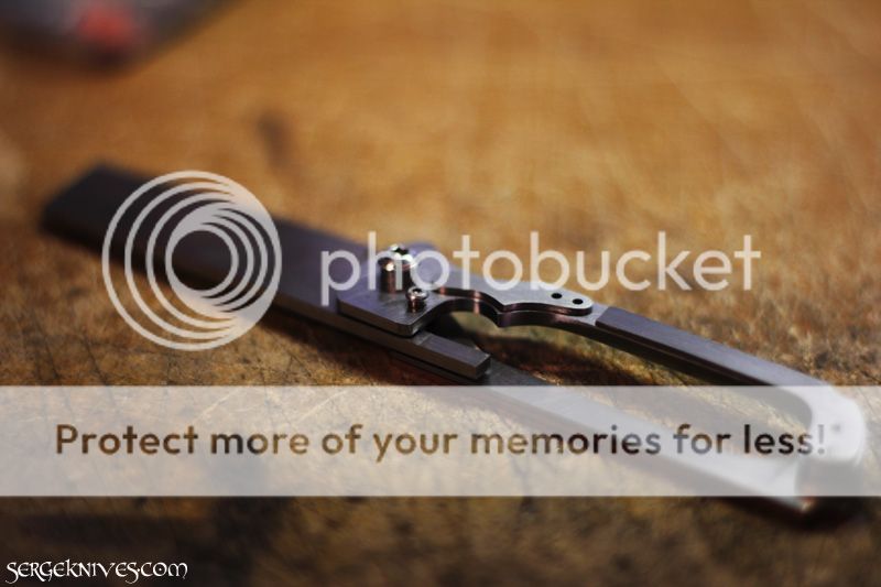

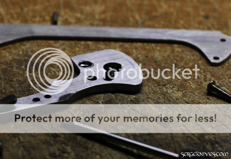

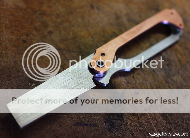

Ive decided to add several features to this one that I haven't done before, here is a "ball detente" type thing, the blade will be held closed allowing for clip carry.

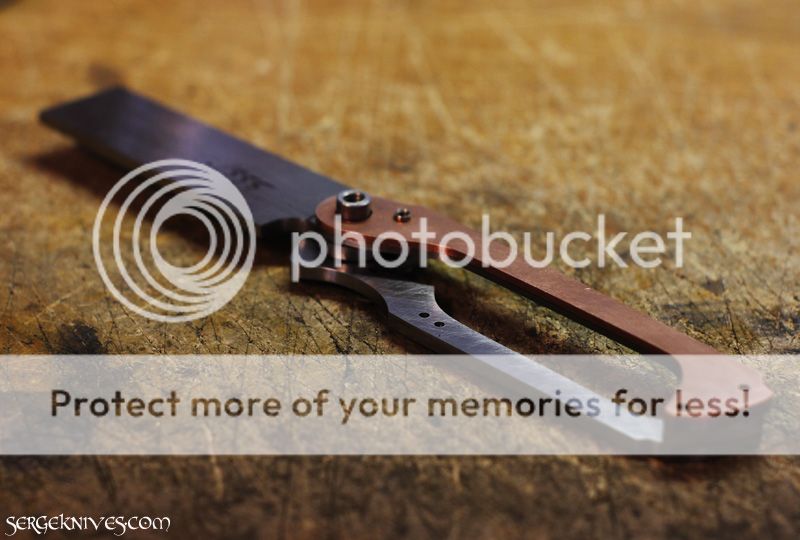

Here's the back, you can see the bar sticking out.
And here you see the Ti "spring" which applies force to the bar.

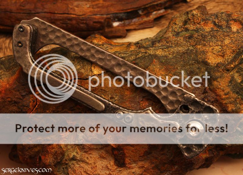

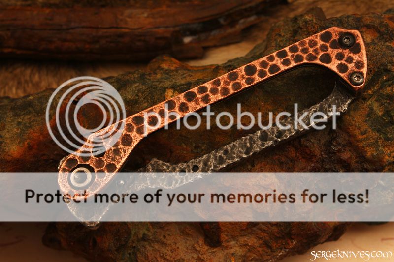

Wow, your ageing and patina technique is awesome.
This thing looks Old, with a capital O...
I like the detent ball idea. Will you drill another hole, so the blade is also held in open position?
