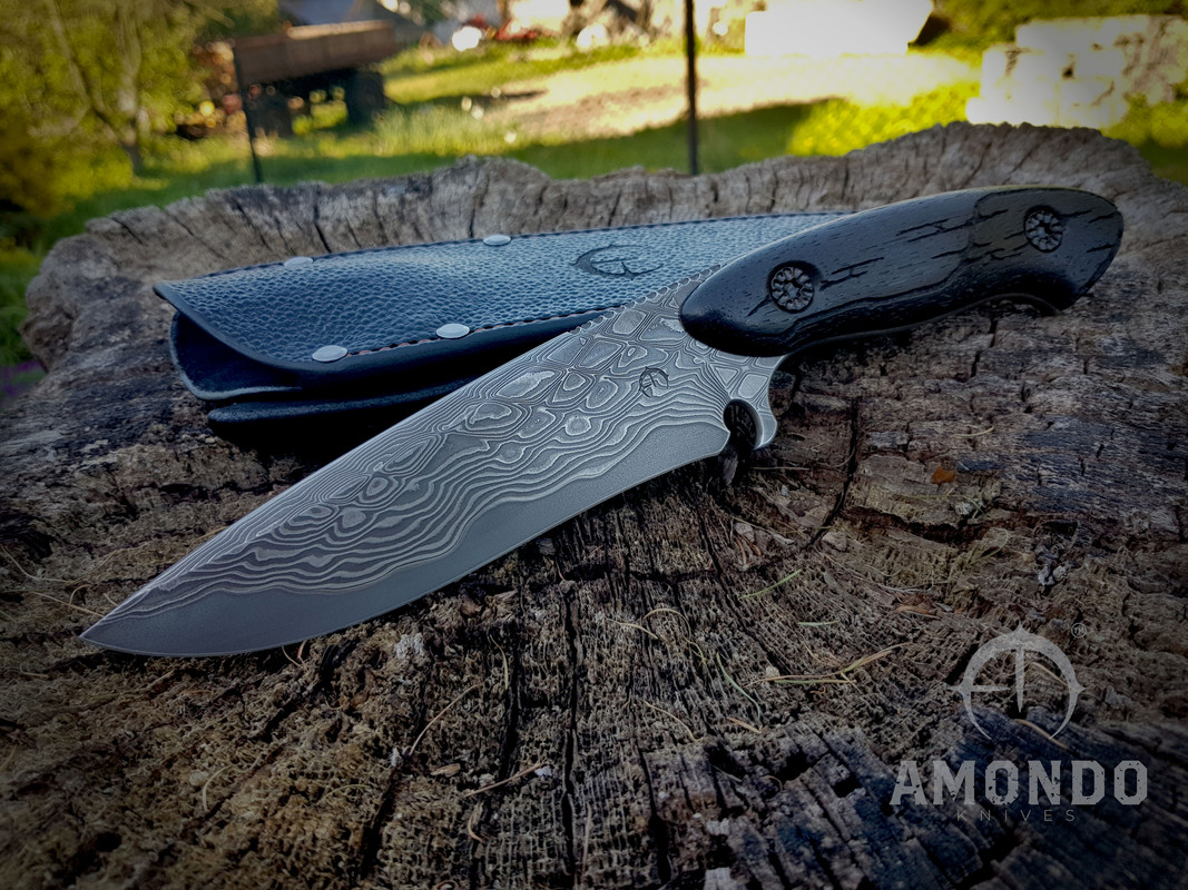

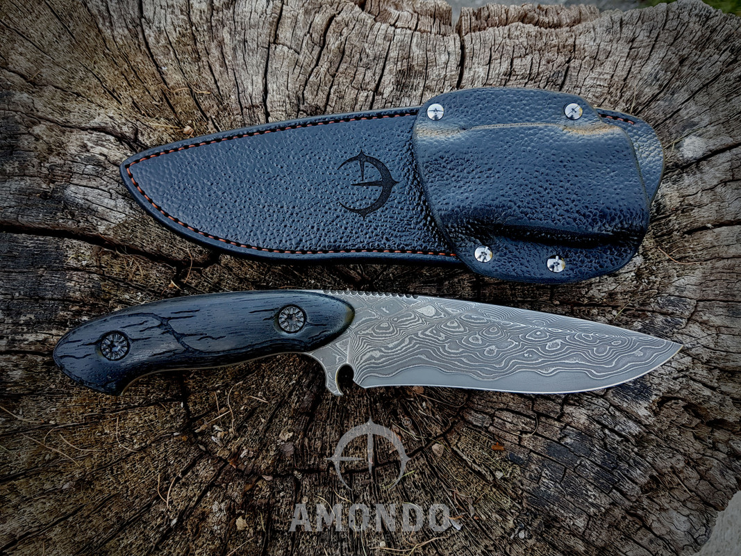

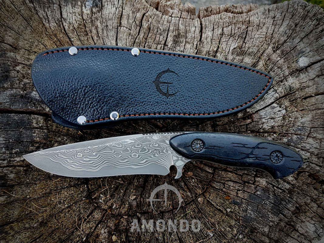

Hi everyone!
Another "Saltio", but much more premium.

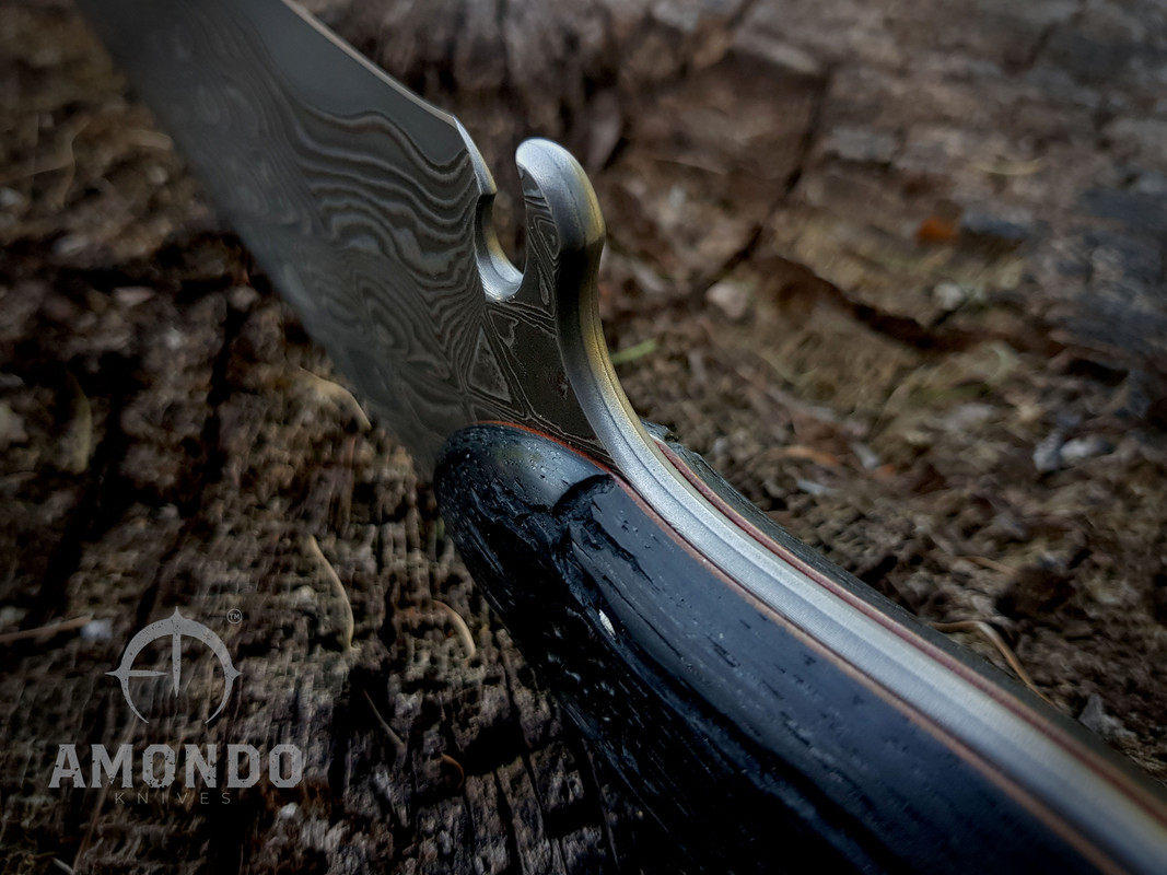

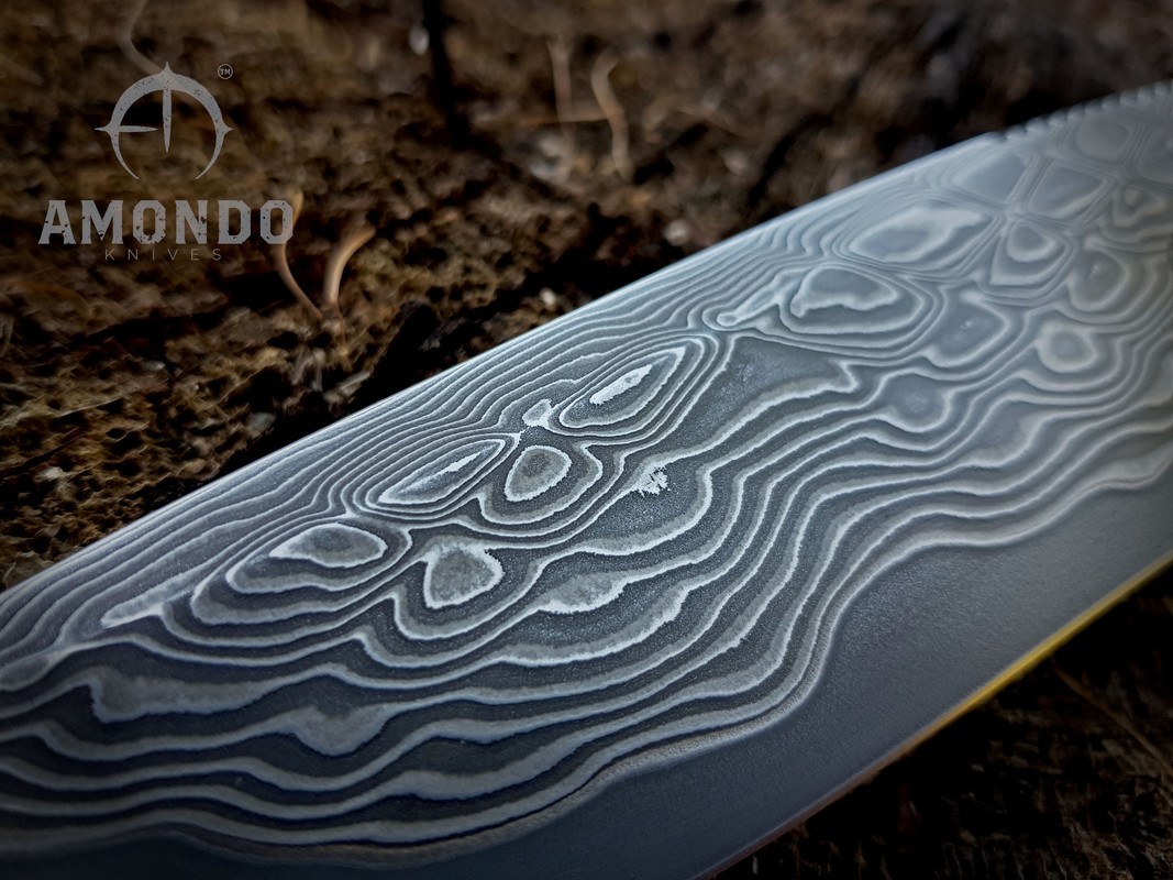

  • Steel - MagnaCut on the core, nickel and stainless steel laminate on the sides,
  • Thickness - 0,18" / 4,5mm,
  • Total length - 11" / 28cm,
  • Blade length - 5-1/2" / 14cm,

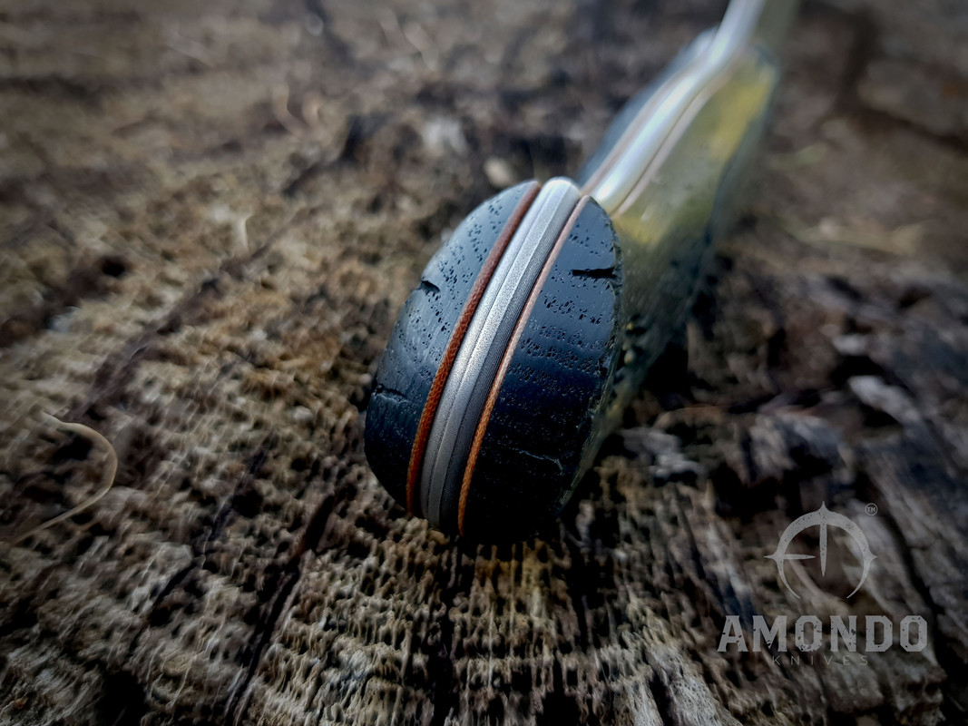

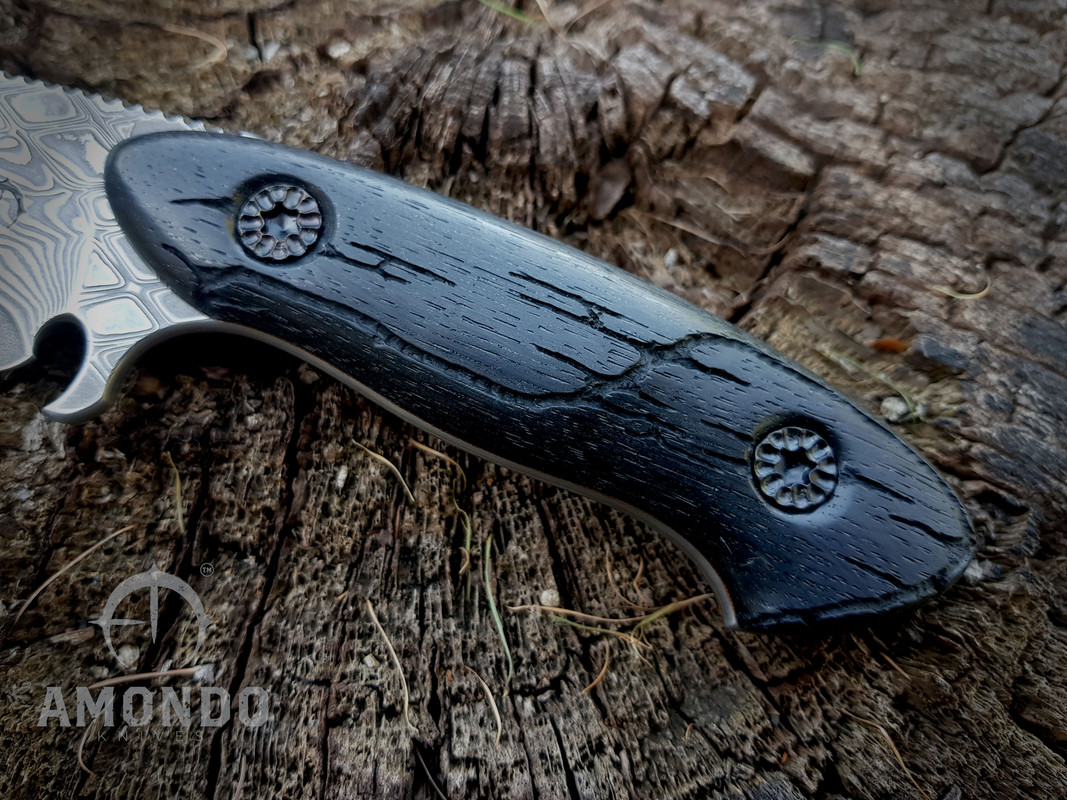

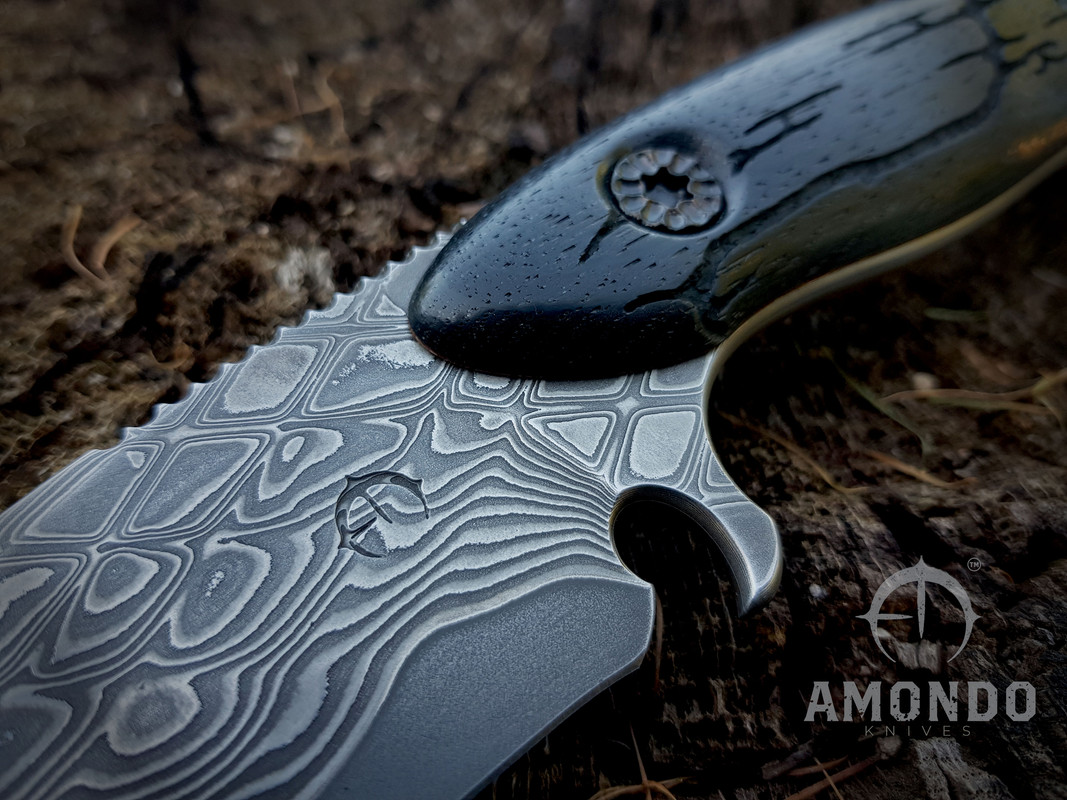

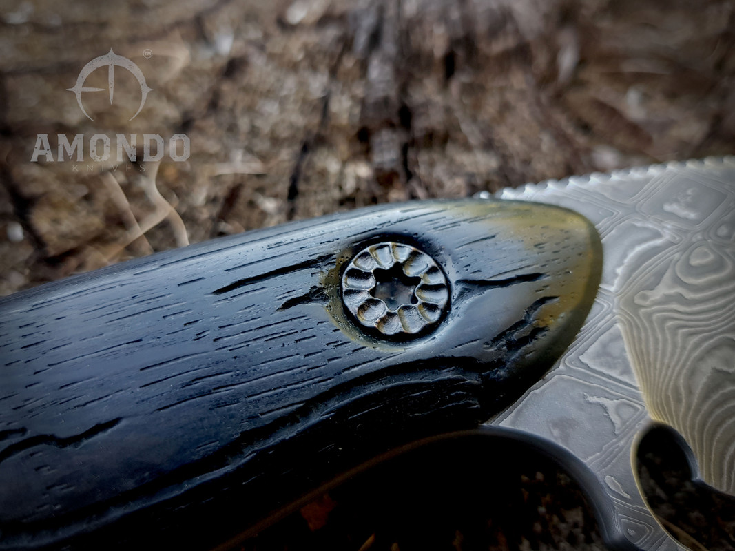

On the handle is stabilized bog oak and micarta liners. Everything is fastened with carved stainless steel screws. Blade is deeply etched and hot blued.

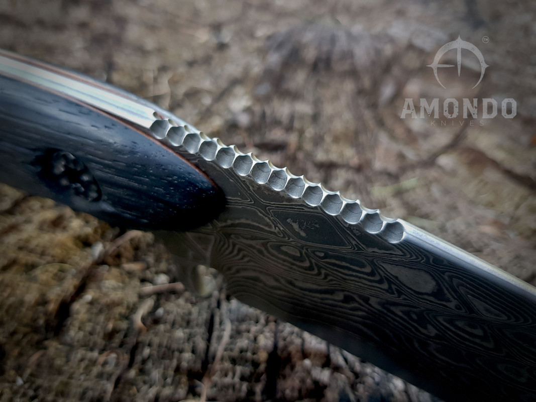

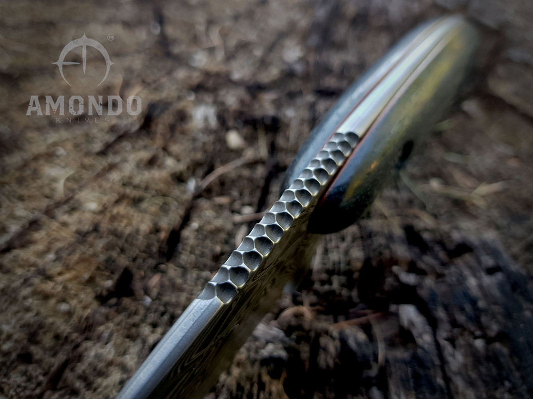

Scales have a small detail in the form of carved imitation of cracks. There is also carved jimping, and each edge on the whole knife is more or less rounded.
