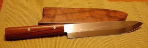

Hey guys this is one of two I am finishing up. Xmas presents for the inlaws, yeah cutting it close but got it done with a couple of days to spare.
Any how this one has a claro walnut sheath, the blade itself is 1095 clay quenched parks 50. The handle is natural pau ferro. Handle is about 4.5 inches, blade is about 7.5".
Sorry about the crummy pics still need to get a light box setup. Critique and suggestions always welcome. Thanks for looking.

Very very nice! If I may ask, what keeps the blade retained in the wooden sheath? I think that's an awesome touch.
Thanks for the compliments guys.
Grizzly usually on these guys there is a hole drilled behind the blade and a ebony dowel pin goes in there. I need to get some pins and or make some so I can do that on the next couple.
