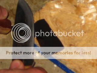

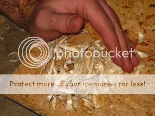

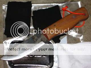

Ok Ken this is my GO!
Gear used
10-1-2011 072 by jclservices, on Flickr
10-1-2011 061 by jclservices, on Flickr
10-1-2011 062 by jclservices, on Flickr
10-1-2011 063 by jclservices, on Flickr
10-1-2011 064 by jclservices, on Flickr
10-1-2011 065 by jclservices, on Flickr
10-1-2011 066 by jclservices, on Flickr
10-1-2011 067 by jclservices, on Flickr
10-1-2011 068 by jclservices, on Flickr
10-1-2011 069 by jclservices, on Flickr
10-1-2011 071 by jclservices, on Flickr
10-1-2011 070 by jclservices, on Flickr
THANKS Ken!!
Perfect Jason!

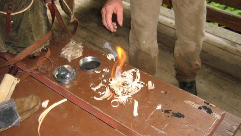

My video is now uploaded. Apologies in advance for the homoerotic music - youtube kept scrubbing my audio when using copyrighted music.
[youtube]0MhLKlc-Xdk[/youtube]
Here's my buddy Joe who did another flint & steel video that same day!
[youtube]3YVUmeR7qpA&feature=feedu[/youtube]

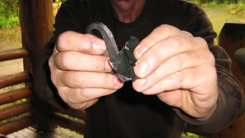

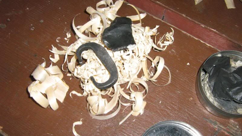

Very cool, and the music wasn't that bad. What knife is Joe using in the second video to get his spark?
He was using a mora clipper to ember up the charcloth. Since Joe has discovered custom knives, he's less and less inclined to score up the spine of his customs :) The knife he was using for his wood prep was an Iz Turley Green River.

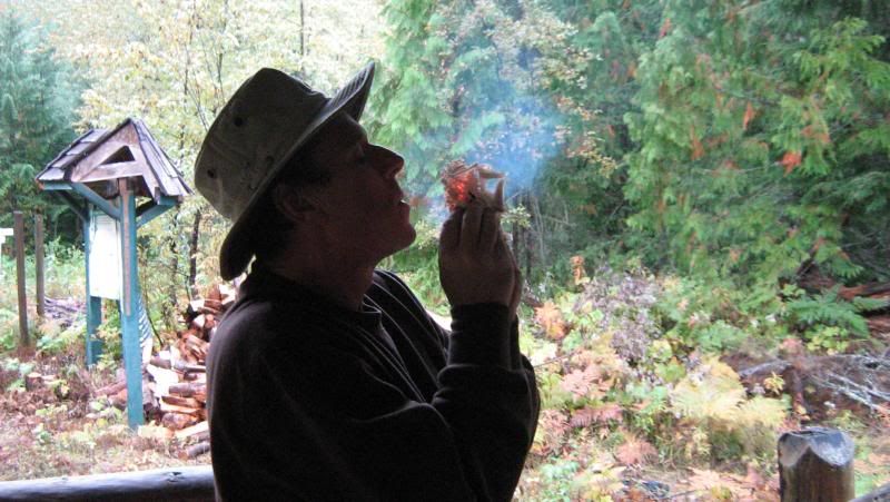

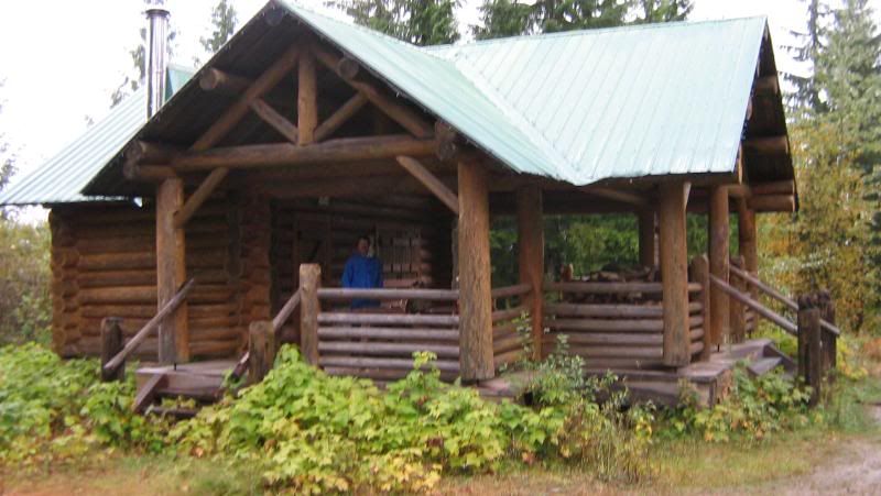

Today in the pouring rain a friend and I headed out to walk a loop that I do.This areas is where the local crosscountry ski club has many trails and a small cabin.There are also hundreds on KMs of mountain bike trails.Nice walking area as you are usually alone on the trails
I decided to try this challenge after reading the posts and watching the vids (nice work by the way)
The cabin

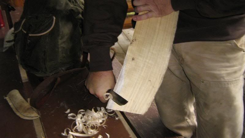

A piece of firewood
I shaved enough for a bundle
Then a spark on the charcloth
Blowing it all to life
Success
Like most fire making techniques proper preparation and a plan will bring you a fire

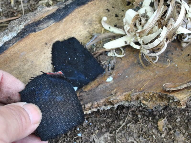

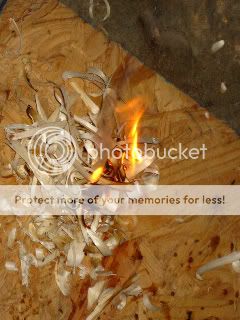

I gave this a shot last night, I had never made char cloth before, but I had an empty altoids tin and an old white tshirt so I fired up the gas grill. The first batch went well and when it stopped smoking all the cloth was black, the second batch, the top layer was brown and didn't keep a spark like the black cloth. Anyway, here are some pics:
Excellent Keyser, sounds like your second batch needed a bit more time. It could be that it was lifted off the tin and insulated to some extent from the air. When I make a large batch, I usually fill up a big candy tin with half a hand towel. I fill the tin right up and when I'm done on the BBQ, I add brickettes to the sides and top and just let it sit there overnight or until the coals are ashed. Usually works, but sometimes there is a few pieces in the center that are just brown in the middle and charred at the sides.
Thanks for the tip. I did put it back on and let it set for several more minutes and it wouldn't smoke at all so I just took it off. I was excited enough one batch turned out, ha.

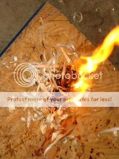

Not a full set of pics...I learned I can either blow it in to flames or show pics of the char embering....

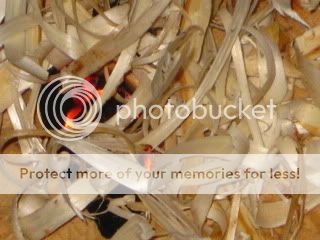

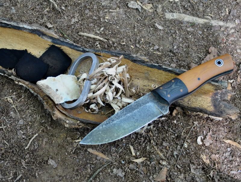

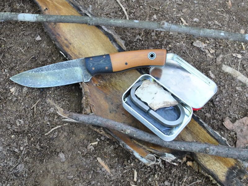

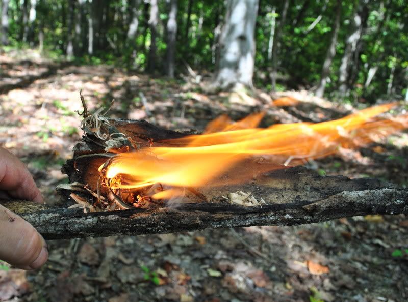

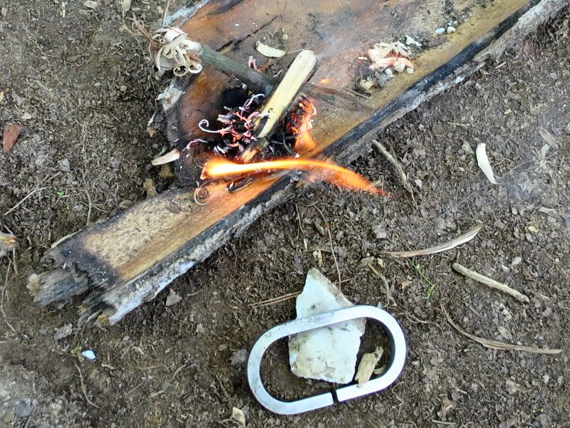

When employing charcloth, I typically use a jute and wood shavings bundle wrapped around the embering cloth. I've never tried using charcloth only to bring shavings to ignition, so I looked forward to giving this a go. I have wrapped a damp paper towel (just wiped my hands with it) around an embering charcloth in the past and have brought it to flame, so I've always been impressed with how well charcloth can ignite things. With that experience, I was pretty confident going in to this practice.
I left the charcloth in the dish for this challenge so I could keep it all in the shot; normally I wrap it up in a bundle and hold it up above my face to blow on it. Since I was leaving it in the dish, I figured I'd try a charcloth taco/wind-canyon...worked well enough :)
