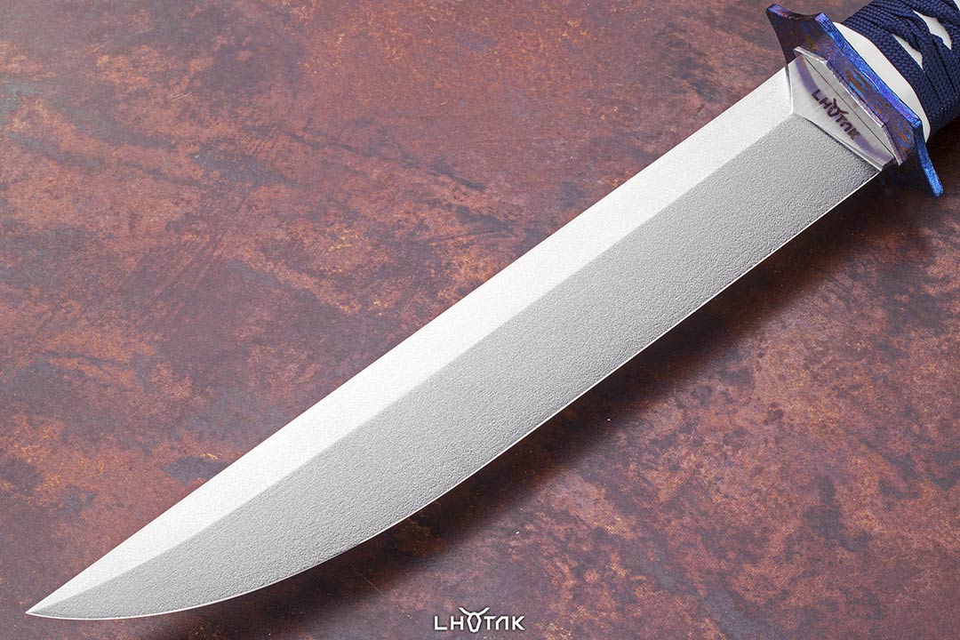

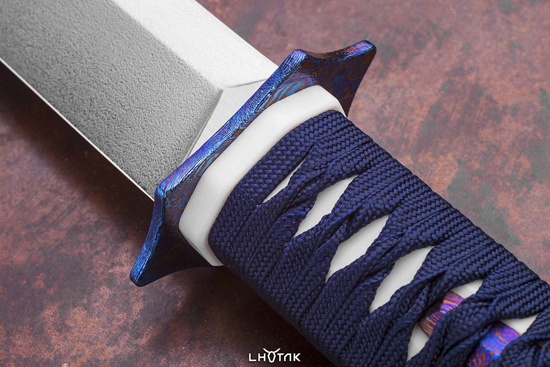

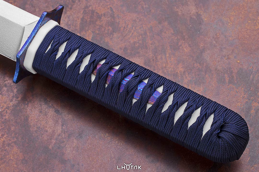

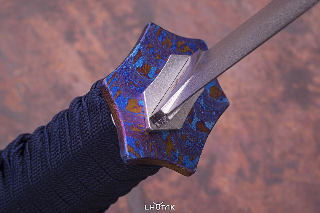

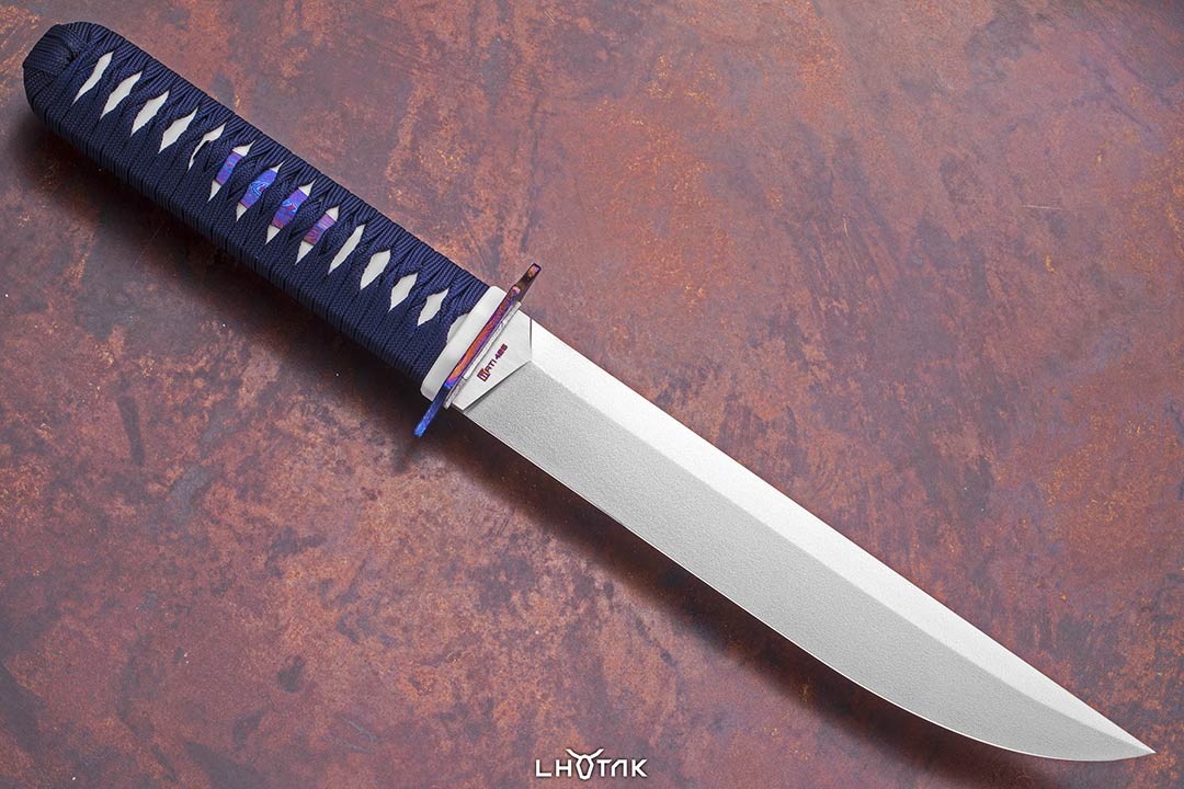

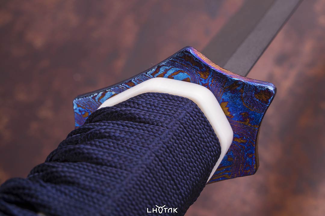

Hello,
finished my second "Tanto". This one can be taken down for Maintainance/Repair, although not in the traditional cool way. Wrap has to be removed, but other then that it's almost the same construction then the real deal.
Knife itself, OAL 12", Blade 7" at .118" thickness. Weight 4.76 oz. Heat treated ATI425 (HT by @Mecha). Tsuba and the simple Menuki is Herringbone Timascus and some 6AL4V, all given some texture resulting in a cool look. Handle is Elforyn Super Tusk and Midnight blue wrap.
