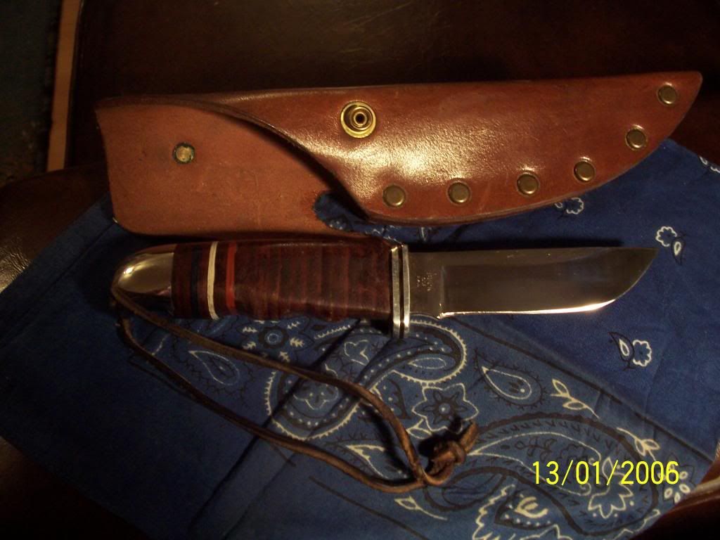

Has anyone successfully added a lanyard to their Vanguard?
I really hate to mess up the knife by drilling into the butt of the handle or trying to rig something that looks just plain awful but a lanyard does tend to come in handy when working with a knife around water.

First, it can be done. It requires a handle redo. Remove the rear pin and pommel and add a longer pommel. One that would accomodate a lanyard hole. Then shape the new pommel to fit. Here's what I'm talking about. This one I did on a Buck 103. DM

Souther, there is one with a lanyard hole. A simply drilled hole. I don't know how difficult the drilling is. I think somebody tried it out.

Haebbie, I don't know who drilled that hole to allow for a lanyard but it looks like they just about drilled thru the pin. Which with some tapping could allow the pommel to dislodge off the handle. May not happen but its close. The better location is low on the pommel so as to hit nothing. DM
A hole would be the simplest solution. Dave made an excellent call on knowing how the knife was built, to reduce risk of damage. I don't see any other way that doesn't involve major surgery.
