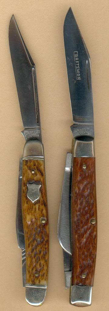

Today's mission, should you choose to accept it, is to pin down the manufacturer of this one! I bought it thinking Schrade, but now I'm not sure. So I'm appealing to you more experienced folks out there, to give me some clues, or an outright answer, as to the manufacturer. This message will NOT self destruct (hopefully)! Thanks all!

Sure looks like a Schrade to me but...
the bolsters and the pattern on the handles are a little different looking..
Any number on the back of the tang on the main blade?
I checked my Craftsman knives,all 8 are Schrades,and I don't have any that say Made in USA or have the underlined Craftsman etch.Arnold
Hard to tell. The logo is early, like 1950 or before. During the late fifties thru early seventies, Schrade supplied Ulsters and Schrade Waldens to Sears every year, with a Providence knife tossed in here or there. Then they discontinued the Ulsters and mixed in Camillus knives. As Wal-Mart became a bigger and bigger customer, they supplied mostly Camillus knives to Sears.
Circa 1930-50
Circa 1948-50
CIrca 1960
Codger
To me, it looks like a late 40's thru 50's Ulster made knife. The Roger's bone handles are distinctively Ulster, not Schrade. The tooling also looks like Ulster. The equivalent Schrade pattern would be an 881, but the tooling is differentl on that one - the master blade on an 881 eould have long pull.
That's about the time the Baers took Ulster over and consolidated it with Schrade Cutlery to form Schrade Walden, which was a division of Imperial Knife(do I have that right?).

The sears SFO's are an odd lot, and, as if you didn't already know, hard to exactly pin down. Unless a pattern is entirely unique such as with some of the fixed blades, and even then.... well... here is an example:

The numbers are a real hodge-podge. The only good way to know for positive and for sure on a lot of them, is to hold both the base knife and the SFO in your hand and make a close examination.
Thanks for all the contributions so far, everyone!!! I'm working on the other end, trying to track it back through "jerdan" on Ebay, to see if we can learn something from the route the knife has traveled to get here.
I've compared it to a couple of 881's I have, and a lot of details are subtley different. I wish I owned a few Ulsters and Camilluses to compare.
When I get a few minutes in a row, I'll take another pic or two with the Schrade 881's.
Ain't we got fun?!?!?!:D
In my relentless bugging of everyone I know, it's come up that maybe Camillus is the maker. It turns out, Camillus had used similar Rogers bone some years ago. I found I had this Camillus stockman tucked away, and here is a comparison with the subject mystery knife!
The bone jigging looks to be made on the same machine, under magnification. The underlying color is the same amber color. My artist/teacher wife tells me the same reddish tone overlays the amber on each, the Camillus is mostly polished off, although it may have been darker to start, it has the same "value" or something.
Elementary, Watson!
