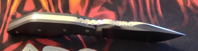

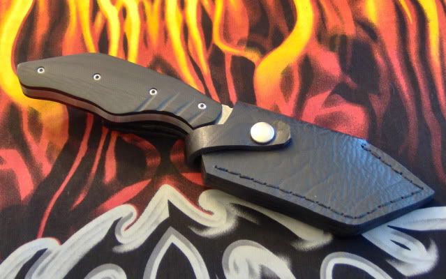

Here's my latest Antagonist blade design. It features a 1 1/2" wide recurved
drop point blade with a very deep hollow grind and false edge. This one feels very nice in the hand despite being on the heavy side!
  • 4 1/4" blade, 9 1/8" overall
  • 1 1/2" wide (max.); 1/4" thick full tang build
  • 154CM blade steel; Paul Bos heat treat @ 58-60 rc
  • Black G-10 scales
  • Black leather belt carry sheath- right hand
[/LIST]
There's also more pics on my site.
Thanks for looking!
Does have a rather implacable quality to it, doesn't it? Very cool! :thumbup:
