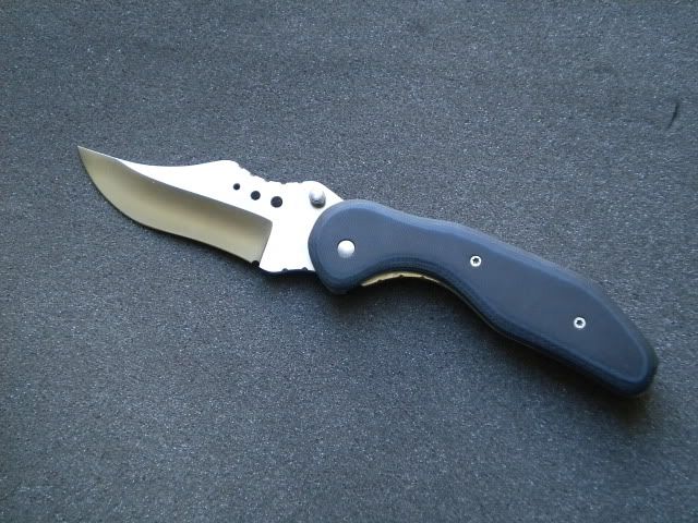

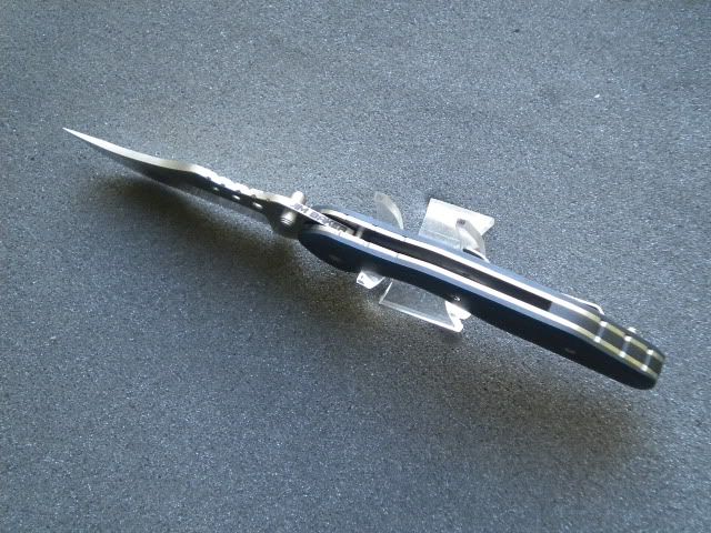

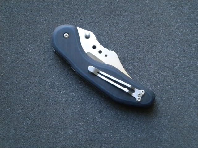

Finally got this one finished for a customer- I've carried the prototype myself for about 2 years now. This newer version has an area behind the cutting edge for "choking up" on the knife for detail work. This knife was built with standoffs, with a back spacer fitted around them. The back spacer can be removed for an open build.
4" blade; 9" overall
.125" thick 154CM blade; HT by Paul Bos @ 59-61rc
Black and blue G-10 scales over titanium liners
black G-10 back spacer
Thanks for looking!
